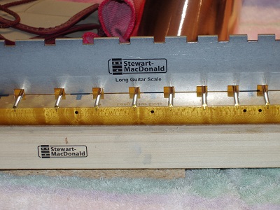

    It's very hard to tell what's going on in any of those pictures because 1 - the strings are obscuring the ruler and 2 - you can only see a small section of the fretboard.
    How long in your straight edge? You need one long enough to run along the entire length of the fretboard, that way you can eyeball whether there is any gaps between the ruler and the frets and determining what sort of bend you have in the neck.
    An even better way is to use a notched straight edge, which will sit directly on the fingerboard and give you an even more accurate reading.
