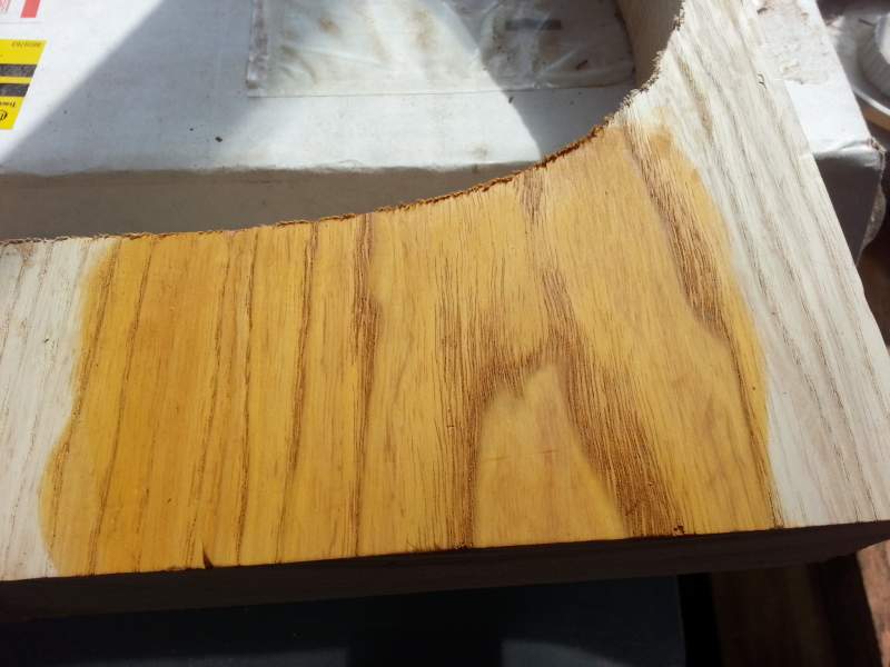

    Plans sound cool Pest. I Was at the DB man Cave this arvo and saw the body Blank the body was cut from with some DT yellow looks great on that grain

    The new formula Butterscotch.... Soon to be released...

    Yeah Woks the grain in this ash is awesome, looks even better with the new butterscotch formula! I can hear and feel DB's excitement from here, I'm taking finesse to the next level now!

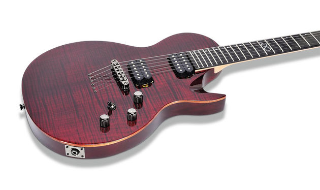

    by a hand cut I think he means like the cutaway on the bottom horn of a Chapman or similar
    Like on this so you can get to the high notes easier:
