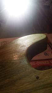

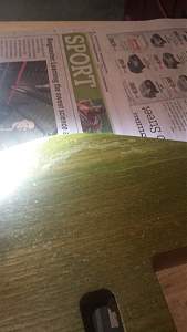

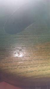

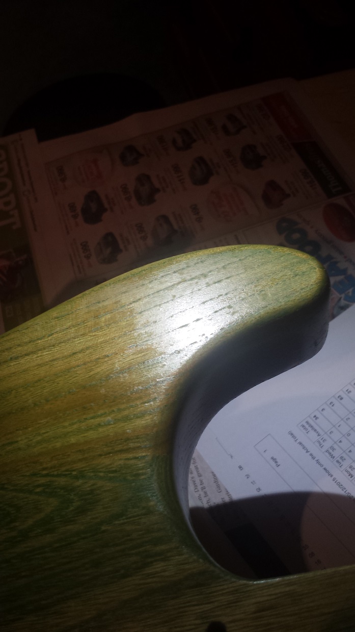

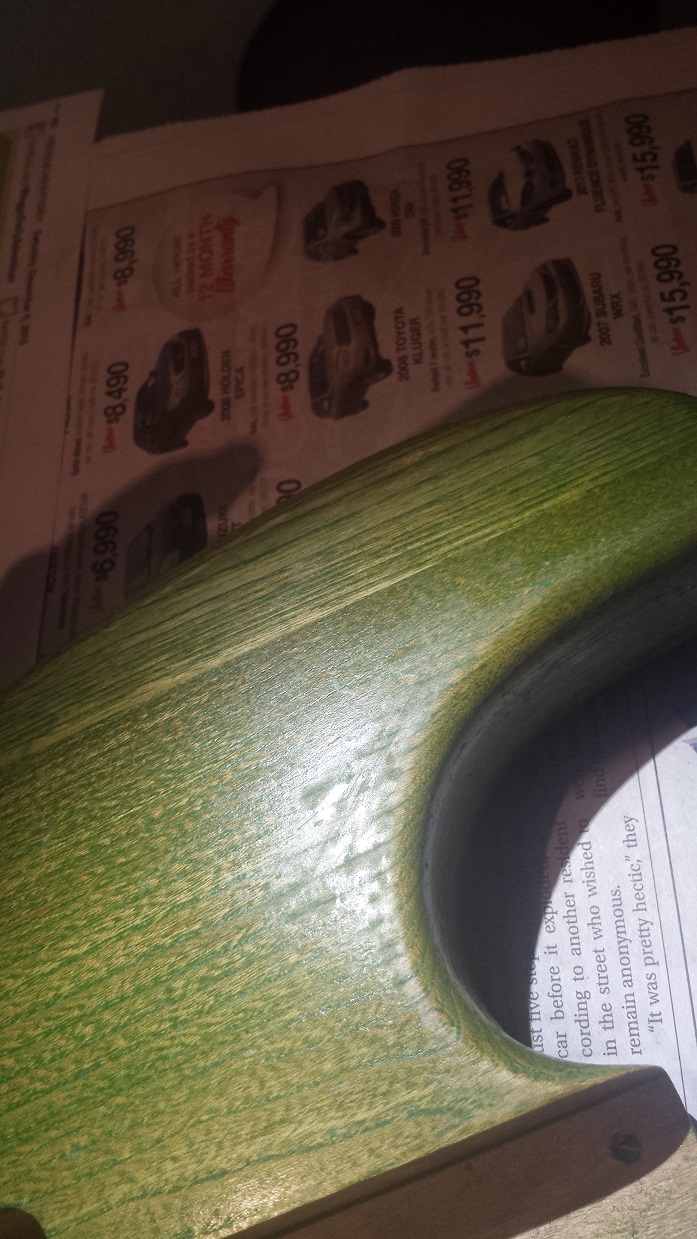

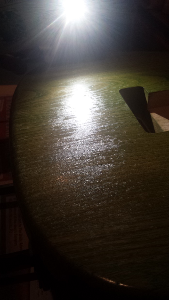

    Alright here's some new photos. I'm guessing the specs here and there are from dust and whatnot

  3. #43
    It's also been 3 days since last adding an intensifying coat in attempt to smooth everything out
  4. #44
    Hi Mr Foster, give it a light rub of super fine steel wool and apply another coat
  5. #45
    Rightyo, I'll keep you guys updated
  6. #46
    Yep agree Woks suggestion should help things along.

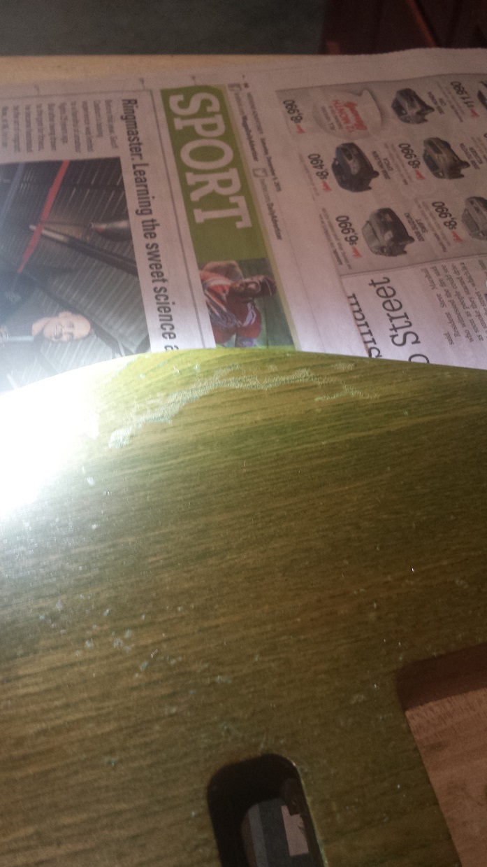

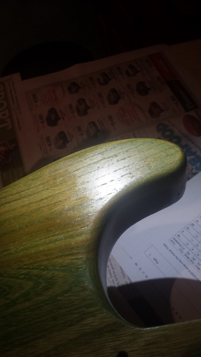

  7. #47

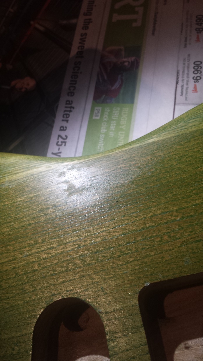

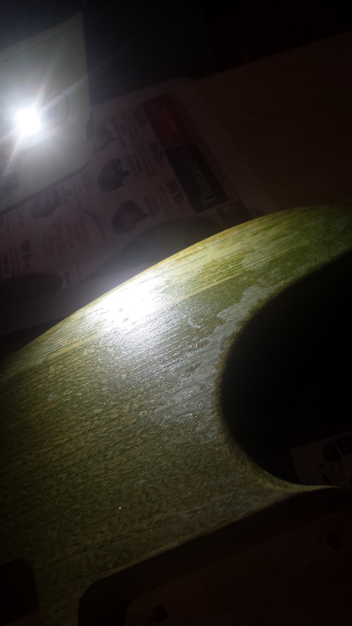

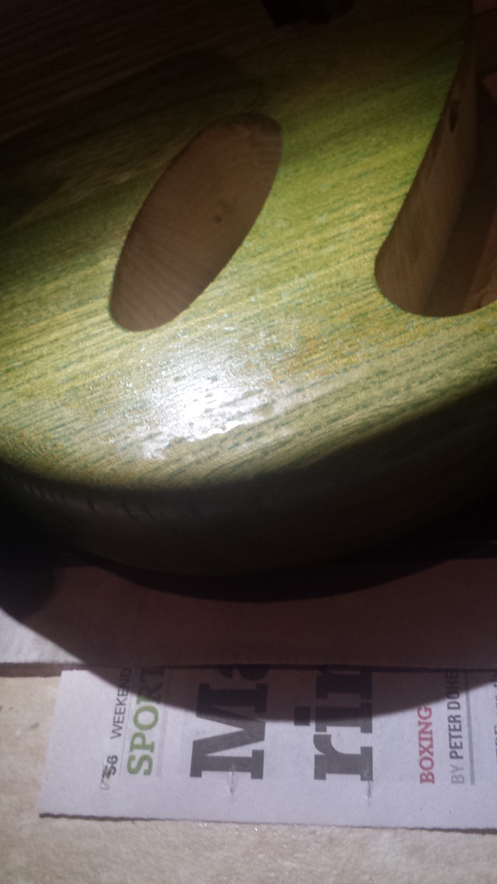

    Alright here we are
    Looks like I have the same problem areas just less of a problem, I did a little more with the steel wool this time around. What do you guys think I should do?
    Here you can see the perimeter where it lacks the sheen from the last coat
    Still have these spots around, when I applied this coat it seems to reject what I put on there, this is why I think I need to give it a good rub down with the steel wool
    Man I must have messed up big time somewhere to end up with this. More experience I guess!
  8. #48
    I definitely feel your pain. I've even considered sanding the top coat off and nitro-ing instead. But I'm also wondering whether it actually has to do with not getting and even grain fill, which isn't effecting the stain stages but is leading to the top coat sinking into the wood adhereing to the surface differently. DB probably never has this problem because he has the experience and patience to always have his wood prepared perfectly, so he has probably never come across this problem himself.
  9. #49
    That's what it's looking like fretworn. I'm thinking of just getting rid of those high spots with steel wool and giving it one last coat before going to the top coat. Probably right about DB too, he knows the stuff better than anyone!
  10. #50
    So now that Christmas is out of the way let's get back on to this!
    From what I can tell I should just keep going with what I was doing?
