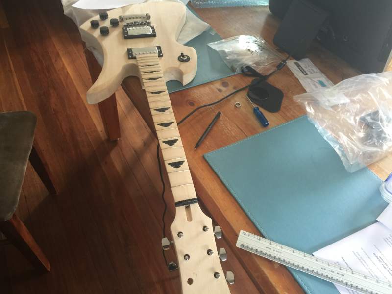

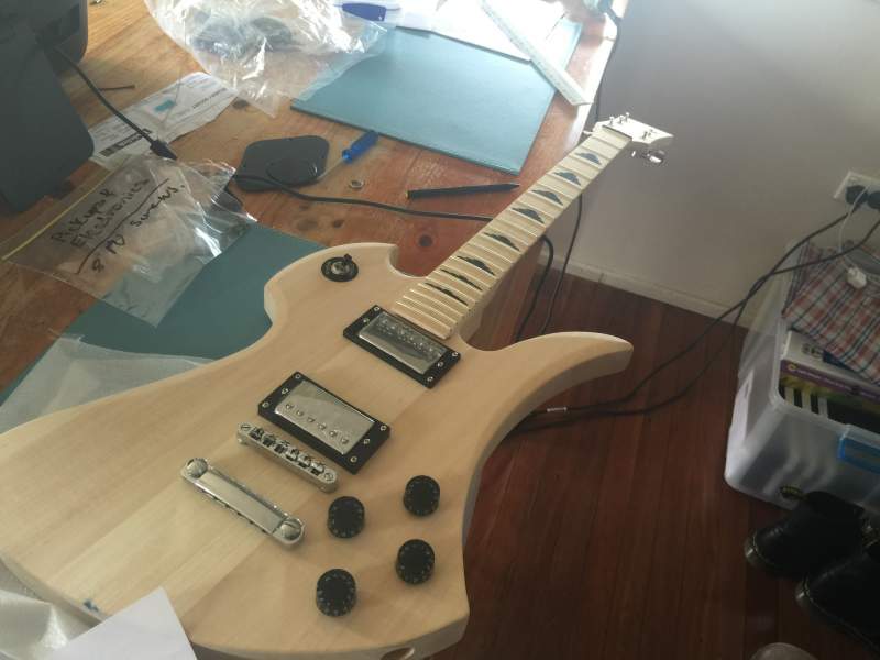

    update:
    put tgether a dry fit this morning to make sure of all parts. used to TOM bridge in the photos to make it look nice, apart from that i wont have any real use for it.

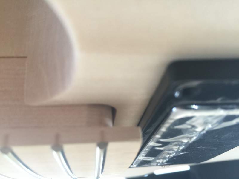

    i did find that the neck didnt quite sit into the neck pocket properly and therefore left a small gap. im going to be plying around with the neck alot anyway because of the floyd rose going in, so this isnt a huge problem.

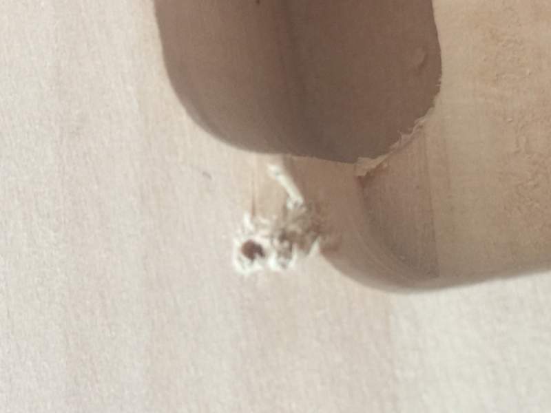

    apart from that i found a screw decided to bgin splitting the wood near the puckup cavity, even after i had predrilled. nothing a bit of wood putty wont fix up

    I wouldn't use putty to fill that hole, use toothpicks and glue. The putty will crumble when you try and put the screw back in.

    Cheers for the tip pabs! Really glad you told me that!
