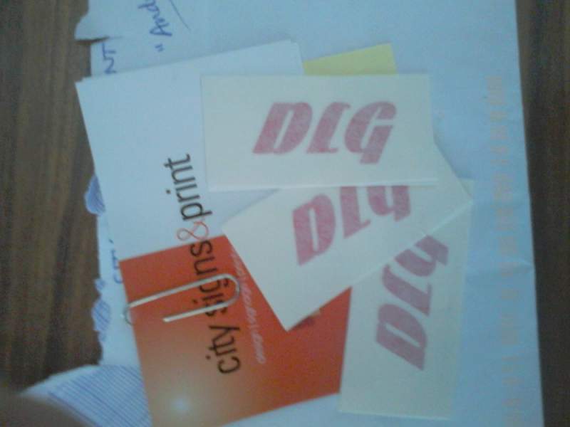

    Also a massive shout out to Andyport for his primo vinyl decals which turned up yesterday. I've had a gut full of mucking round trying to find decent waterslides and waiting weeks for delivery from the UK so I'm trying a new method. Unfortunately vinyl decals and nitrocellulose don't play nice together so I'll be using Andy's decal as a stencil. The plan is to shoot the headstock in white first (the logo colour), then plonk the decal down, then lay down my black, peel off the decal to hopefully reveal a nice sharp white logo, then I'll just shoot some nitro clear over top, job done....hopefully.

    A good tip when masking a design like that - lay your base colour (white) as you described, attach your masking (decal in your case) then spray another coat of the logo colour (white) before laying down your background colour (black). The coat of logo colour after masking, in my experience, takes care of any bleed under the edges of the masking and seals it up so the other colour doesn't bleed and you get nice crisp edges. Not done this with decals, but don't see why it would be any different.

    Nice tip man, will definitely try that, cheers!
