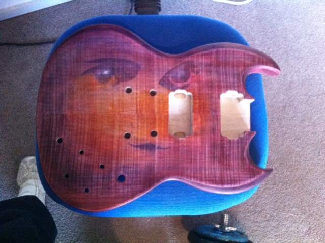

    Hi Guys,
    I have tried out some blending methods
    Tried blending the black and ochre at the same time - which sort of worked but the black tended to dominate
    I will try and sand these back to see if it lightens everything up
    I laid down the colors very lightly on another template to see if I can blend them by sanding and then build up the color in layers?
    And I laid down just a solid black to see how much sanding is needed to get it back to a lighter shade.
    Not real happy with any of the results yet but might come good with sanding - I don't want to have to sand too much on the cap because I have already accidentally sanded it and the cap is so thin....
    Any suggestions will be greatly appreciated
    Thanks,
    Alan

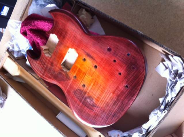

    Hi Guys - haven't touched base for a while - I have just been concentrating on trying to get the best result staining my guitar.
    The second picture is where I am now - the outback sunset and nullabhor ochre were too yellow and red to begin with
    I put eyes on it! - not sure that is accepted practice but I am a bit of an "artist" at heart and couldn't help it.
    My daughter painted a series of paintings of Kurt Cobain and I took the eyes of this painting
    I am up to the enhancer staining stage - just wondering if you put the different stains over the area of the color that you used.
    I ended up having to blend some colors by adding different stains over the top of different colors, sanding back and at times I actually mixed the stains together so it is a bit of a mishmash of colors now.
    Any suggestions would be appreciated - haven't done the back or neck yet.
    Thanks,
    Alan

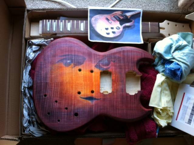

    Hi Guys just another update - all intensifying coats done and just applied the finishing coat on the cap and neck
    Looking at finishing off the back and headstock this week then heading into soldering the electrics
    I noticed that the neck is bent away at the top end (put a level on the frets and progressive gaps at top end
    I am going to try and adjust the screw in the headstock to straighten it - hopefully that will help level it up?
    Getting there one way or the other ha!

    Hey Alan,
    thats an original cool idea with the eyes and mouth, the cap is looking good with clear coats. Good luck with the rest of the build clearing the back and neck.
    Don't touch the truss rod yet, wait till you have string tension on the neck and it may straighten up.
    Let us know when you are ready to glue the neck, that is an important stage of the build !
