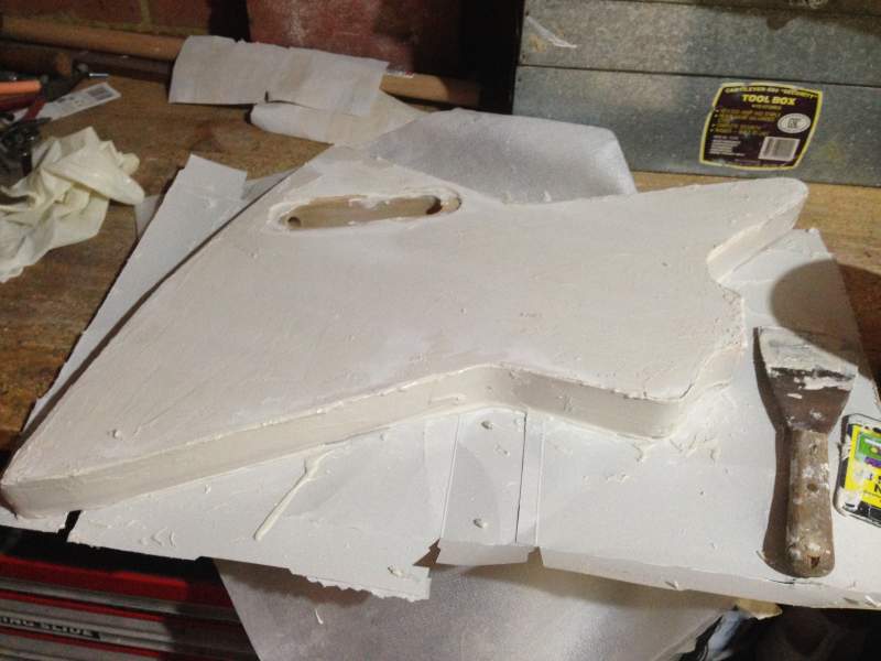

  6. #46
    Timbermate is on the back and sides now just need to wait for that to dry do the front and then get sanding
  7. #47
    cool good stuff Willem, looks like you piled it on, nice, that will fill the grain nicely.

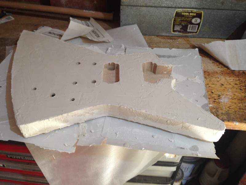

  8. #48
    top coat is on the mix came out a little chunky rather than completely smooth like the first batch but it seemed to smooth out as I spread it so hopefully that turns out okay
  9. #49
    Banned bargeloobs's Avatar
    Mar 2014
    1,700
    Should do the trick nicely.
  10. #50
    looks good Willem. If you need to do another coat of grain filler it's no big deal. Looks like you covered the body nicely
