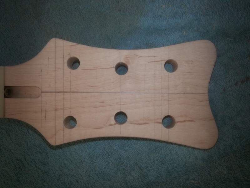

    It Begins
    The build starts here.
    Today I reshaped the hedstock and plugged the headstock.
    I used Dowel as these holes will be filled and painted. so the sloppy fit of dowel should not be an issue
    I could have bought a 10mm hole plug and made my own. I already have a 12mm plug cutter and will use that for the bridge holes.
    PK

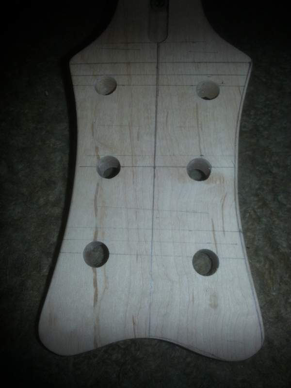

    Plugging tuner holes
    PFFFFTT
    Had to plug up a fourth hole as it was 2mm out, just a bit too much for my liking.
    PK
