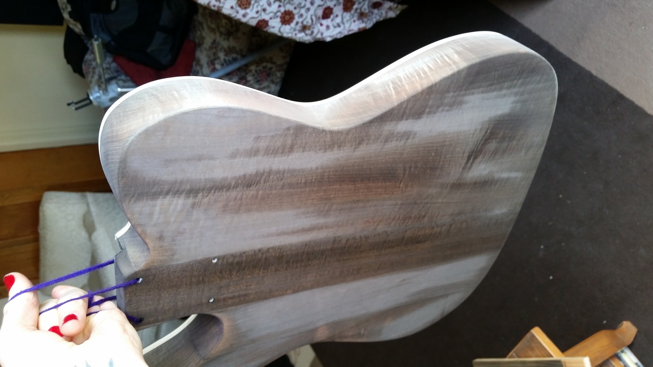

    Epoxy too old and not adhering properly led to me being sad for a while and sanding the ever living crap out of the back and sides.
    We're using it as a test for the beatle bass and ebonizing with red wine. Pics soon

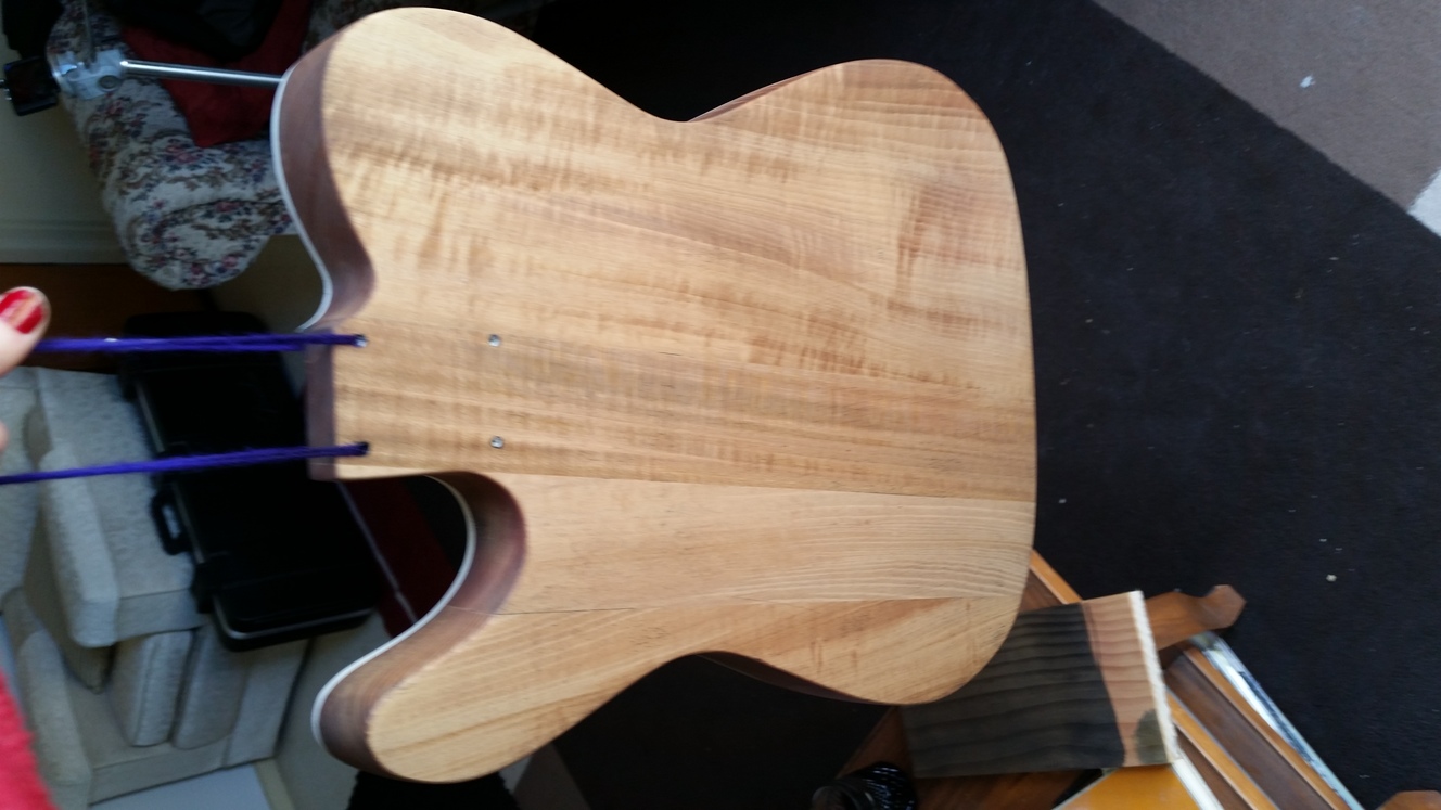

    Two fresh (before the ebonizing takes effect), one in progress of ebonizing and drying. 320 grit and BLO this evening.

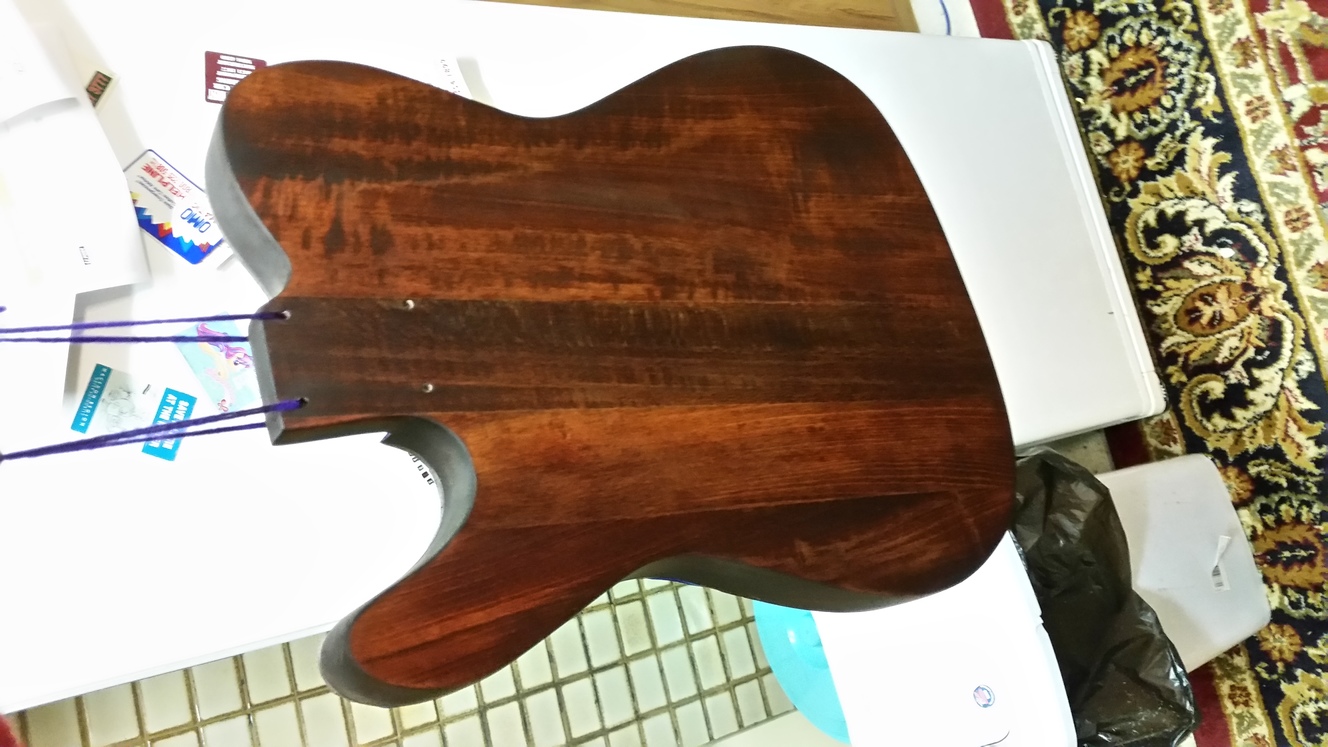

    Test for the Beatle bass complete and successful.
    After wiping with meths I wanted to put a little red int he colour. So used a mix of maple and jarrah.

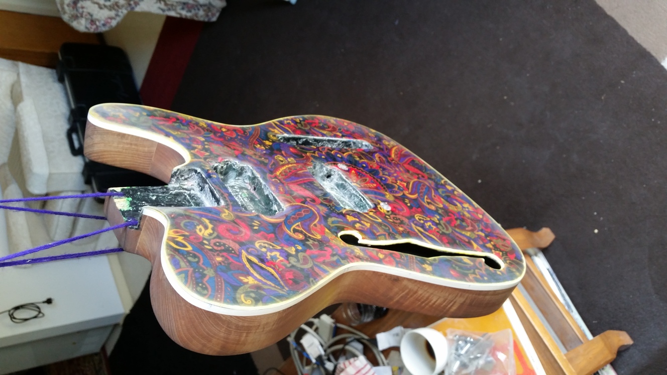

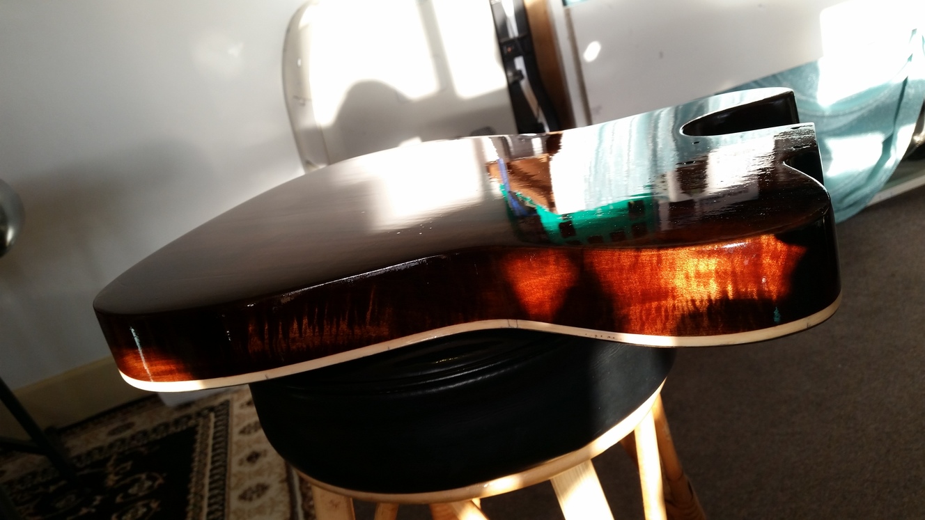

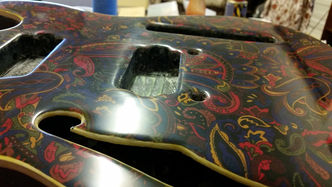

    Next level update
    The back is currently curing. I'll be wet-sanding in 2 weeks.

    I'm not sure this is relevant, but I've done an enormous amount of epoxy work on my yacht, and one very good trick to get durability and gloss is to apply at least one coat of epoxy, sand it smooth as a b's bottom, then coat it with several coats of varnish or polyurethane, sanding lightly between coats. You end up with a very high build surface, with a lot of depth.
    The main advantage here is that epoxy, left unprotected by a marine varnish/poly, will yellow very very badly in short order when exposed to any amount of sunlight.
    Your fabric idea is genius.
