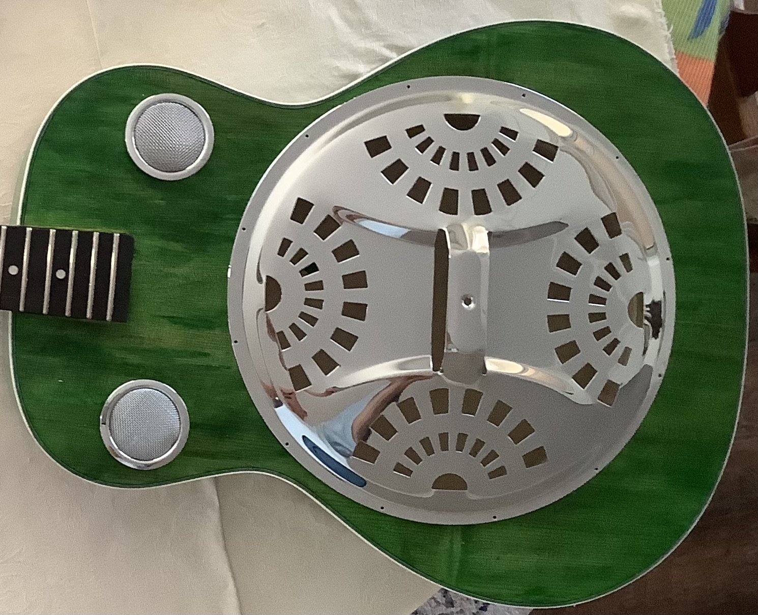

    Thanks fender I’m using feast and Watson oil based poly. After the previous hitch with not drying all seems to be going well atm. I’ve glued the neck and will put some finish coats on before final set up. Really like the ease of application and quality of the finish with the poly.
    I’m going for the “ just pulled this guitar outta the swamp” look

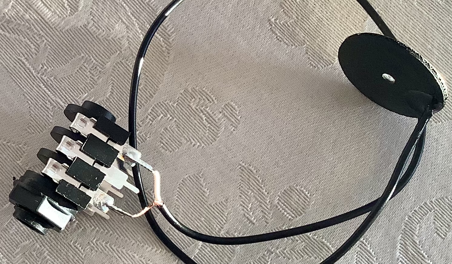

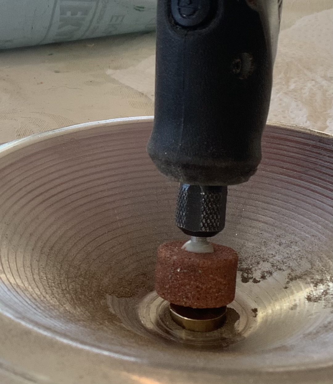

    I bought a pickup after pondering options for a while, I had to use a Dremel to “shave” quite a bit off the nut on the cone that the screw secures the spider to the cone. According to the instructions this is a normal requirement. This was scary but all seems ok, I attached the pickup to the cone and hooked it up to an amp - gentle tapping on the cone with a pencil was magnified a lot so will be interesting how it sounds when all set up.

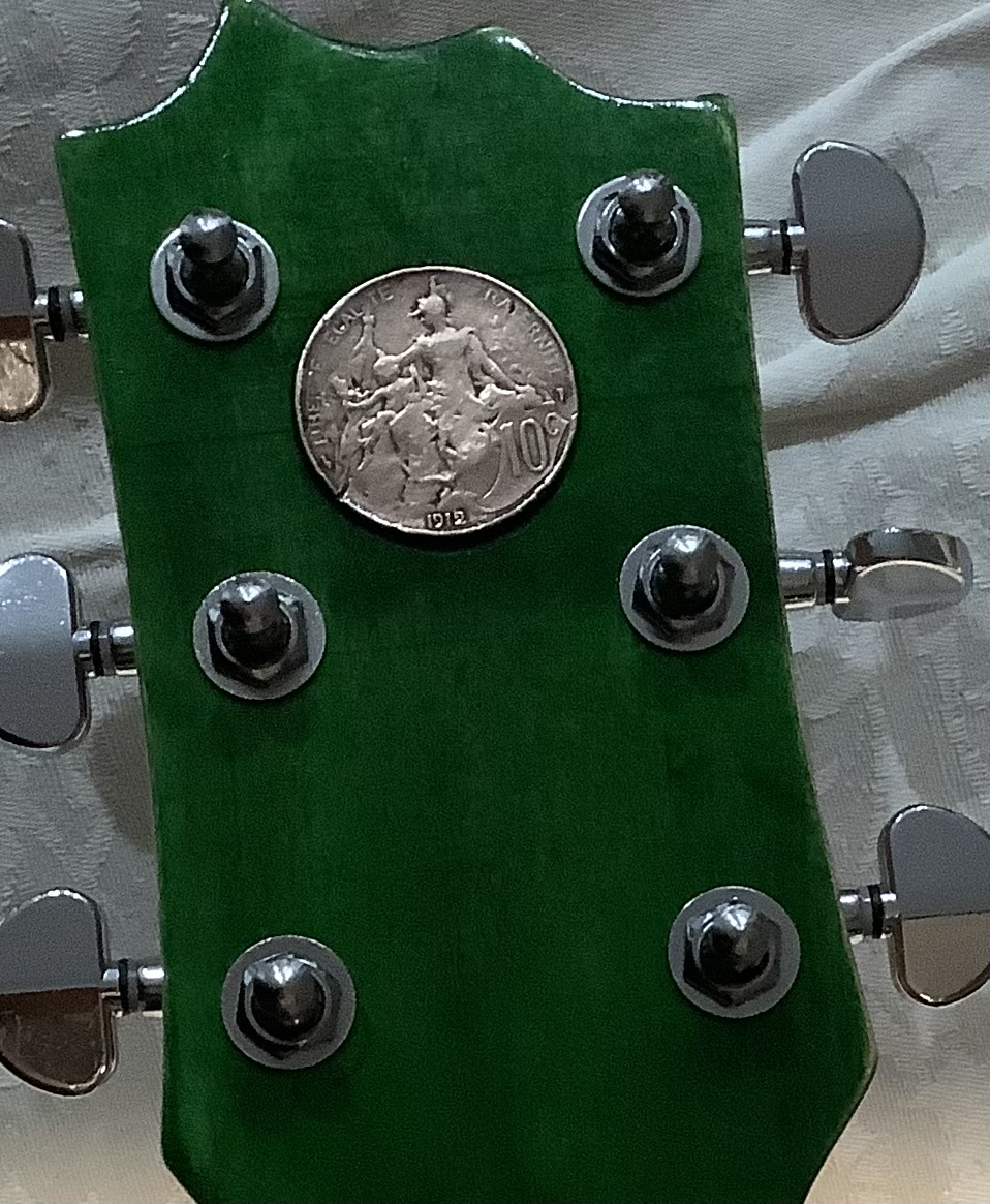

    I’ve set an old French coin into the headstock - maybe asking the Cajun gods of French Louisiana to imbue some Cajun rhythm into the guitar and my playing

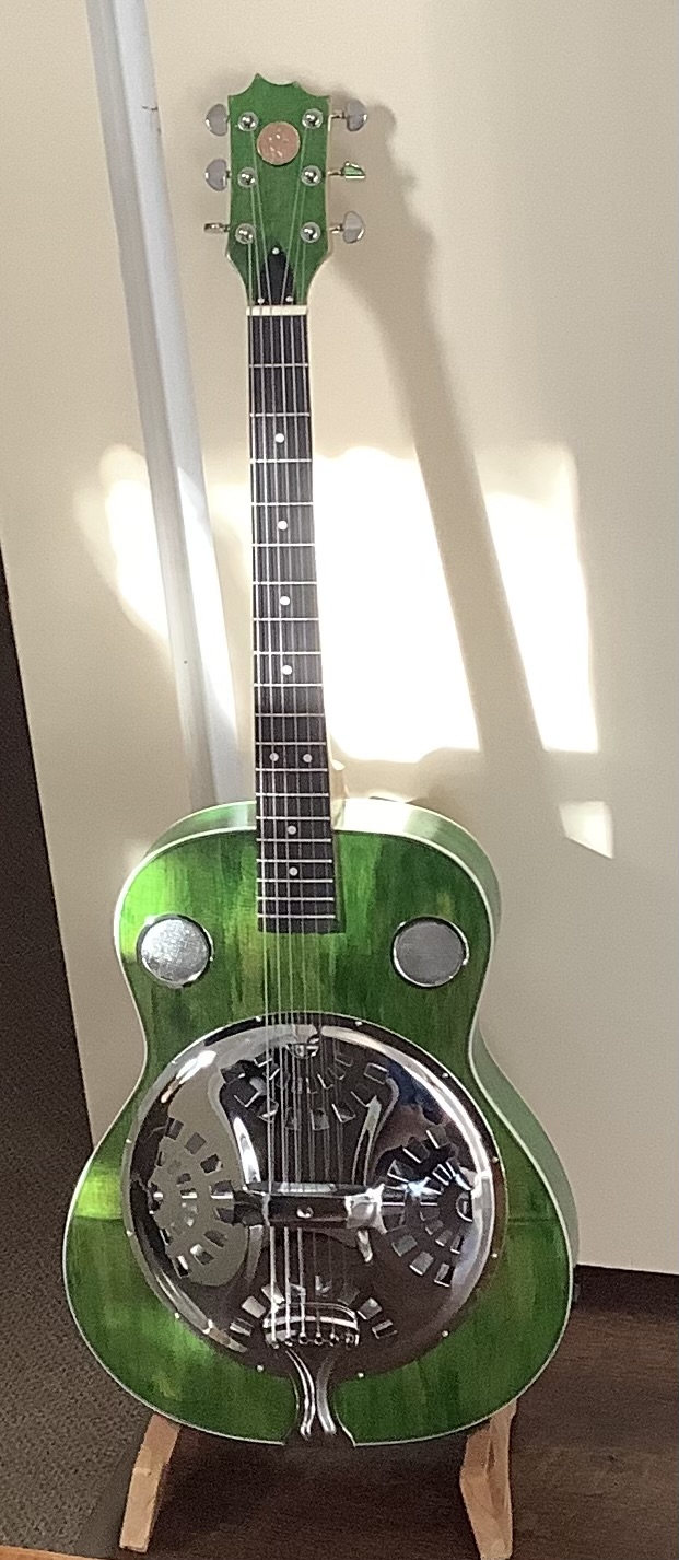

    Swampy is finished
    Finished product, strings on tuned to standard tuning for now, pleased with the final result. Volume unplugged is quite loud, I would say a bit louder than other my other acoustic steels. ATM it has standard strings on it - lite electric, I will try heavier acoustic strings to compare, it might take a while to find my preferred set.
    The pickup works really well after a bit (a lot) of messing around fitting it but well worth it I think.
    Certainly an interesting build.
    Hmm what’s next
    Cheers
    graham
