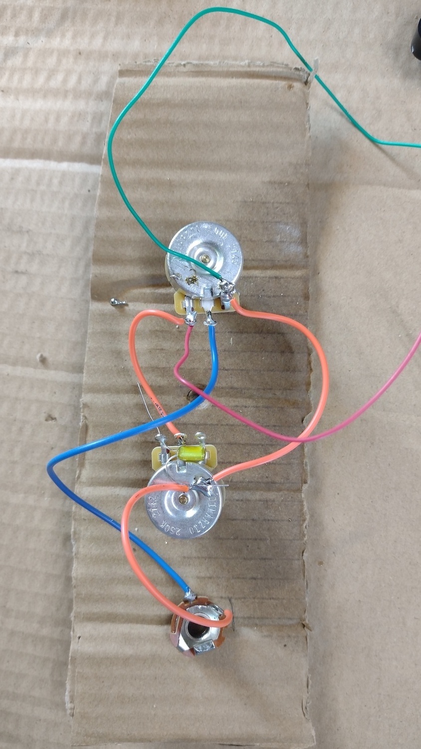

    after playing this bass non stop for several months now, I have decided to proceed with the pick up upgrade. I report here in case someone else is considering doing the same on their PitBull Precision bass.

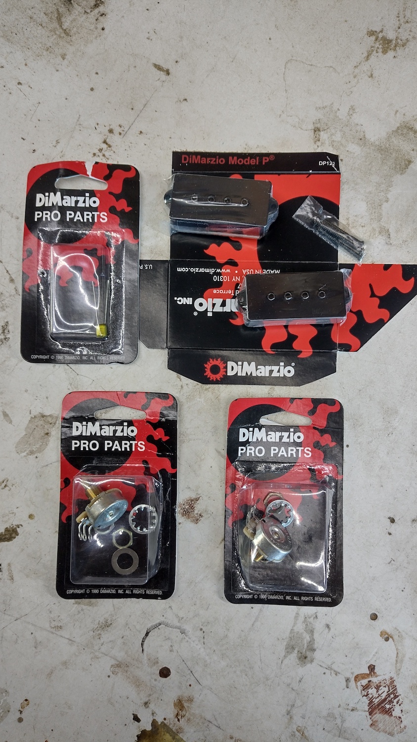

    About the pickup itself, after some research I settled on DiMarzio Model P. While I was there I decided also to upgrade all the electronics as well.
    Here the set arrived today
    Pickups, one 500k pot for the volume, a 250k for the tone, and a .033 cap

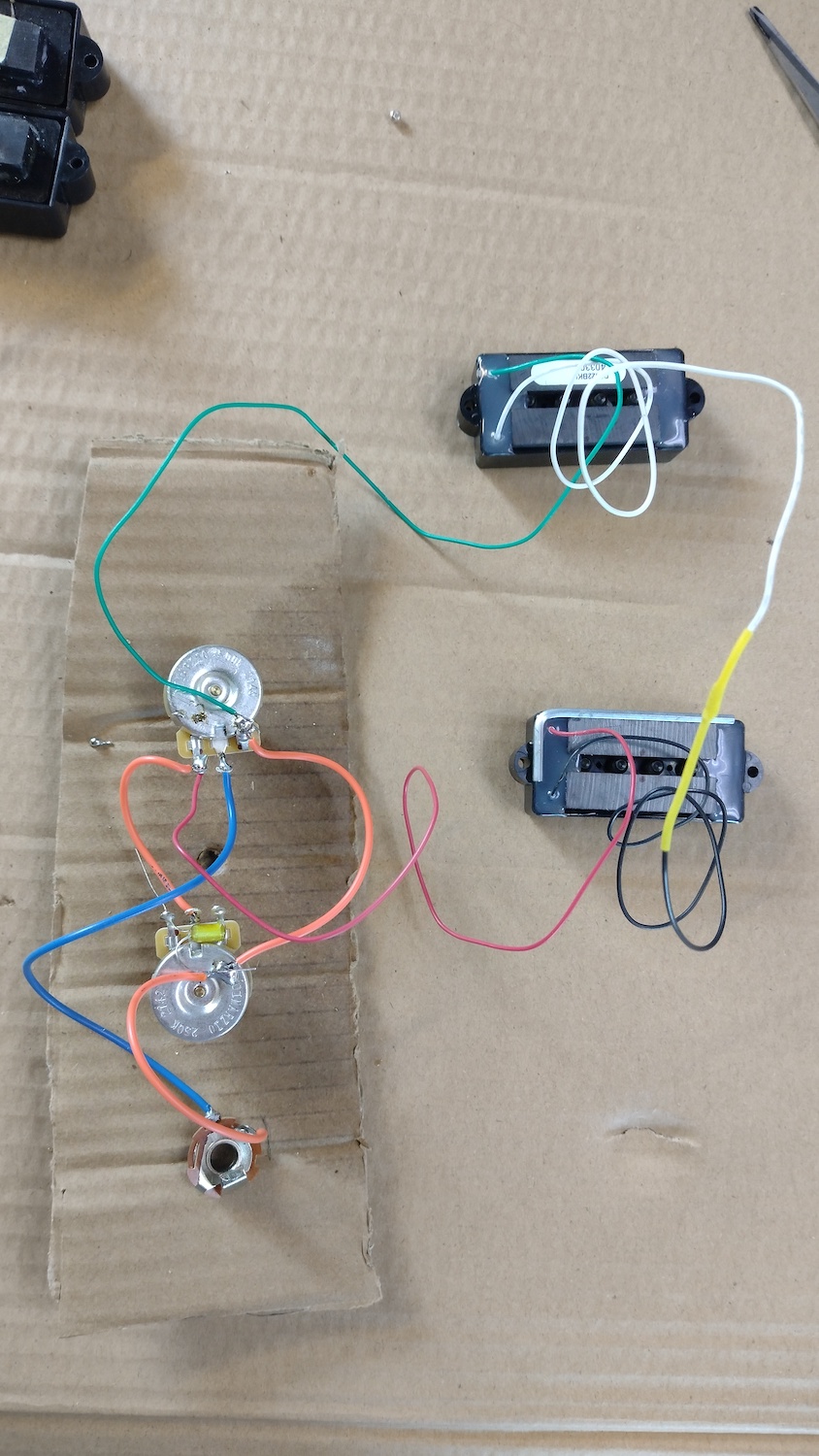

    I have never done an upgrade like this before and I must confess that I was bit nervous!
    It took me a while but following the diagrams step by step I managed to wire the whole thing up using the classic cardboard trick.
    I thought I measured the wires very well, using the kit electronics as reference, but somehow I ended up with a liitle bit more wire than I wanted.

    This is the bit where you unsolder one end of the wire, cut, and resolder to the right length.
    Aug 2021
    Blue Mountains NSW
    142
    Good point Simon, thank you for the suggestion.
    I didn't think of that; I've managed to fit it all in the cavity, wires and everything because I was so keen to test this upgrade; but for sure will do as you suggest, likely over the weekend.
    It was indeed a bit messy and annoying having to deal with all those wires when putting the pick guard back.

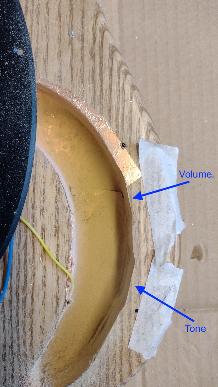

    After a quick inspection, I realised that DiMarzio pots are a fair bit larger that the kit ones, and both pots where touching the inside of the cavity, especially the tone pot.
    I took my Dremel and dug a little bit on the side of the cavity to make some space.
    This is the cavity before the mod
Name:	10_slot original.jpg

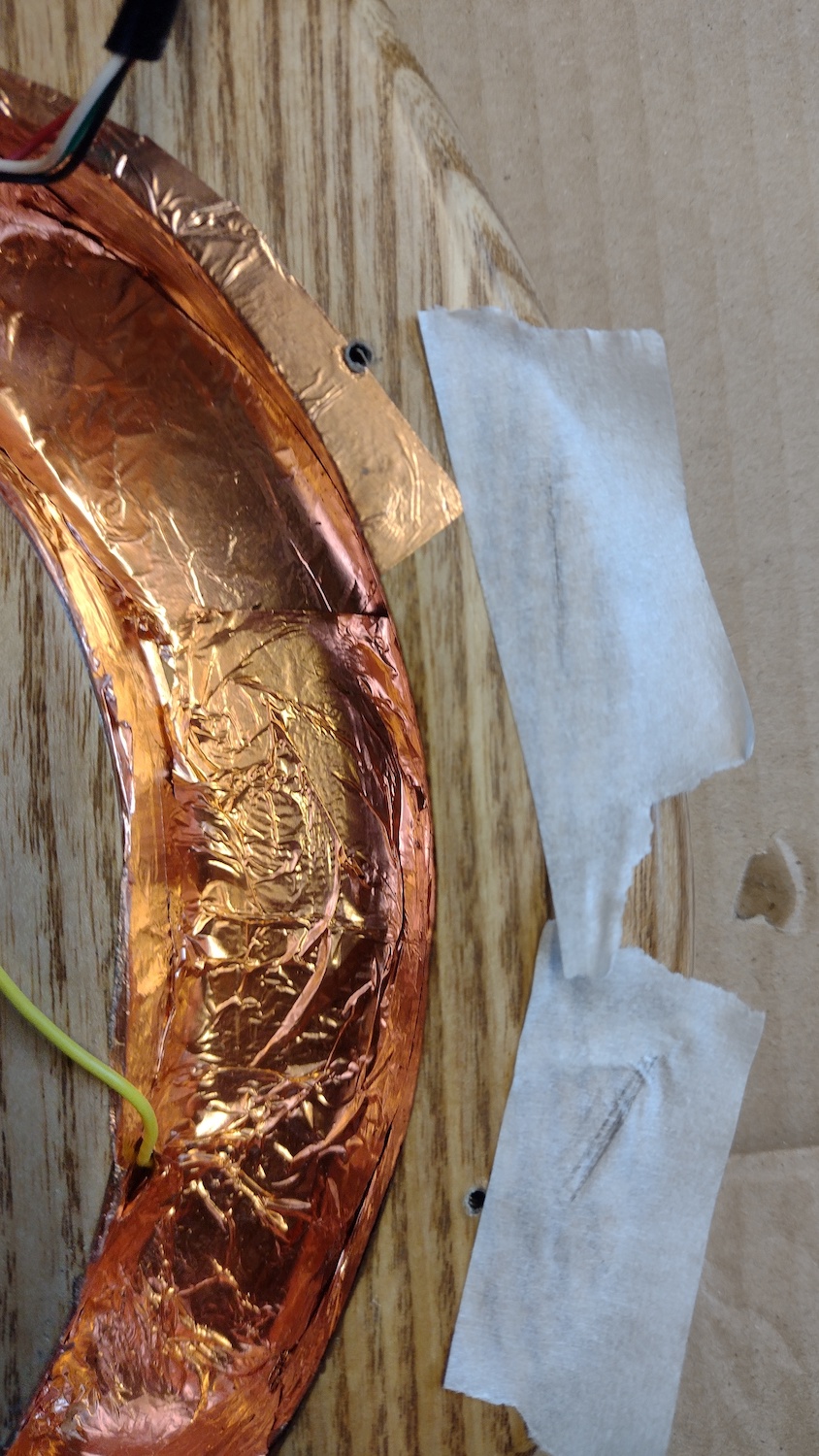

    and this is the cavity when I was sort of half the way the job with the Dremel.
    The copper tape at the bottom is still there, it's just completely covered by the ash dust.
Name:	11_slot dremel copy.jpg
    after that I vacuumed all the dust off, and put back some copper tape just where I had to dig some space for the pots.
    The pick guard now is well aligned.

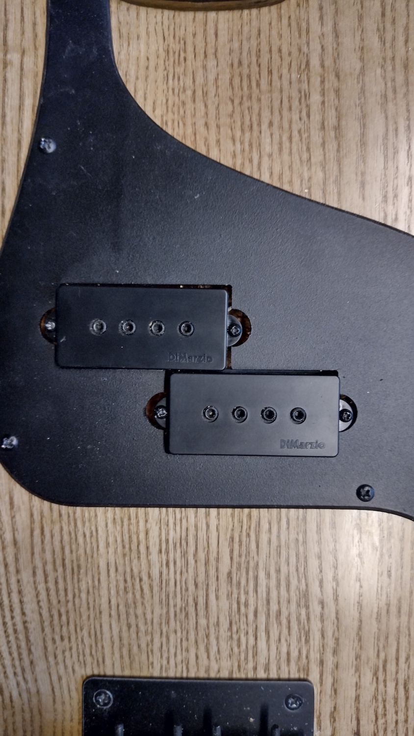

    After that I pre-drilled the holes for the new pick ups.
    The DiMarzio pickups are slightly smaller, so I had first to patch the existing holes that I drilled for the kit pickups, and then I finally drilled the holes for the new ones.
    This is a photo when I was half way adjusting the pickup height. I wanted these pickup to be at the same height of the old ones, for a fair comparison. Notice the pickup slightly smaller then the pick guard slots

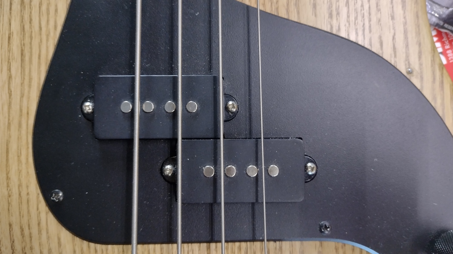

    Here for reference the pick guard with the kit pickups
