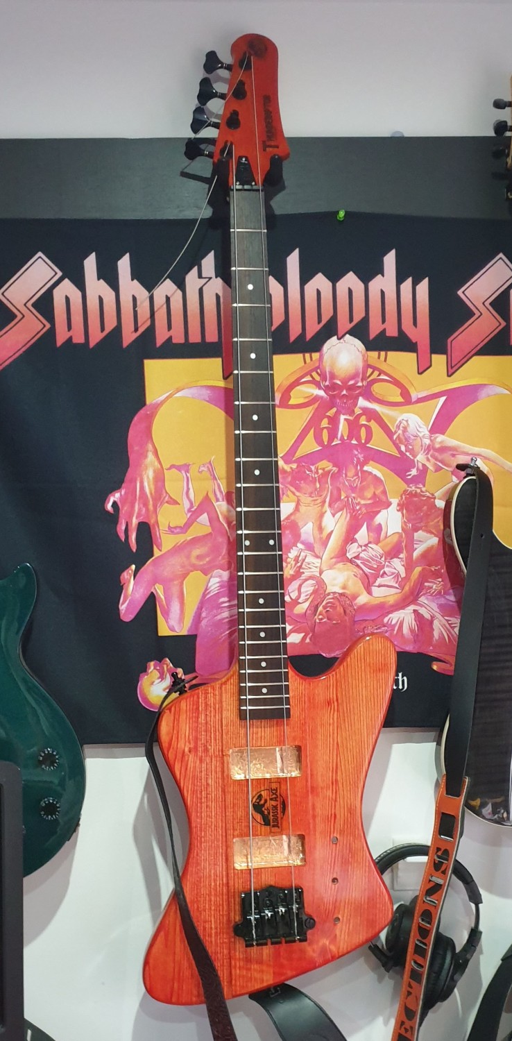

    Where this build is up to:
    - Hanging on the wall post a 1200 grit rub down and recoat. The decals aren't entirely gone but they look like they belong there at least. I don't want to put any more TO on it - the amber is starting to overtake the red, and i know that I'll need more in the future. It looks like i should be able to polish that up nicely once its had some time to harden up properly.
    - Pickups are *somewhere*. Possibly still in the US, possibly in AU waiting to be scanned in. Don't know. It's probably a good thing that they're not here yet or I might be tempted to put them in already and make my life miserable when I go to polish this next month.
    Given the sheer investment into this guitar, I'm pretty keen to get it set up.

    I'm a fairly impatient bugger, and in lieu of being able to get any of 4 guitars finished due to bits all being in transit, a brand new TV that arrived broken (our old one recently died), and not much else to do.. I decided to get closer to finishing this off.
    I gave a few areas a rub down with some 3000 grit, then gave it a fairly gentle hand polish with some Maguiars Ultimate compound before a quick layer of wax - including over the fret board. A quick run over the neck showed a few frets were a little high, so I filed them down, re-dressed them and got that sorted out.
    The nut is now graphite. I'd ordered the bone when I ordered the kit, but decided I wasn't putting white on it.. and I wasn't keen on keeping the plastic, so I swapped that out yesterday.
    The polishing was done - and its by no means perfect. I decided that too much shine would detract from the grain and the fact that I never spent enough time sanding is always kinda evident when you look carefully at it, so I don't see any point in aiming for perfection.
    I decided then to get on with the hardware that I currently have - the tuners and the bridge. The bridge took some getting my head around. Thinking I had the action as low as it could go, I was trying to work out how I was going to get about another 3mm out of it - the action was quite simply too high. After staring at the gap between the mount posts and bottom of the bridge and thinking bad thoughts.. I realised that I could actually get more out of it.. and it's now down to an almost acceptable height. I'd really like to get it a fraction lower, but it's within a mm or so of my trusty old Yamaha so I can deal with it.

    I threw on a couple of kit strings just to see how the action was going to look. When I'm finished they'll get tossed for a set of DR Blacks. Right now they're not even on the tuners properly - they're literally slotted through just to hold in place.
    Comfort-wise, unless the pickups weigh about a kg, it's horrendously top heavy. I considered an anchor point through the neck plate to see if that would help it balance better but it appears not. I put the kit pickups in just to see how that would effect balance, but not where near enough. The balance point feels like its somewhere between the 12th and 15th fret, so changing the anchor point doesn't seem like it'll be enough to counter balance it.
