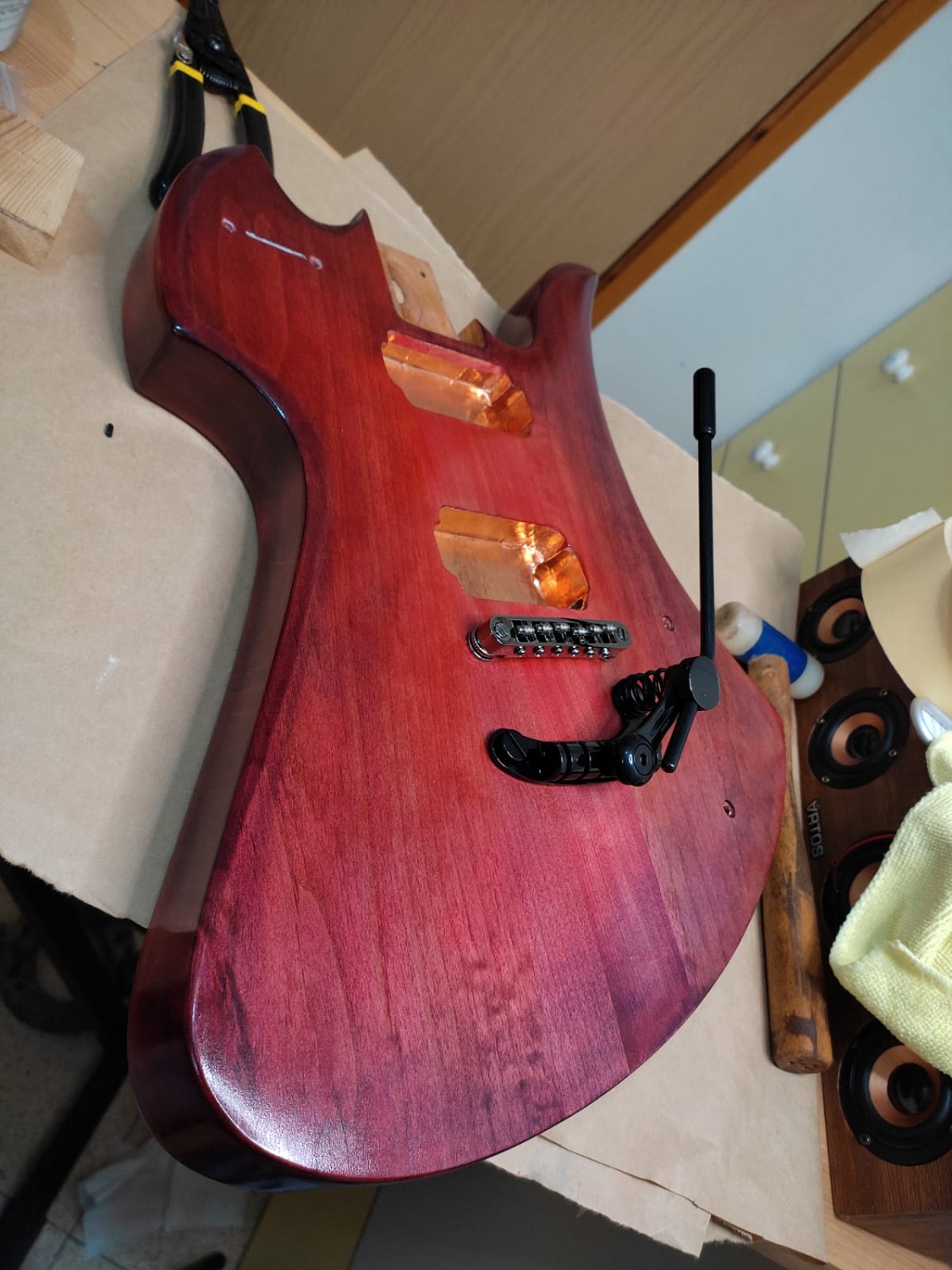

  3. #43
    I didn't make a progress for a while, I worked on two other projects (finished another kit and built a treble booster). But today I finally polished and waxed the body. The finish is far from being perfect, mainly because I didn't work on a clean surface so the body got a couple of scratches and dents, I tried to fixed it but I think I only made it worse . Anyway, as soon as I'll start playing the guitar it will get more worn, so it isn't so terrible.
