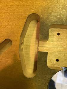

    I haven't worked on this project for good while as I've been putting the finishing touches to the PB kit and enjoying playing it!
    The next stage is to deepen the neck pickup cavity to accommodate the stacked pickup.
    I was worried about the stability of the router on the body as there's not a lot of surface to keep the router upright. So I ordered some acrylic and made a base. I didn't have a good way to make a hole large enough for the collet assembly pass through. I removed the base from the router and stuck to the acrylic in an attempt to use it as template. It meant routing without the base attached to the router which felt a bit sketchy. It didn't really work as I didn't end up with a perfectly round hole. But it's both big enough and not too big - so all good.

    I did a quick practice with the new base on some scrap and it seemed to work okay so I went at it on the body.
    It it seemed to work out pretty well. Did three passes and took about 4mm of total depth out of the cavity. It looks really clean and the now the pickup sits just proud of the scratch plate.
ID:	40569 Click image for larger version.
    The next problem was the hole for the wire was too high in the cavity and was preventing the pickup from sitting flat. So I widened the hole and that seemed to help enough to the get the pickup to sit low enough.
    There's some minor damage to the finish - why I didn't think to put some masking tape down I don't know #dumbarse - but should be easy enough to repair.
