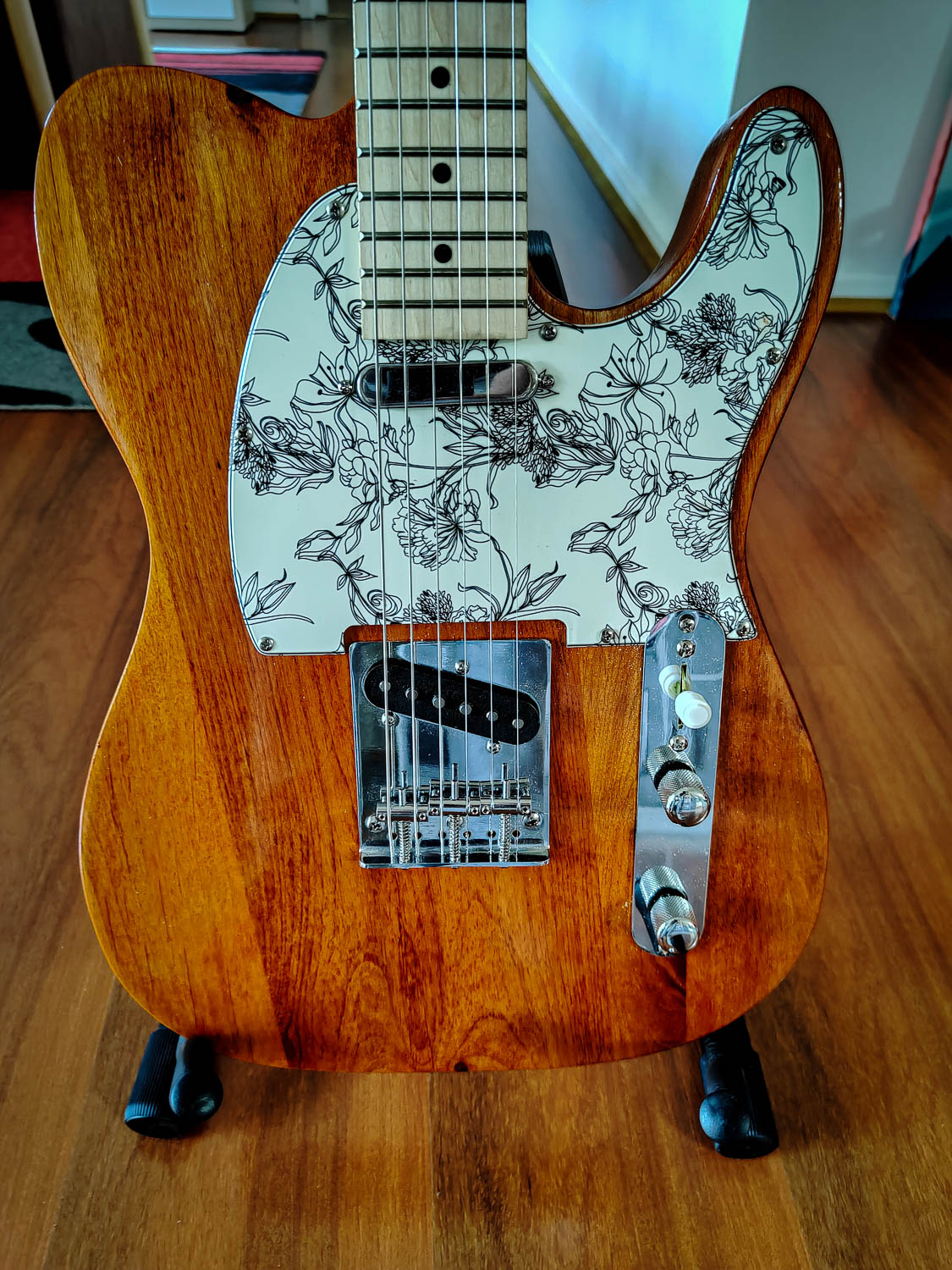

    ... and here it is. Yes, alignment of the pick guard is a bit wonky but other than that I'm really happy.

    Well that didn't do much. Still no neck pick-up. Wiring looks correct now. Might be time to borrow a multimeter.
