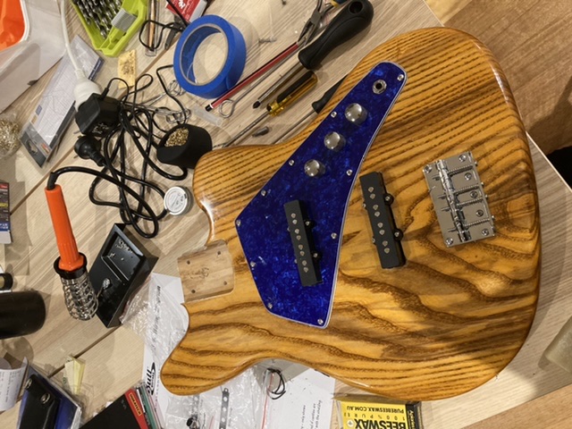

    Trials and tribulations of soldering but I finally got a lot done tonight
    Pickups and pickguard fitted. Neck tomorrow??!?!
