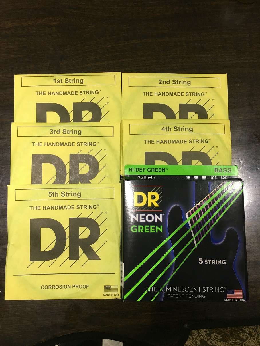

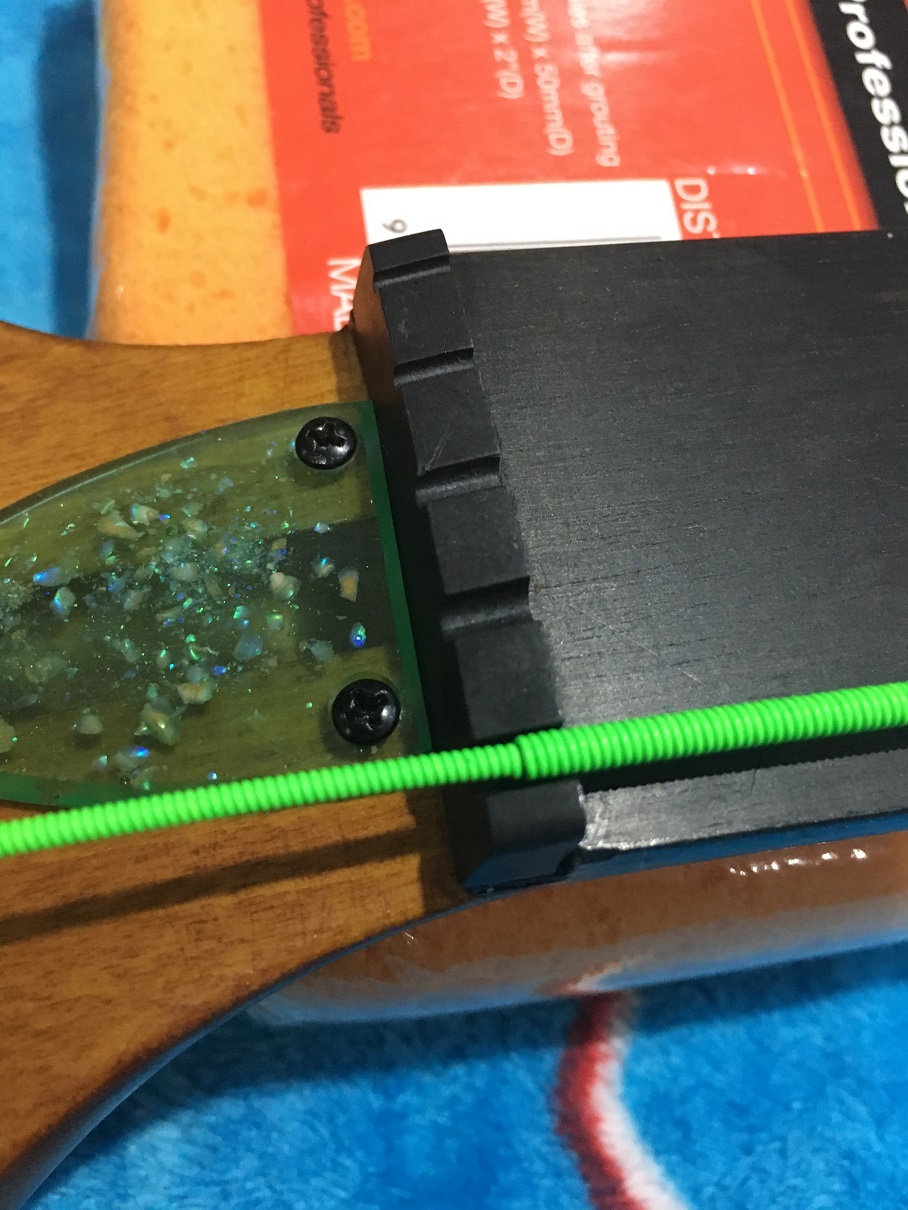

    So after much stress and mucking about, these arrived! DR NGB5-45. For those in the same situation as I was in, these were the longest 5 string bass guitar strings I could find ... and they glow under black lights ... yet to test them out!
    And, although it is a tight squeeze, they fit by the skin-o-their-teeth. It looks strange in the picture, but it does work trust me!

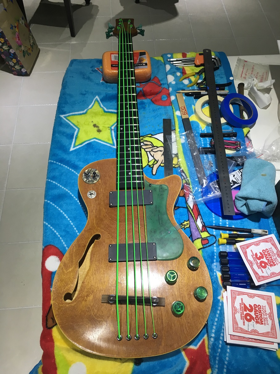

  6. #46

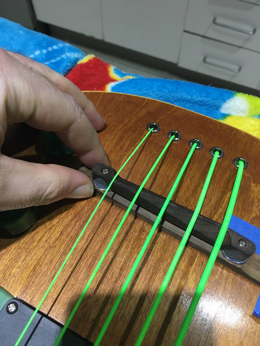

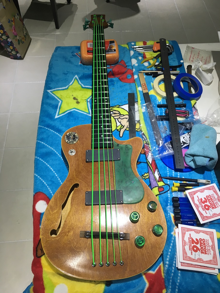

    I did a mock run, after measuring the distance from the 12th fret to the bridge (17") and smiled once they all were on!

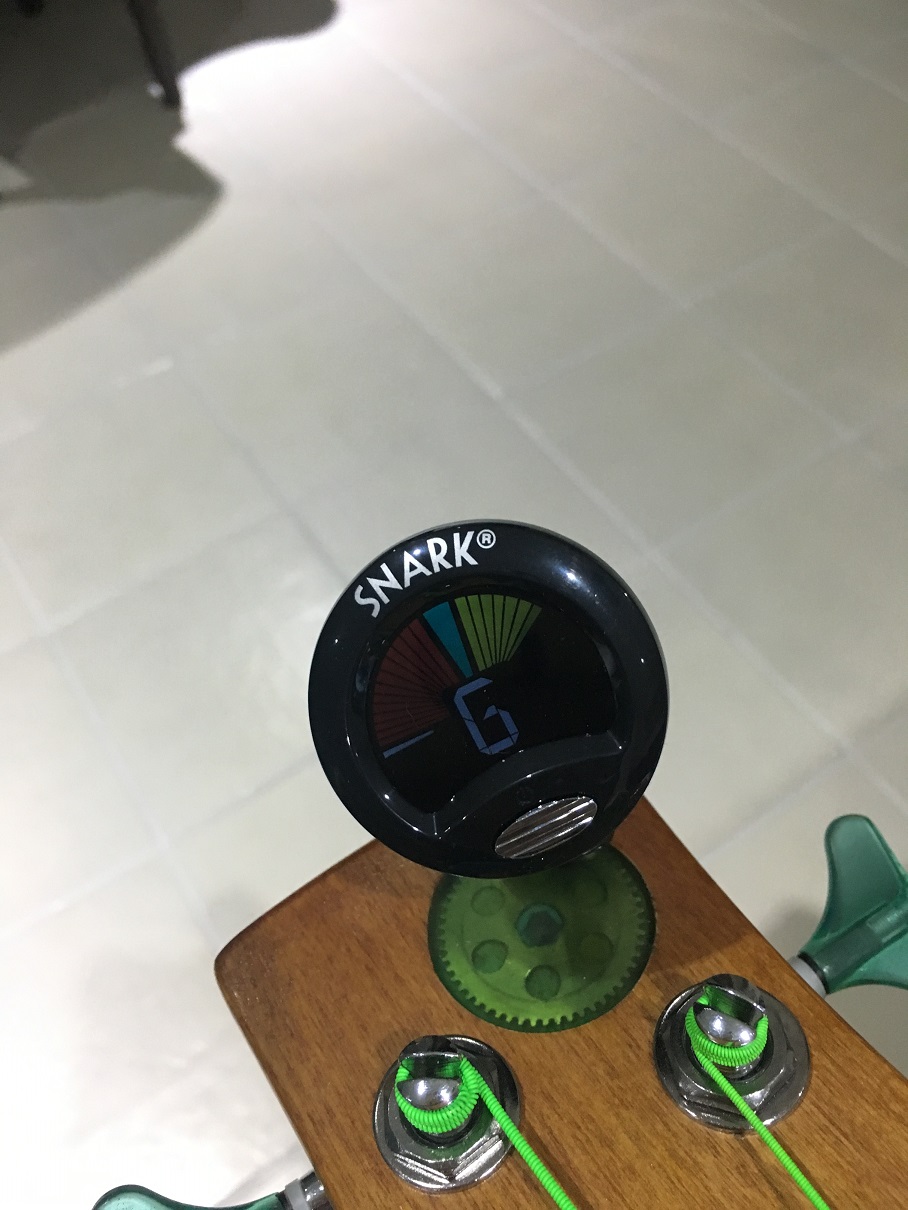

    Did some minor adjusting to the truss rod and bridge height and fine-tuned the action. Next step Intonation ...

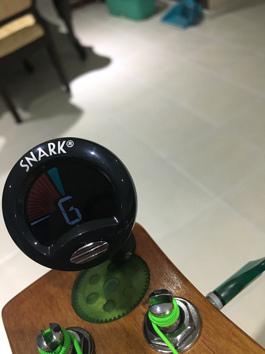

    This proved more tricky than I had hoped.
    First attempt, the open G versus 12th fret ... was a little sharp

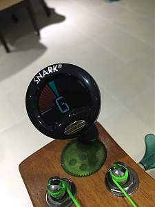

    Open G

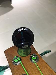

    12th Fret G

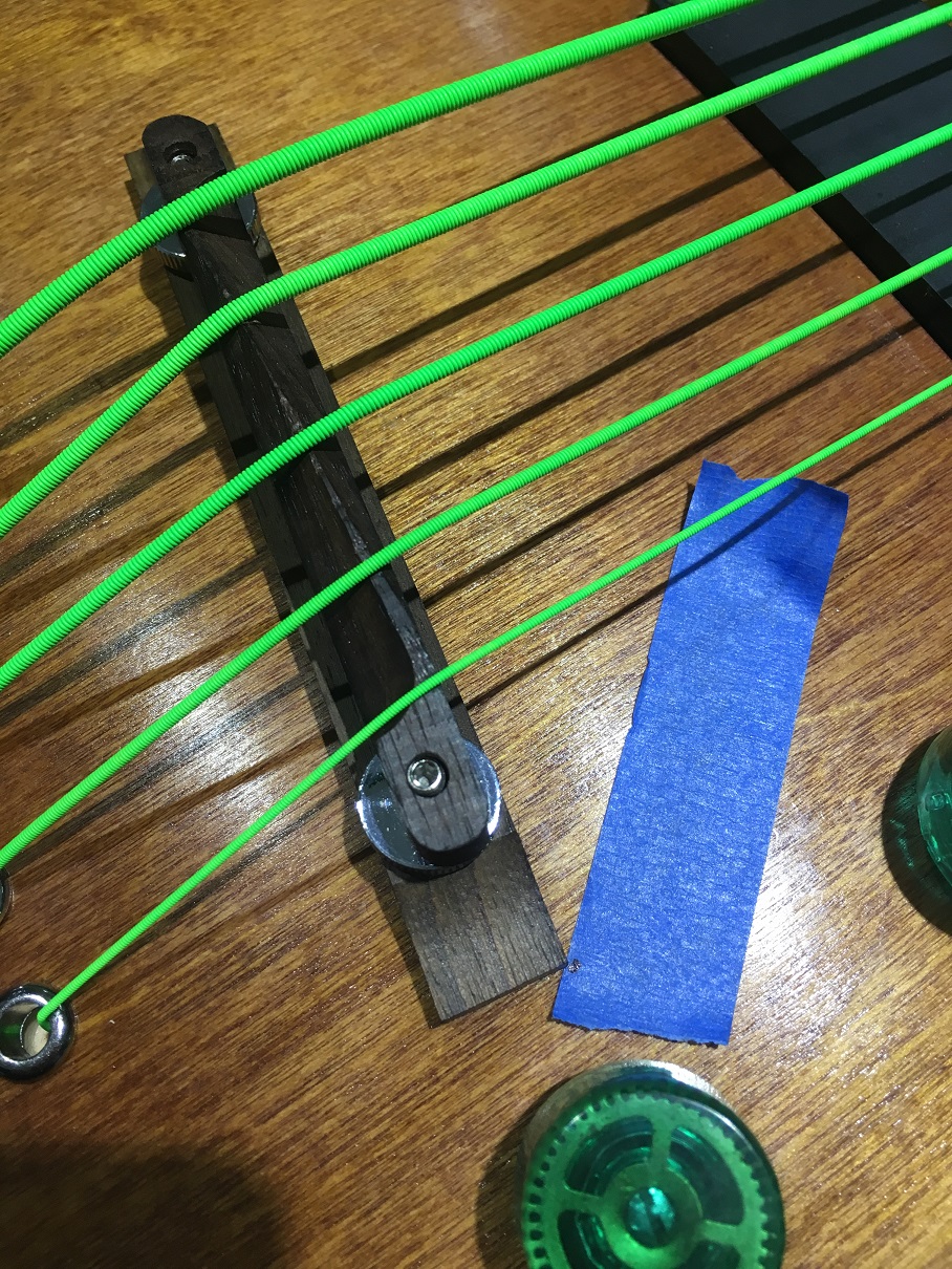

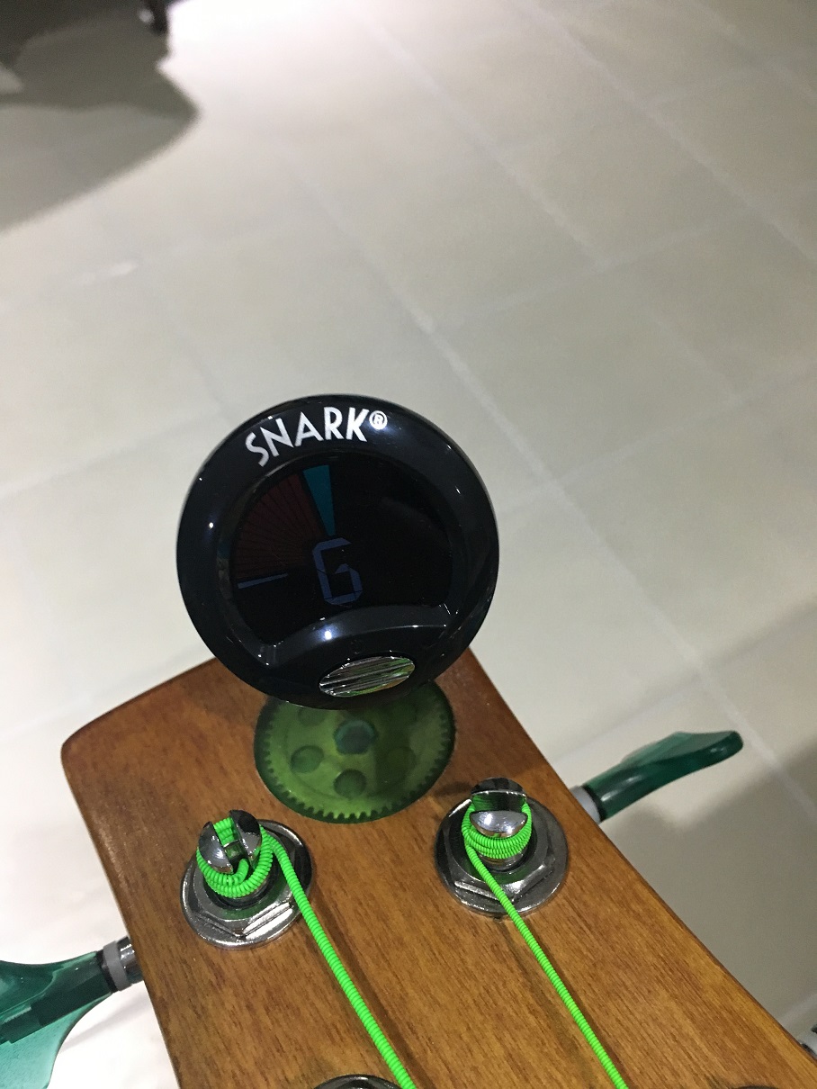

  7. #47
    You're going to need the bridge set fairly flat I'd imagine. The saddle already has an angle on it so it shouldn't be too far off. 0.045" string saddle position nearest the neck and the 0.125" string furthest away.
  8. #48

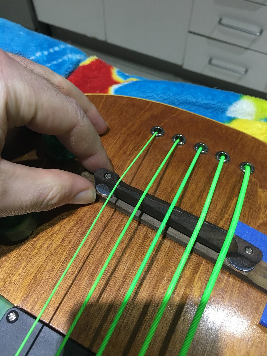

    After adjusting the bridge it is looking better ...

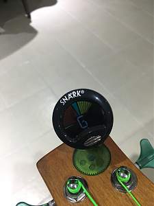

    Open G
    12th Fret G
    Once the G was sorted, I placed tape so that I could remember where it was before adjusting for the E. I only had a 4 string tuner on my phone so focused on this string rather than the low B.
    This was tricky and after 3-4 hours it finally worked!! That floating bridge is a tricky sucker. I think I might pin it so that it doesn't move.

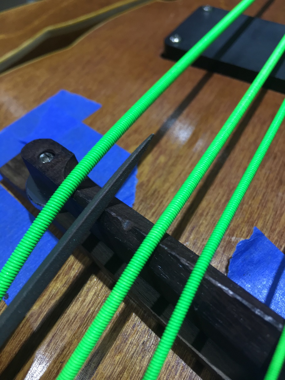

  9. #49

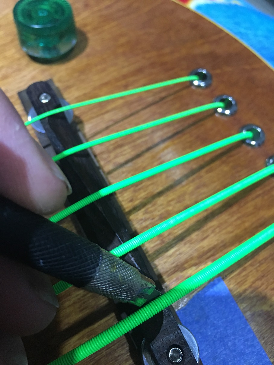

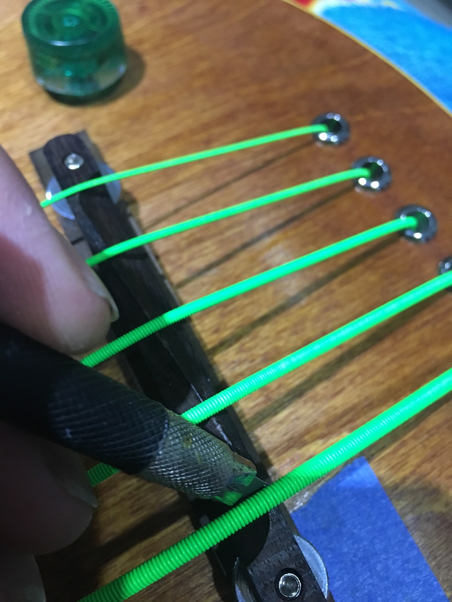

    The pressure from the strings had made slight depression in the timber bridge, but not enough for my liking. I used a blade to mark these lines ...
    Then used a file to create slight divots in the bridge to hold the strings in place.

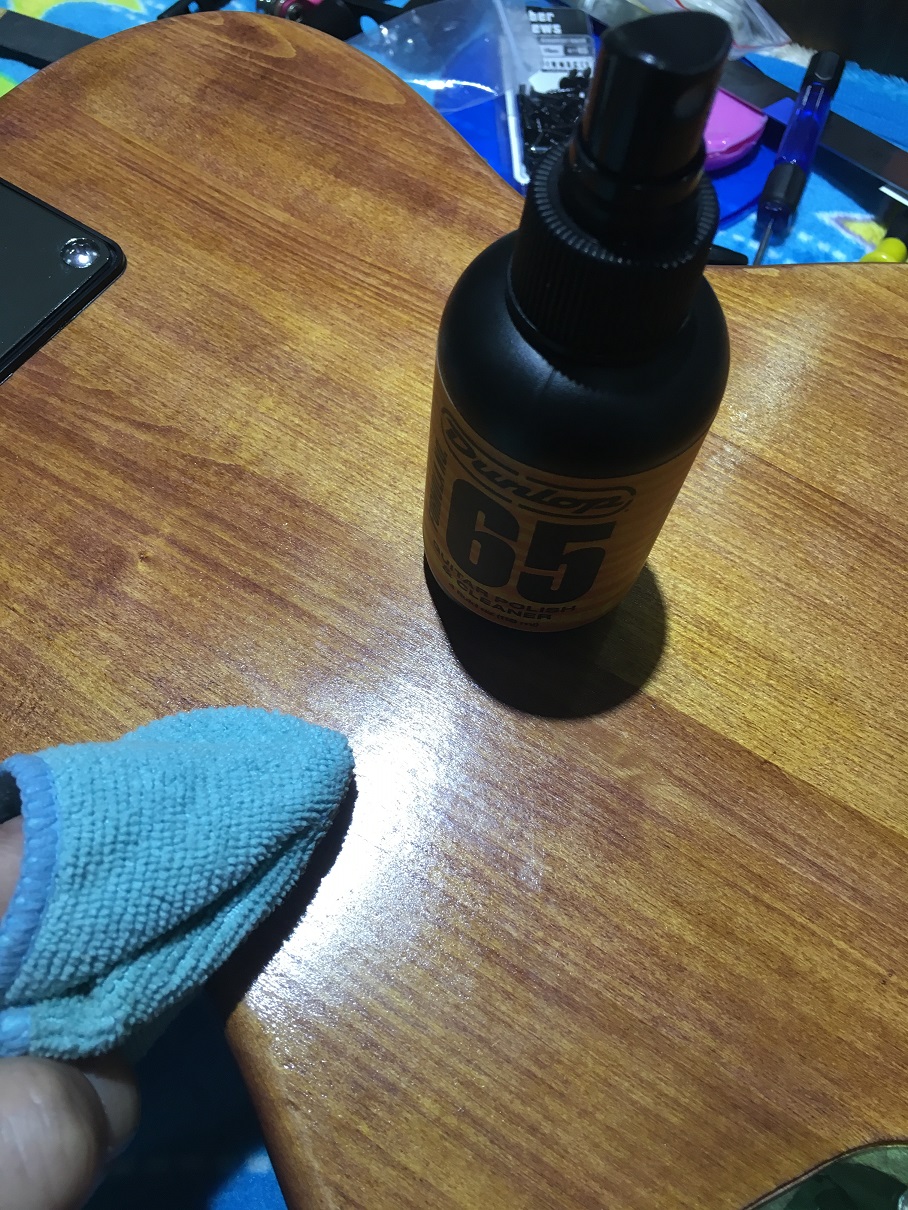

    After it was all tuned, it was time to pat myself on the back and give it a good polish.

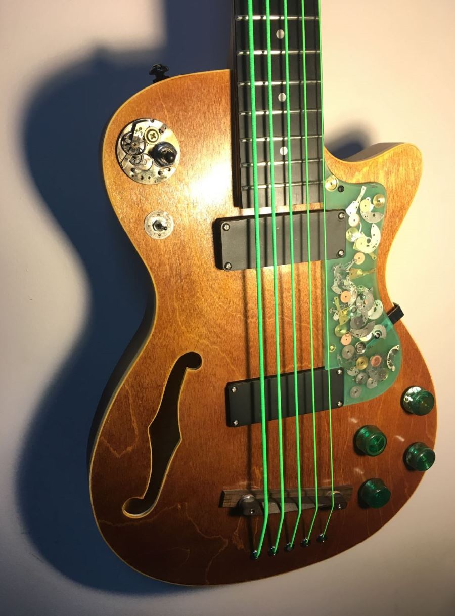

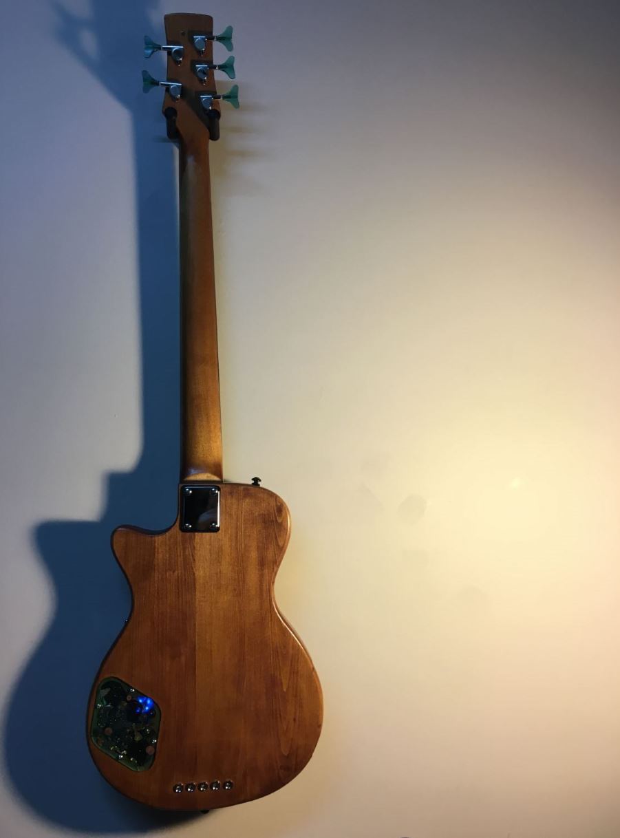

  10. #50

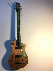

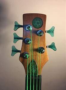

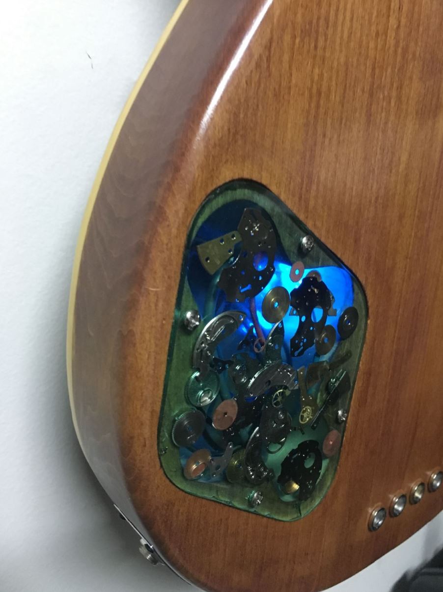

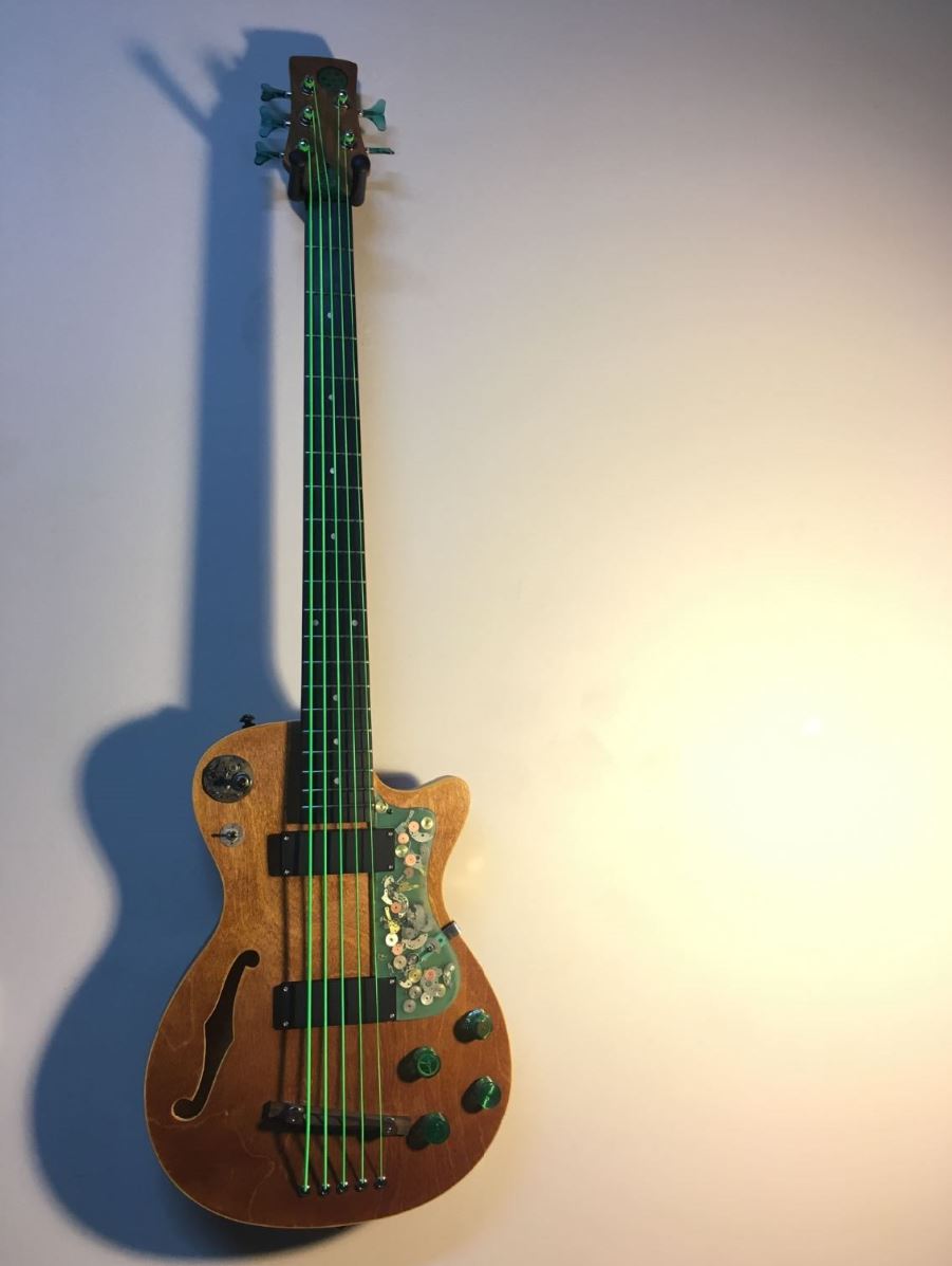

    Thanks for coming along for the journey, it has been so nice. Thank you to everyone who has offered support, without your help it would have been much more difficult. Such a wealth of knowledge out there with so many generous humans!!
    Here is the finished piece ...
    ~~ love through art ~~
