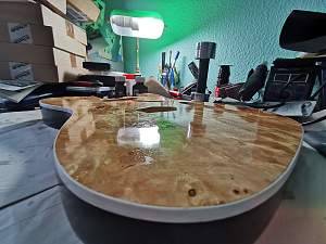

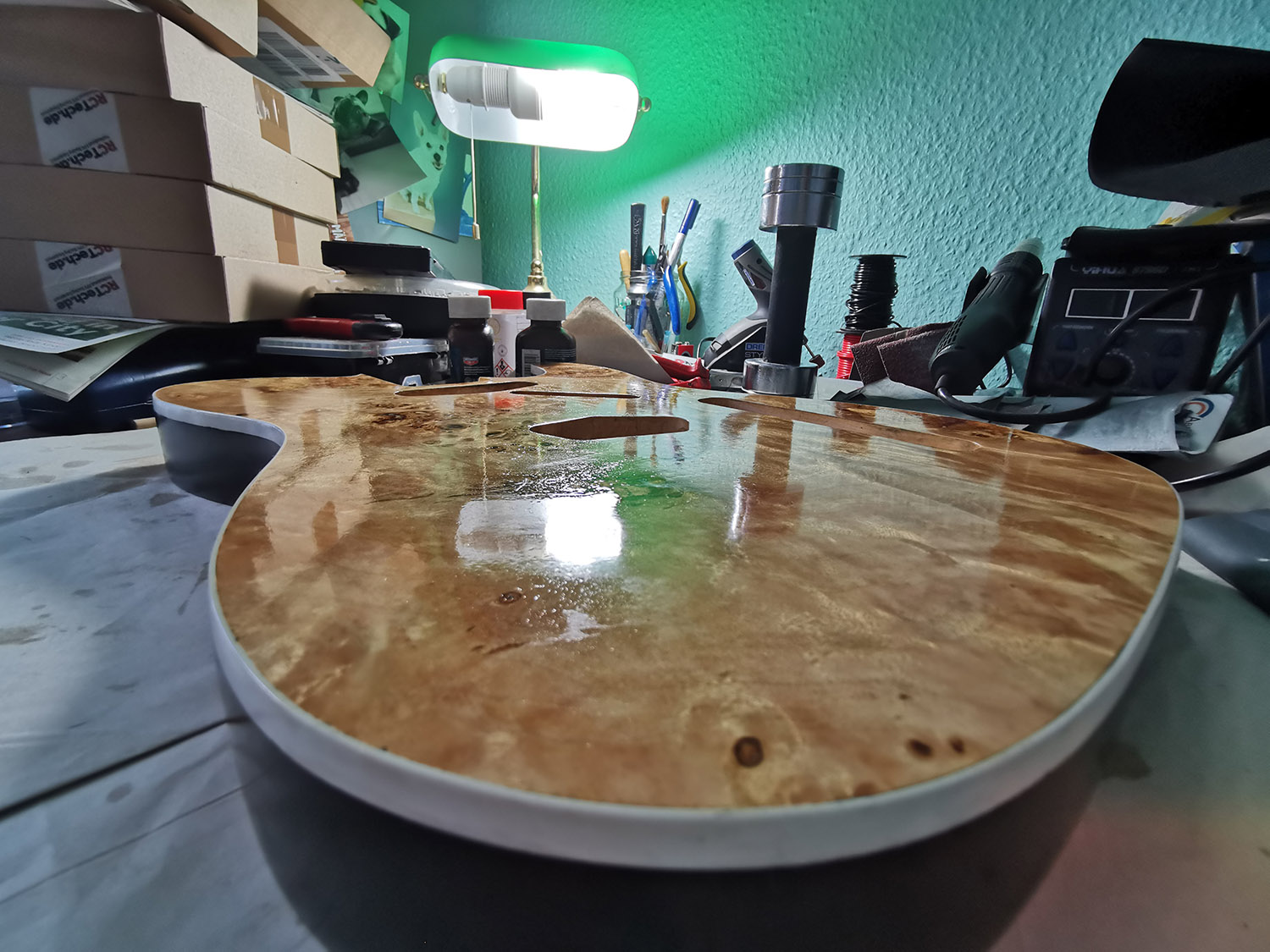

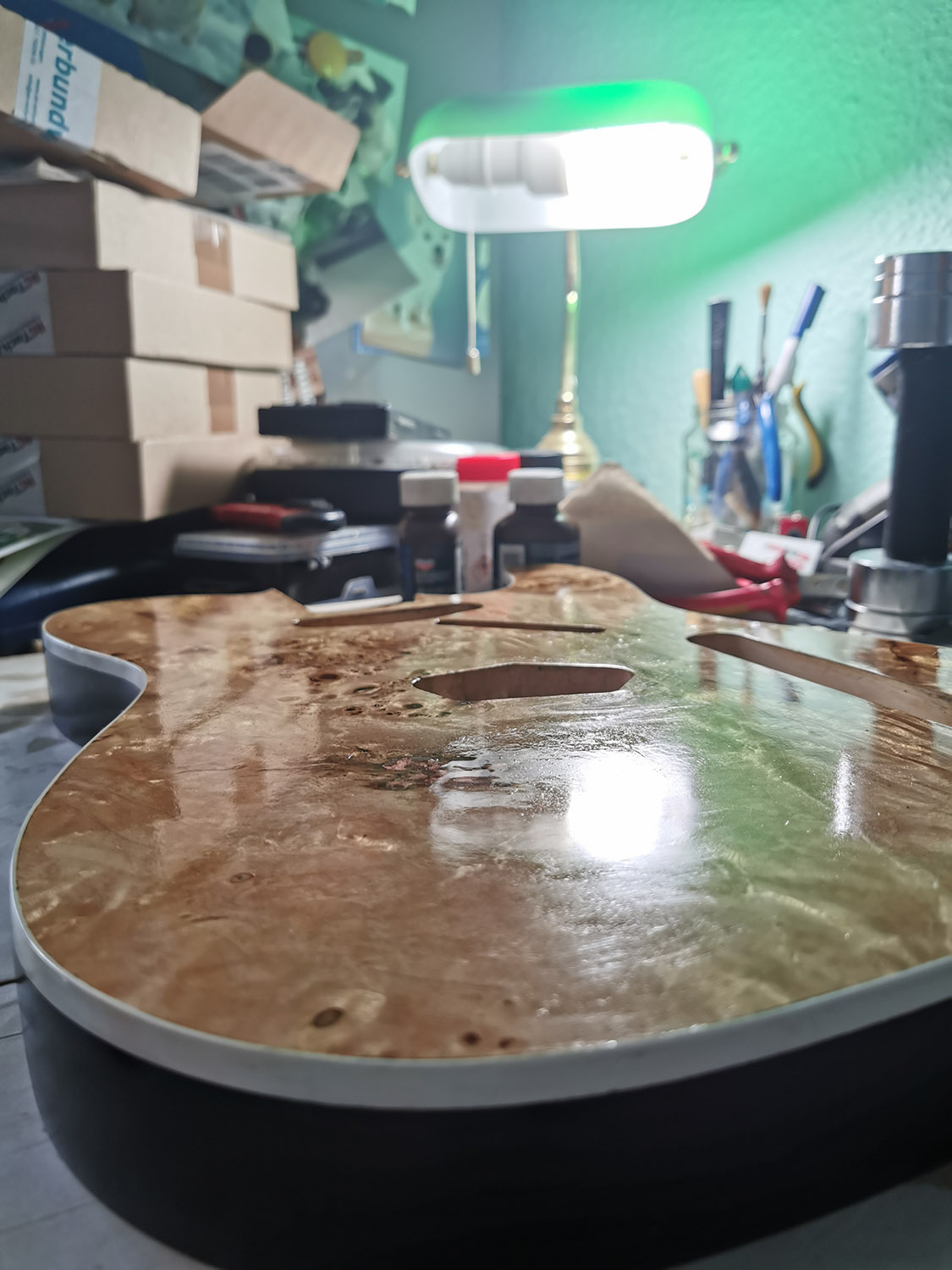

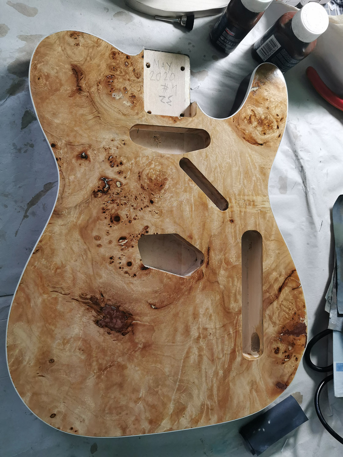

    A tiny update. Still doing the tru oil thing, but I think I slowly got the hang out of it....
    Currently filling up all the holes and dimples on the front side, not the easiest thing with a burl veneer
    If it looks halfway decent (no dimples left), I'll add a few thin coats of tru oil with turps and then leave it to cure (that means doing the back side ;-) )
    And then... I guess finally assembly waits! (After it's cured of course)

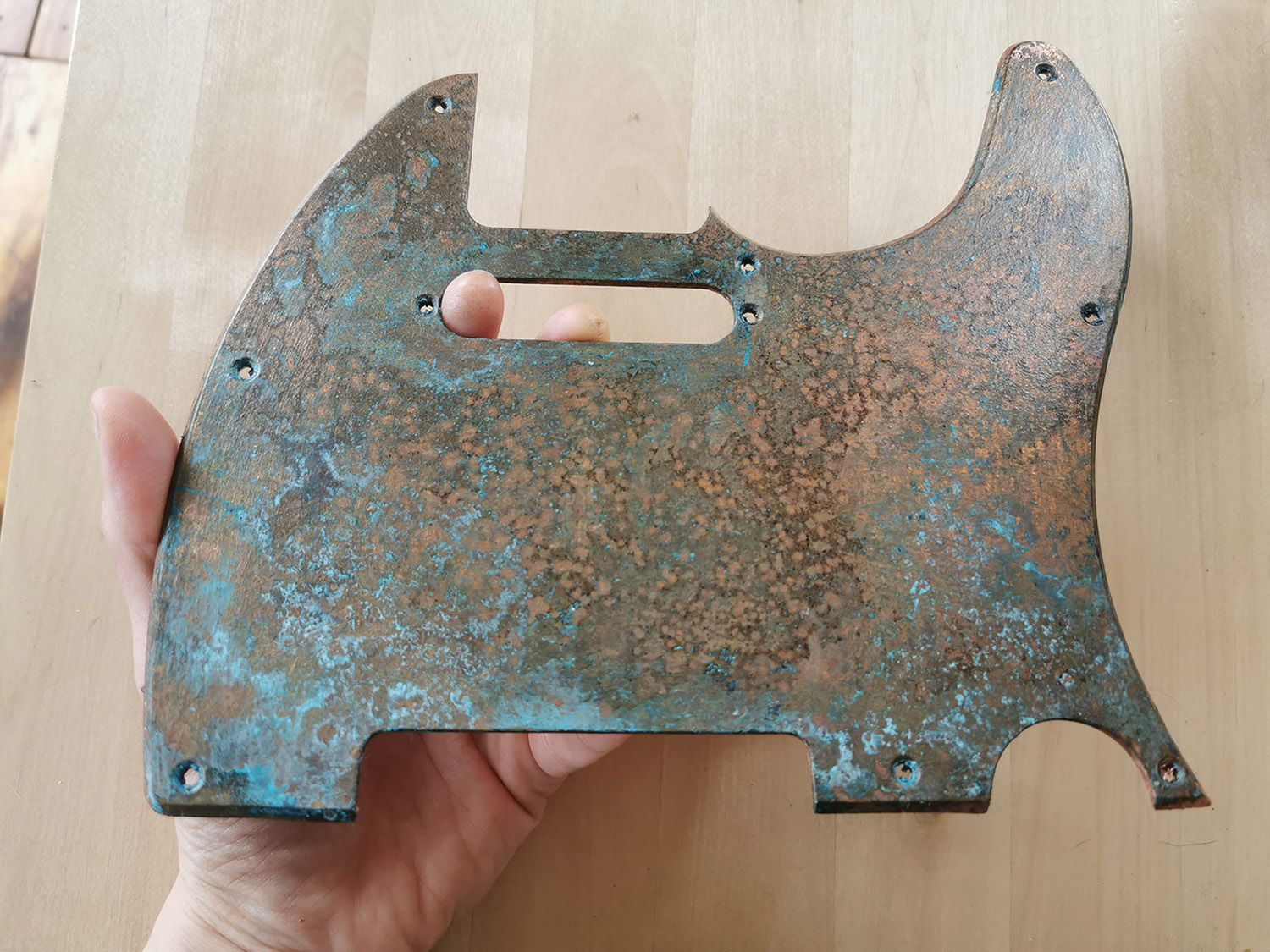

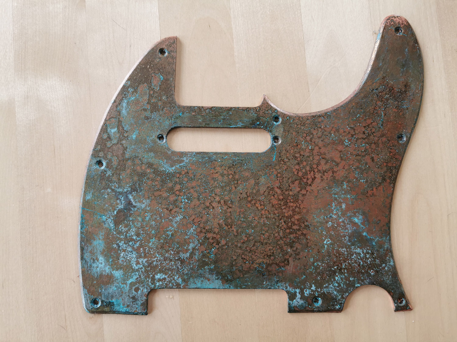

    And the pickguard is finally lacquered and cured:
    Due to the irregular surface, it has more of a matte sheen instead of a gloss look. I'm torn here... I don't think the rusty parts should be shiny, but I also don't think the few non rusted spots should be matte. But I guess as it's only copper plated, there is no real solution, as I can't just buff up the copper, it would probably be destroyed. So lacquering it was the only option... besides buying a sheet of copper and just making my own pickguard (which I will do for the next build for sure ;-) ).

    I finally reached a state where the surface on the front is almost perfectly even and smooth (gosh how many hours of my life have I put in this?). How should I proceed best? The last few coats where heavily thinned with turps to smooth and even everything out, it looks nice but it's not high gloss like the tru oil without the turps. What is the last step to gloss it up again? Leave it to cure 2 weeks and then polish and wax, or should I polish it now? I have a complete Meguiars car set, it has polish and Carnuba wax. Can/should I use this or should I better get "proper" wood wax from the hardware store?

    Certainly let it harden. Sand flat and then polish with Meguires or any polishing or cutting compound. The moment you start sanding, you'll find that it isn't as flat as you think it is as you'll have a sanded surface with shiny pits. It really doesn't matter how shiny the surface looks at the moment. You need to sand until those shiny pits have gone. Nothing too coarse, P800 to start with, and use it wet, water with a drop of washing-up liquid in to stop the paper grits getting clogged.
    If it's taking a long time to remove the pits, then swap to a coarser grit, maybe P400, until they've almost gone, then back to the P800 until they are gone.
    Once the pits have gone, swap to a couple of finer grits, say P1200 and then P2000, each time for a brief sand over to remove scratches from the previous grit, no more. Wash down and remove the residue each time you change grits.
    After that you can polish and it should be super-shiny in no time.
