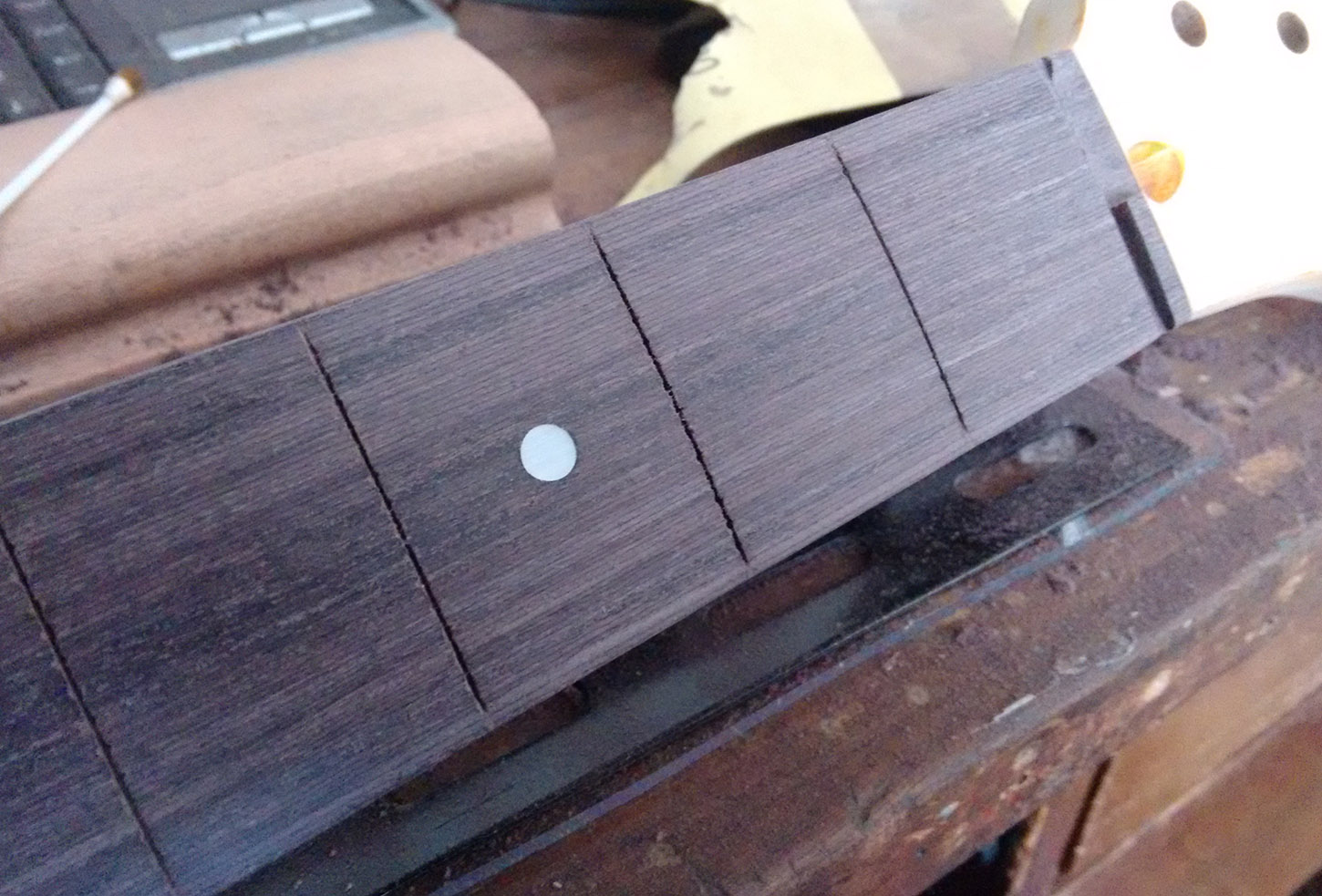

    And is that real or engineered rosewood?
    This is engineered rosewood. It came on my TL1-R kit and I got another one from ebay.
    I'm doing a 7.25: radius on it and using F&W mahogany stain to darken it.
    I'll seal it with clear spray on lacquer that I use on the rest of the neck but probably sand it matt.
    cheers, Mark.

    Interesting. I sealed my board with thin CA based on advice from Sonic and Simon. I still have work to do on getting an even finish on it (currently uneven sanding around the frets) but it feels as smooth as silk. My hope is for a smooth fretboard that doesn't grab strings but still looks like rosewood.
