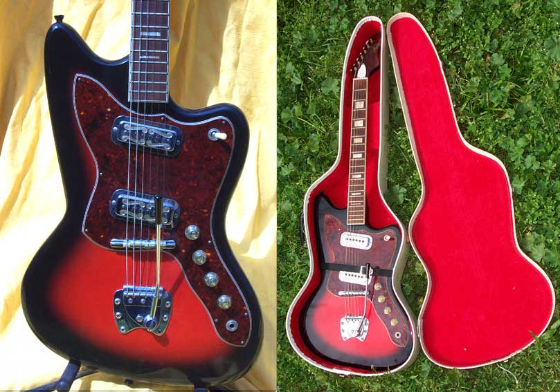

    I was just reading a review of the Harmony Silhouette in Guitar magazine, and it does bear quite a resemblance to your design.
    https://www.harmony.co/pages/silhouette
    The new Harmony brand isn't directly related to the old Harmony brand, but they use some of the old designs as a rough basis for their new ones. In this instance, the old H19 Silhouette, which was much more of a Fender offset copy.

    Yeah I can see that. It’s not a terribly original design really this one, but it is directly derived from the Deluxester. I ‘sheared’ the body and dragged the top horn out and the lower one in. It looks a bit like the Shur offsets to me. I like it, but it’s not really different enough to stand out.
  8. #408
    There are any number of guitars influenced by the Fender offsets, but the general simplicity of the Harmony finish was more in the spirit of your design than many I've seen.
