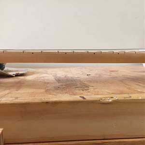

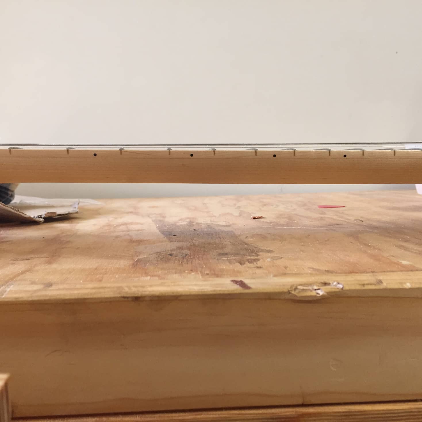

    One thing I’m not sure about is the fall away of the strings. In the photo you will see a really low action close to the head stock, then it starts to fall away at the third fret. Also there is a slight buzz on the low E string when playing the first fret. It’s had strings on for about a week now. Should I be patient and wait and see if it evens out? Or is this a shim the neck or truss rod fix? It’s not a big deal for me as to me it plays good.
  2. #32
    First step would be to check if the neck straight, or concave. You will need a notched straight edge. If you don’t have one, you can make one with a metal metre ruler. If the neck is concave you can look at adjusting the truss rod. If it is straight you may need to shim the neck.
    The neck adjustment may lead to more fret buzz, so you will need to re level the frets. Sometimes this can take a few turns to get it right.
  3. #33
    Buzz on the low E string with the neck like that can only really mean that the nut slot is too low or the first fret is really high. But you've levelled the frets so it must be the nut. Can you take a picture showing how low the strings are over the first fret?
    You may need a new nut. You could try the super glue + baking powder mix trick to fill in the slot and cut it again, but as replacement bone nuts are so cheap these days, unless it's a vintage instrument you want to keep all original, I don't see the need.

  4. #34
    Coming from an amateur to setting up...I thought the nut slots should allow you to play the first fret without the note sounding sharp (#).
    Then file it down until it's within the range.
    Geez now I'm coming across like the contrary responses to my own posts hehe.
    cheers, Mark.

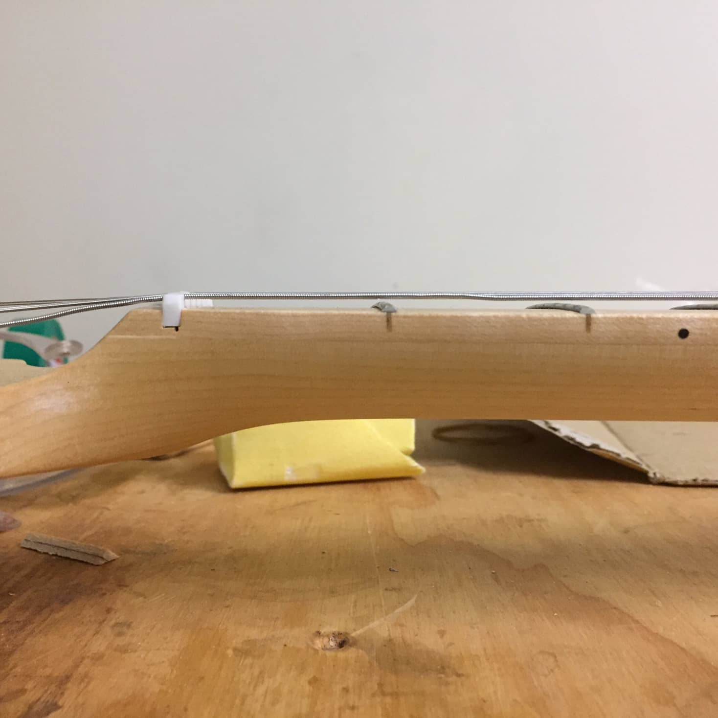

  5. #35
    Attachment 33018
    So I thought about it all night after posting the last one and remembered I wound the saddles right up. So I wound them down and itÂ’s pretty well all good. Still playing around with the the truss rod a bit to get it perfect.
    I think your right with the nut. As you can see in the picture the angle of the low e string from the nut to the machine head is much different than the other strings.
  6. #36
    Sorry, it didn’t attach in the last attempt
  7. #37
    The bottom E will always have the greatest string break angle over the nut, and that's fine. But the other strings do look a bit lacking in break angle. Have you fitted the string trees yet, and if so, where? A picture of the full headstock would be useful.
  8. #38
    No string trees yet, I’ll try to get to that this weekend.
  9. #39
    The *normal position is for the top B/E tree to be level with the A tuner and the D/G tree (if there is one fitted) to be halfway between the A and bottom E tuner.
    *Current Fender practice anyway, though even then there are exceptions. But it really doesn't matter too much as long as you don't have too shallow or too great a string break angle over the nut. The strings just need to be pulled down a bit to stop them buzzing in the slots, but not too much to create excessive friction and make stable tuning a problem.
