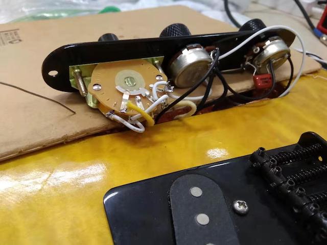

    Received the 'The SG' wiring harness from 920D. I won't have a chance to inspect and install for another month as I'm currently in China and my guitar is in the USA. First impressions are good. They did a much better job soldering than I ever could. Looking forward to trying it. I'll be sure to post my impressions afterwards.

    Looks like you've chosen a non-standard wiring configuration. The pot output is normally the centre wiper contact and the pot input/pickup output gets connected to the outer tab (the other side to the one soldered to the back of the pot). It still works, and allows you to have one volume pot turned down in the 'both pups on' position without the other cutting out, but you will get a different volume level characteristic when you turn the pots down.
    So just make sure you solder the pickup signals to the centre tabs.

    Looks like you've chosen a non-standard wiring configuration....... .
    It 'should' be wired the same as their model SG50-PIO wire harness. Here's a link to it:
    https://920dcustom.com/collections/p...t-pio-caps-new
    Edit: You can see an enlarged version of the photo by scrolling over it.
    May I ask that you take a look and tell me if you see any differences?
  7. #37
    No, it's not wired like that one in the link. It would be if the wires to the switch were moved over to the central lug, where the wire off to the tone pot is connected.
