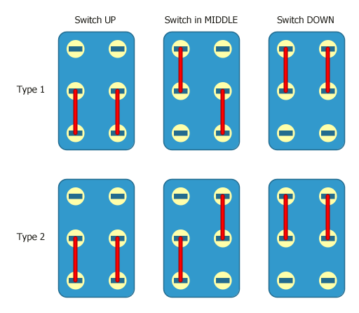

  2. #32
    Have a look at this diagram. It explains how that type of switch is wired. It doesn't matter which type it is

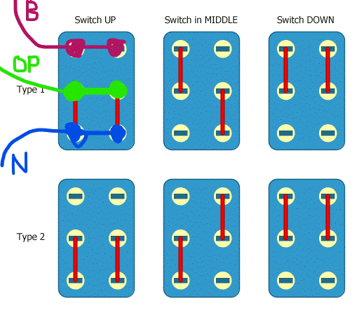

    I've marked up a switch with the necessary connections. Strip the input and output cables back enough so the bare wire can reach across both sets of terminals as shown, and solder them on.
    Green is the output cable running off to the volume and tone pot (the centre blue wire in the PBG diagram).
    The blue wire is the signal cable from the neck pickup, and the magenta wire is the signal cable from the bridge pickup.
    The switch doesn't appear to have a ground tag, so there's no need to run a ground wire to it.
    Note that this wiring is with respect to the switch 'up' and 'down' positions. First mark the end of the switch you want to be 'up' with a marker pen or bit of tape etc. and then wire accordingly. Then install it with the 'up' end facing up in the guitar. If you get it wrong, you only have to rotate the switch 180° to correct things.
