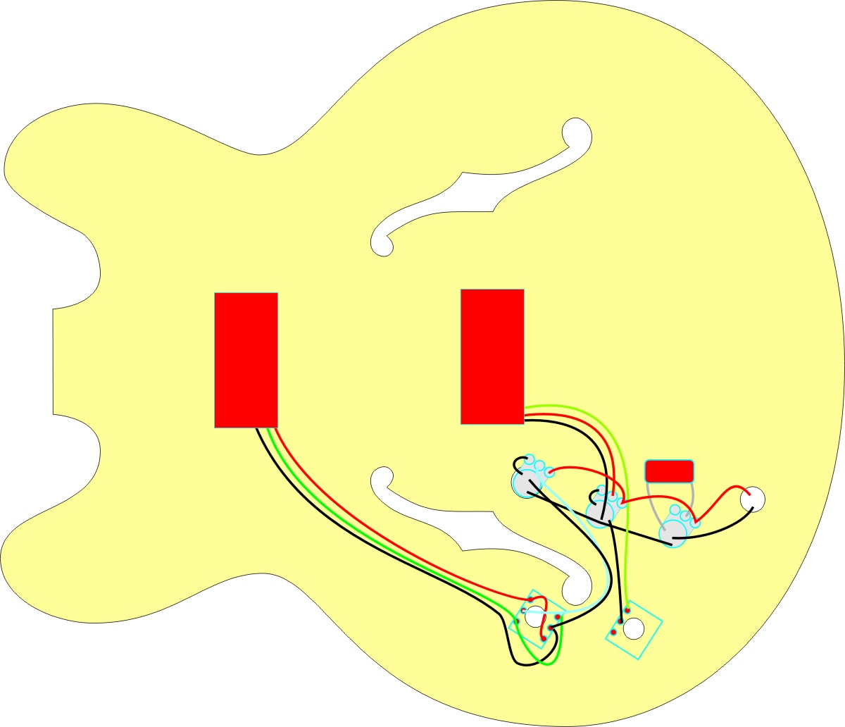

    So it might actually be easier if I put my normal semi-rigid earth between the pots? I'm going to have 3 pots in a line in the top row, and two switches in the bottom. The pots are, if I got the modified hole right, exactly in a line and evenly spaced. The two original holes are 1mm too large for the pots so there's a bit of leeway.

    Indeed. You want something fairly rigid to run around the outside of the f-hole between the top and bottom holes.

    Ahh, that's a good point, I guess I do want to route the wiring clear of the f hole somehow for aesthetics.

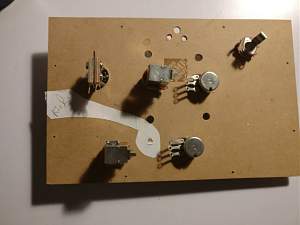

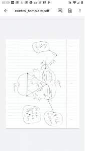

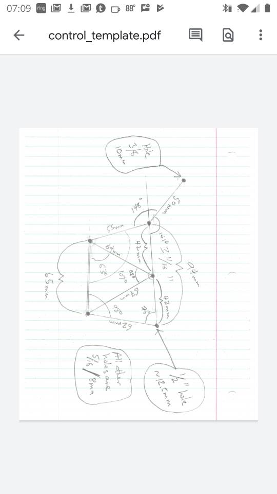

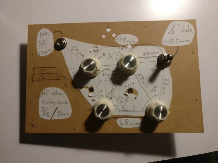

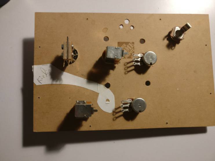

    I am just about to do the same thing. I did a rubbing of the ESB-4 controls, from which I made a template that I kept as a PDF for proportion. I glued that onto a thin piece of pressboard. And that's the template I've been using. I don't know how to upload a PDF to the forum, but if you PM me an email address I'll send it to you. Click image for larger version.
ID:	32551Click image for larger version.
ID:	32552Click image for larger version.

    No worries. FWIW I checked the hole placement and it is identical on my Pitbull kit and on the Fretwire body I am now working on. But YMMV ;-)
    The G&G video was interesting to me in a couple of reasons. First I have one of their bodies. It is VERY similar to the PB body. Pickup position is a little further toward the neck, but the distance between them is the same. Control spacing is identical, center block is too narrow, and the neck pocket was slightly off center--just like my PB kit, and same super thin veneer on top. Biggest differences were that holes for the bridge were drilled slightly too large. Also the f-holes are slightly larger. On the PB I could not fit full sized pots through. On the FW kit I just barely can...but I didn't. I went with minis because they are still easier to get through the hole.
