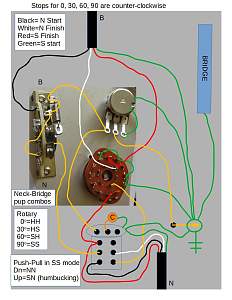

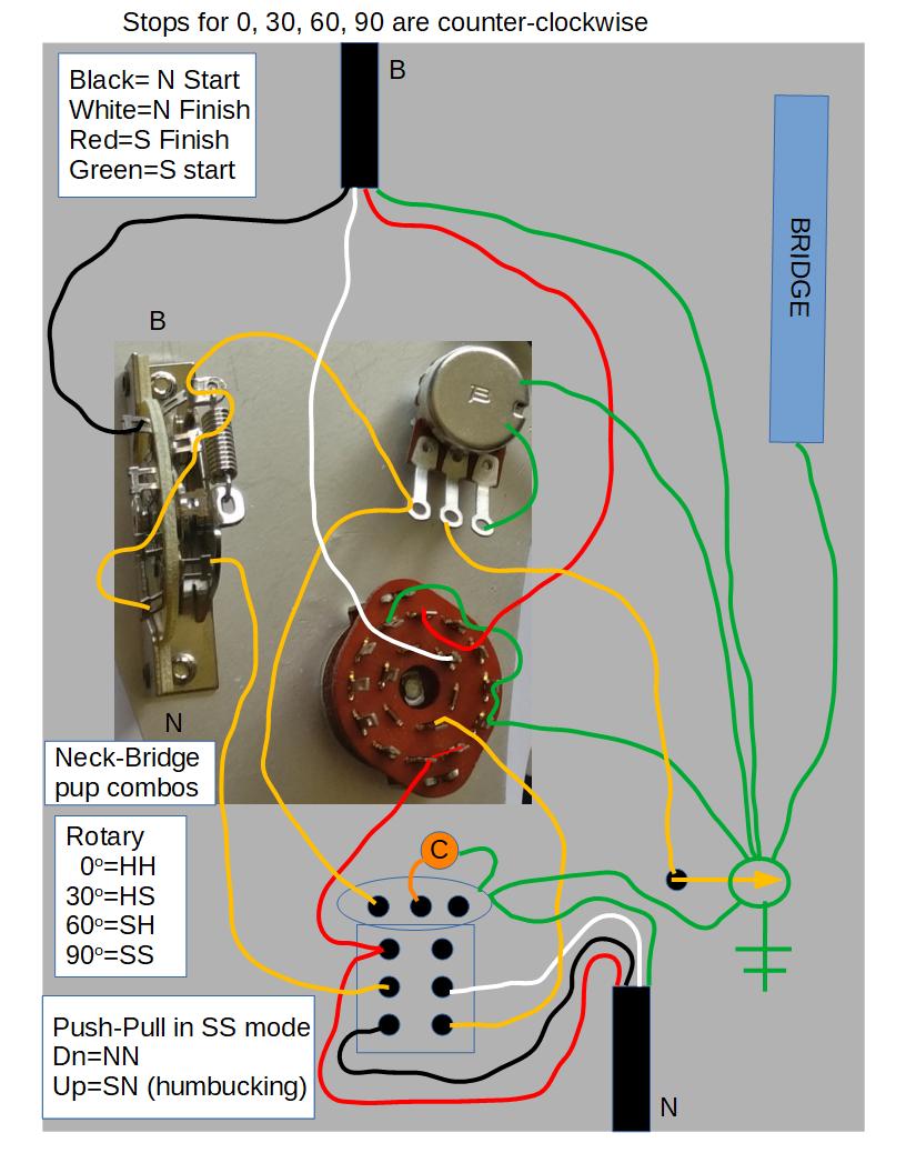

    New tip, and we are off to the races. My paint has now cured long enough that what I should do is sand it... Or put some finish on my neck. But since I don't like to do finish, how better to put that off than to wire the pick guard?
    Not pretty, and the rotary switch in the middle was tricky. I worked and worked on the wiring diagram, and when I finally thought I had it, Weirdbits added a couple of things to improve it.
    Transferred pencil scratchings to a colorful diagram so there would be some hope of my doing this without getting confused. Improvised a bit with the push pull pot diagram because I could not do any one photo of the components that showed all the lugs. Settled for one that showed all the lugs except the ones on the push pull pot.
ID:	34430Click image for larger version.
    The wires leading away are... three green ground wires. One for the bridge, one for the jack and one for the cap. The Yellow is hot to the jack. The orange is the other wire to the cap. I am not sure what values I want in the cap, so I was thinking I would run the wires for the tone cap to the jack cavity so they are easy to swap if I don't like the first value I choose.
    What I am going for is Tele humbuckers with a coil-cut. The four position rotary switch selects HH, HS, SH or SS combinations. The SS setting is not humbucking, which is what I understand to be standard for Teles (although it may be just old fashioned). If you pop up the push pull, it selects the other coil in the Neck pickup, so that it's still SS but now humbucking. Assuming it all works.

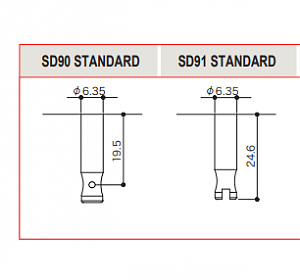

    Gotoh's model name for the 3x3's is SD90. Their name for the 6-inlines is SD91.
    ...Mine look just like the SD90s and not like the SD91s.
    BUT, they are definitely all lefties and they look like they have been trimmed on one or both sides by a monkey with a set of big clippers. NOT machine stamped or cut on at least one side, that is. So I have to assume that someone trimmed these to get them to fit on a left handed fender, decided not to use them, and then sold them on eBay to some schmuck.
    So here's the schmuck's question: I think I should be able to file this down to where they will fit properly, but I am wondering if the difference in the top (seen in the pic as the bottom) will make any difference? When I dry fit them the hole in the post is lower than the nut, so that should not be a problem. I can't think of any reason these won't work, but wanted to at least ask before I commit.
    The reasons for why these tuners are as they are will most likely remain a mystery. The only thing I am sure of is that somebody (not Gotoh) modded these guys. Thanks!

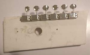

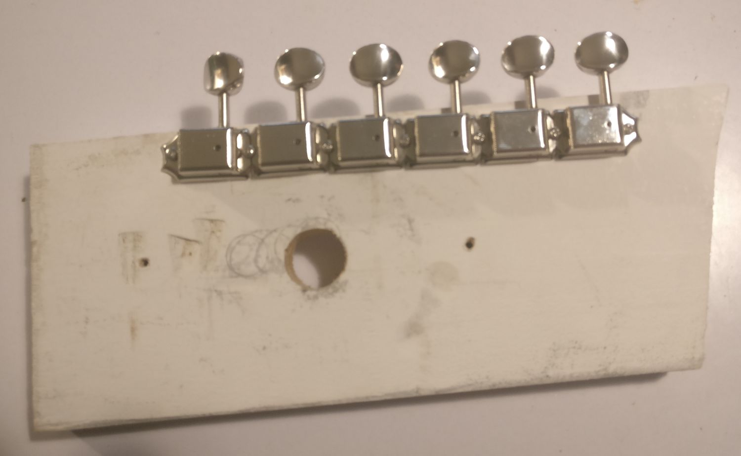

    Waiting for the next zoom call in my home office/studio/garage...so I made a template for the tuners.
    I still have final polishing to do on the neck, so I did not want to try to mount these on the neck for fear of marring the finish. But I wanted to assemble them. Turns out the approach the StewMac guy was using works pretty well, even if you don't use a feeler gauge and micrometer. Pic's a little fuzzy, but once mounted, they look like this is the way they were designed. Thanks for the advice!
