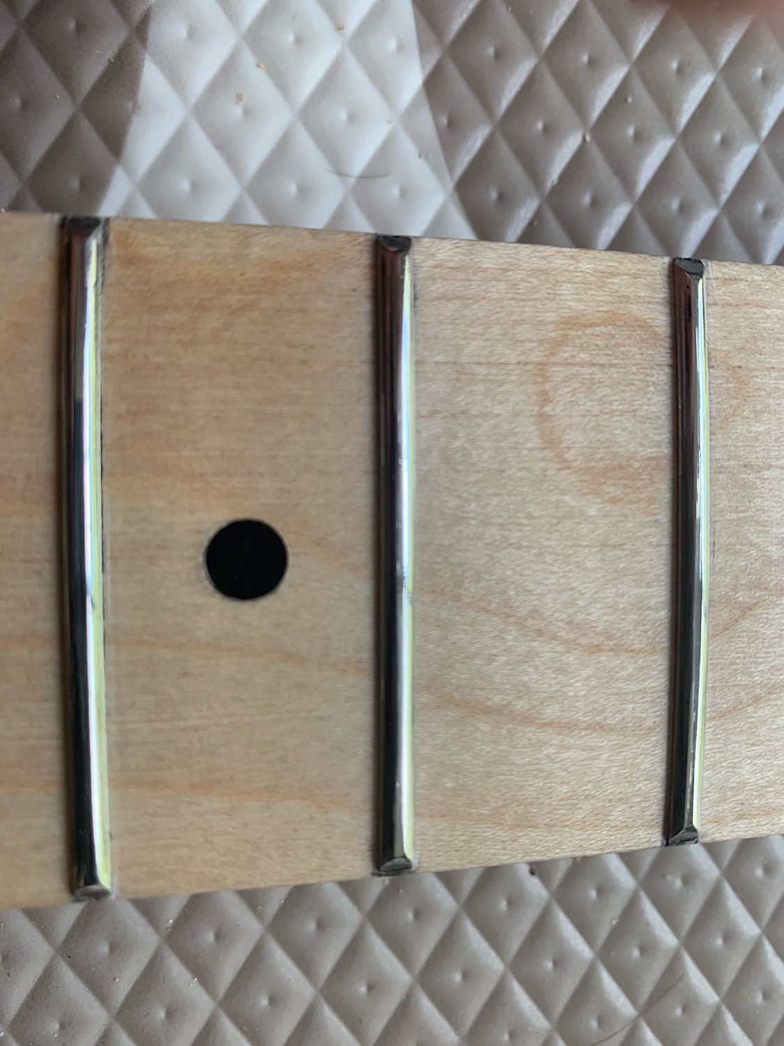

    Looks pretty good for first time fret work. You're on the right track.
    I can see some of the tool marks you're talking about. One thing to consider is upgrading from your "budget" crowning file.
    A good file made with higher quality steel will make a huge difference. The harder steel will have sharper edges on the "teeth" (and keep them longer too). Sharper, harder teeth remove the fret material much more smoothly (and with less physical effort).
    I upgraded to good quality files after my first level & crown, and the next one was soooo much better and easier. I think I ended up re-doing the first job with the new files and the result was chalk & cheese!
    Also, be conscientious of your stroke. Try to get smooth full strokes across the whole length of the fret using as much of the file as you can, not short sharp strokes using just one section of the file. And definitely not a back & forth "sawing" action (hopefully that makes sense)
    Thanks for the insights and makes total sense. An upgraded fret file might be on the cards for the next one. Will do some touch up with some high grit sand paper and try and get out some of the tool marks. I guess there is a learning curve to all off this!

    Take two
    Hi All ,
    So take two on the fret polishing. I really wanted to get some of the deeper marks from the cheap crowning tool out.
    My basic method was start with 600 grit sand paper and work through 800, 1000, 1500 and then polish again using the dremel and some polishing compound. I was carful only to hit the sides as to not effect the crowning process with the sandpaper.I am very happy with the result and now have super smooth and mirror shiny frets. Photo doesn’t capture the difference very well.
    I have also put the last wipe on poly coat on the body of the guitar (around 20 thin coats). And will let this harden over the next 14 days or so, then plan to wet sand and buff with polishing wax and steel wool for a Satin finish.
