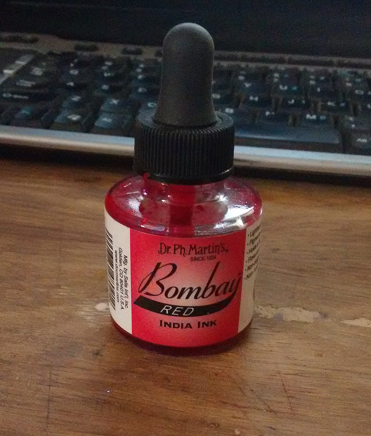

    Hi FunkedOut.
    I was staining Epiphone junior with a water based ink and Tru-Oil lifted it and spread it around.
    I got myself some 'Bombay' brand india ink from a general stationary supplier 'Riot Art Supplies'
    http://riotstores.com.au/browse/art-...cessories.html
    The red wasn't quite yellow enough so I got a bottle of red and yellow.
    Once it had dried, I could apply Tru-Oil over the top and it worked no problem.

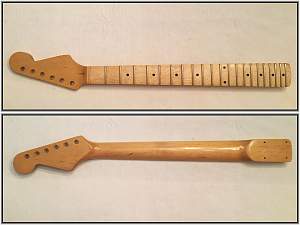

    Here is the neck after 3 coats:

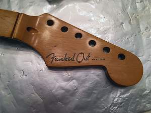

    Really happy I decided to pursue the waterslide decal. Looks great.

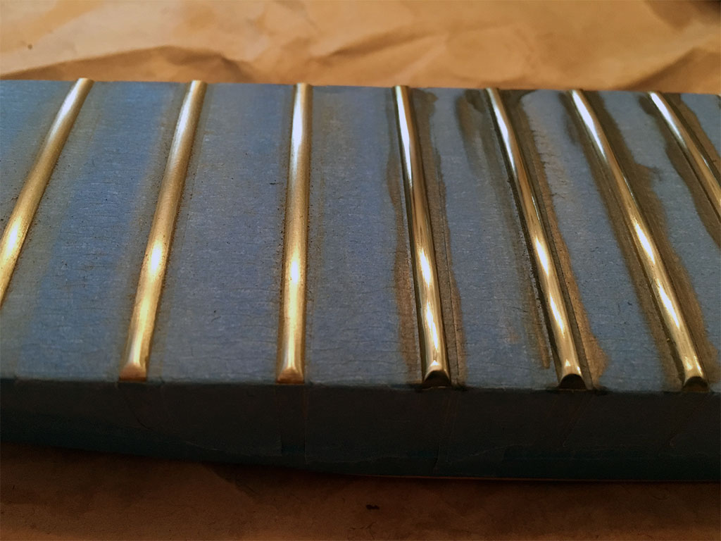

    After a couple more coats Tru-Oil on the neck and over the decal, the neck finish was done.
    I had to go back and remove the finish on the frets themselves and polish again.
    In retrospect, I think it would've made more sense to delay all the fret work until this point in the process. Live and learn.

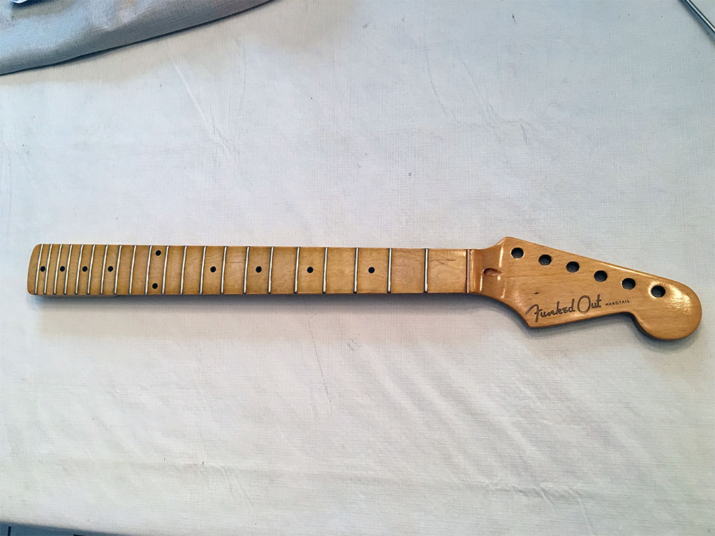

    Here's a shot with a few frets on the left after removing the Tru-Oil with a maroon fiber pad and a few dremel-polished with Red Rouge on the right:

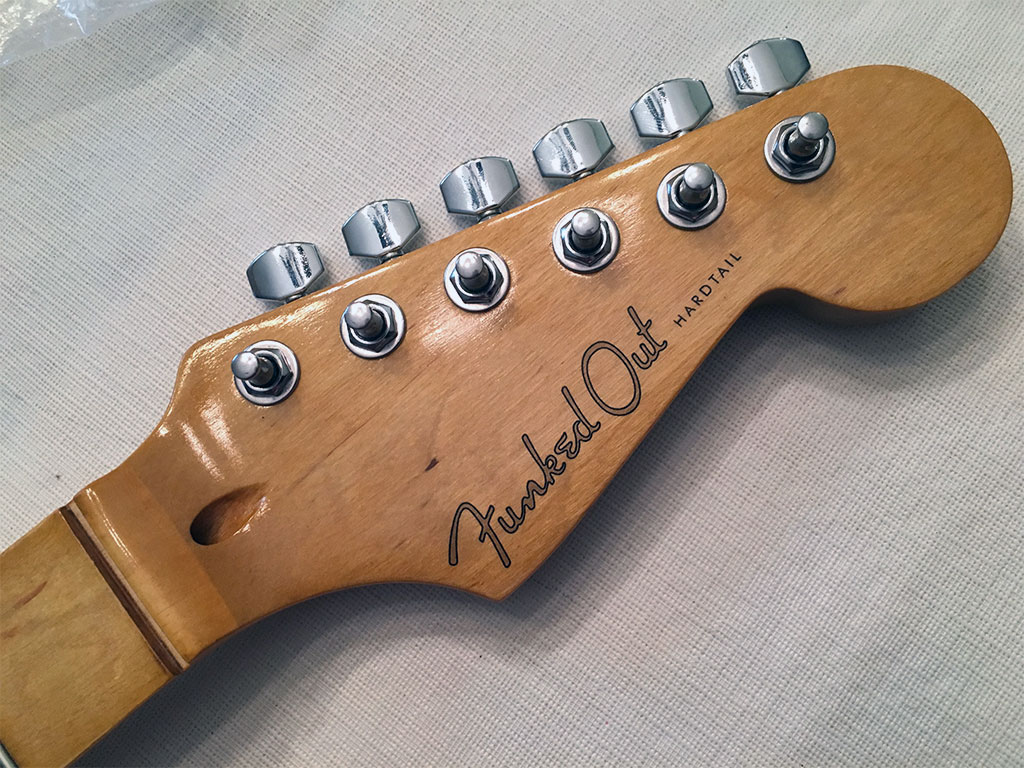

  9. #39
    Tuning machines look way better than holes.

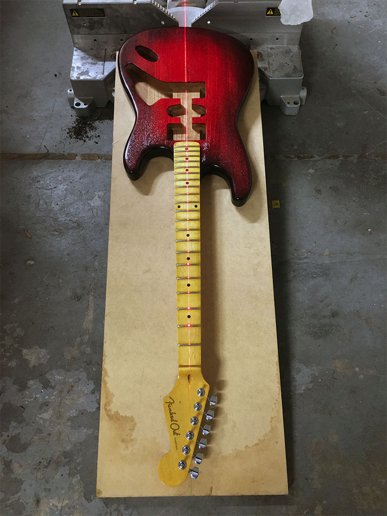

    Now back to the laser one last time to make sure the neck is lined up when it's tightened down.

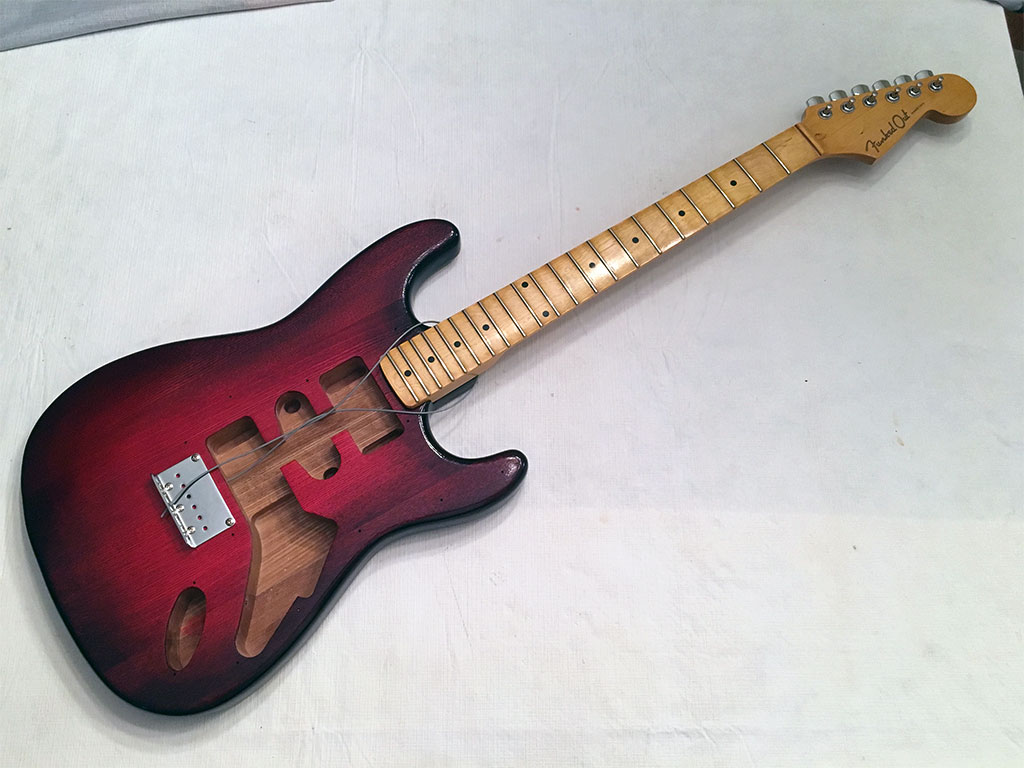

    Got the bridge installed with a ground wire.

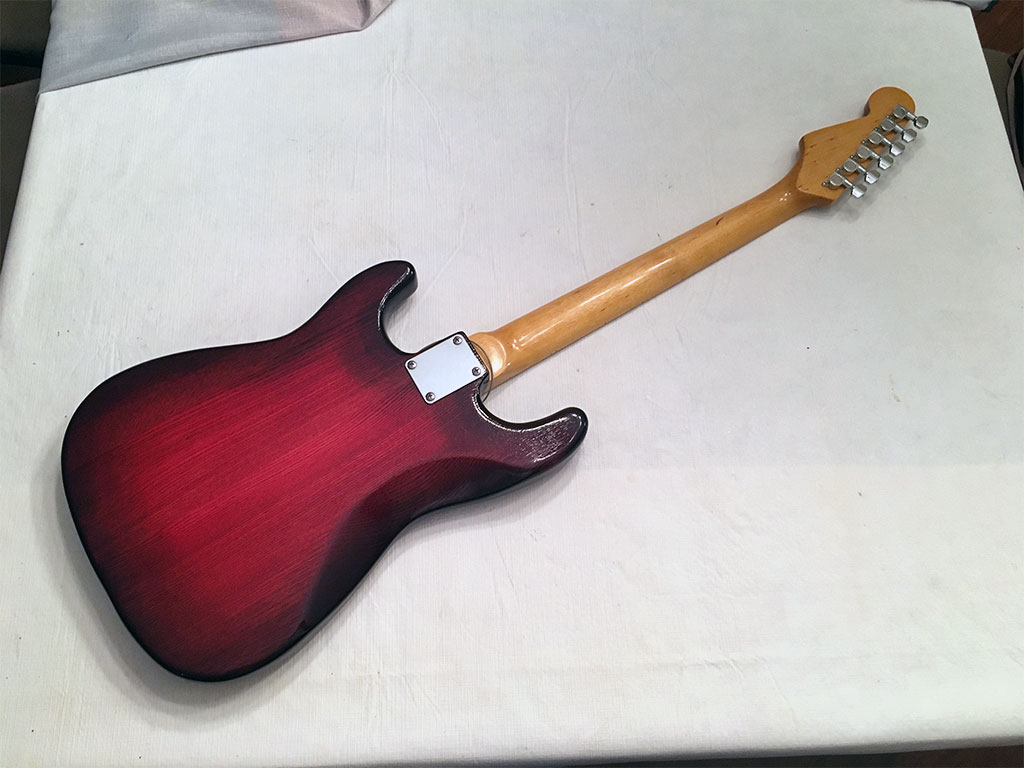

    Just a shot of the back. Calling it a night.
