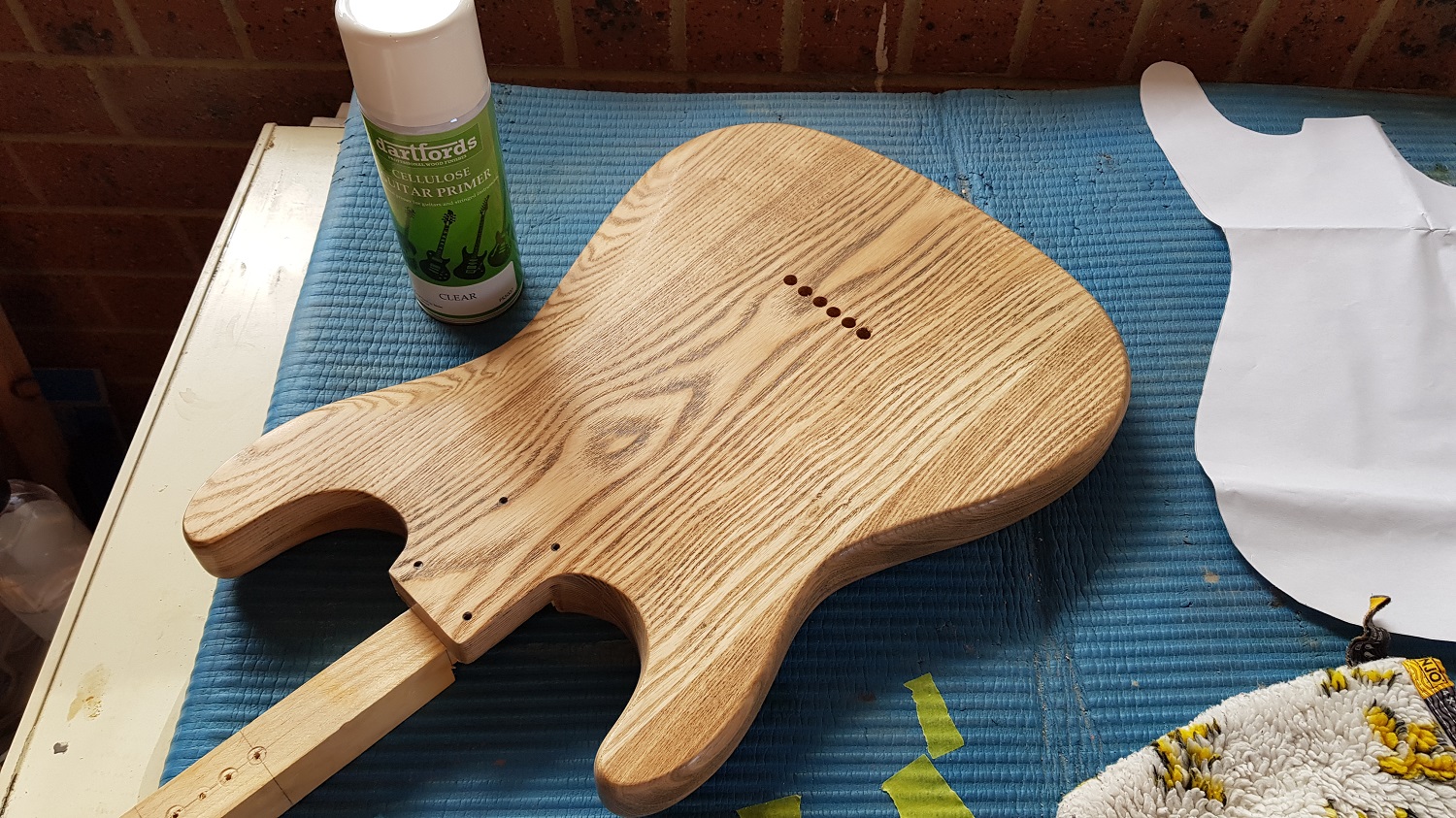

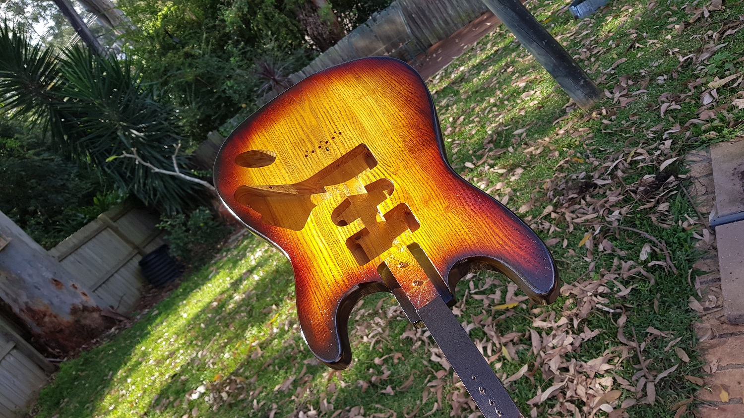

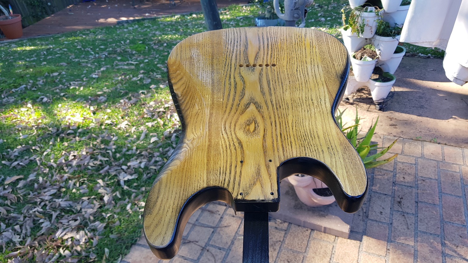

    There are not a lot of GOOD youtube videos that I could find re spraying a sunburst with rattle cans, but there were a couple of stewmac articles and the instructions with the finishing kit are pretty good. So here goes.
    Getting started. First, 3 coats of sanding sealer.
Name:	getting started.jpg

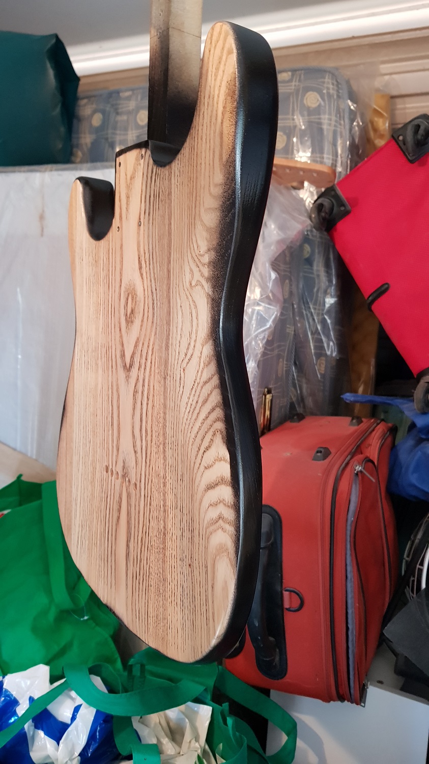

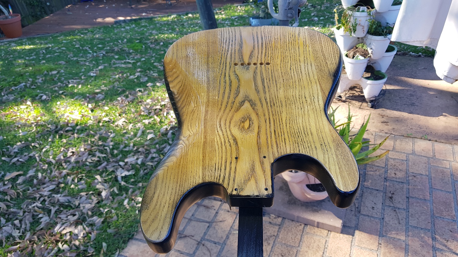

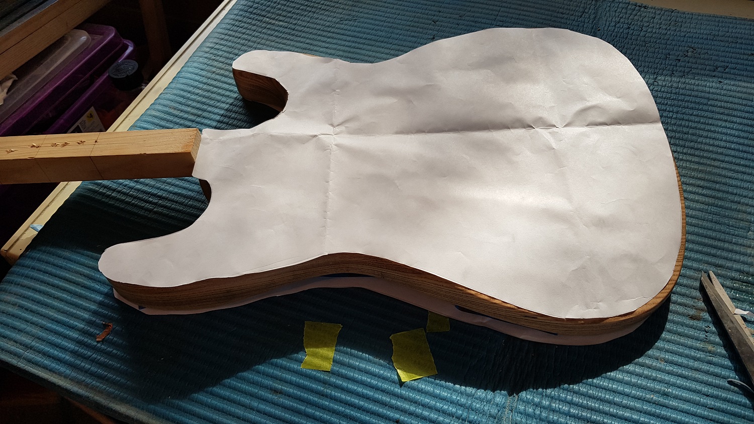

    masked, kind of, for the edges
    Black edges

  3. #33

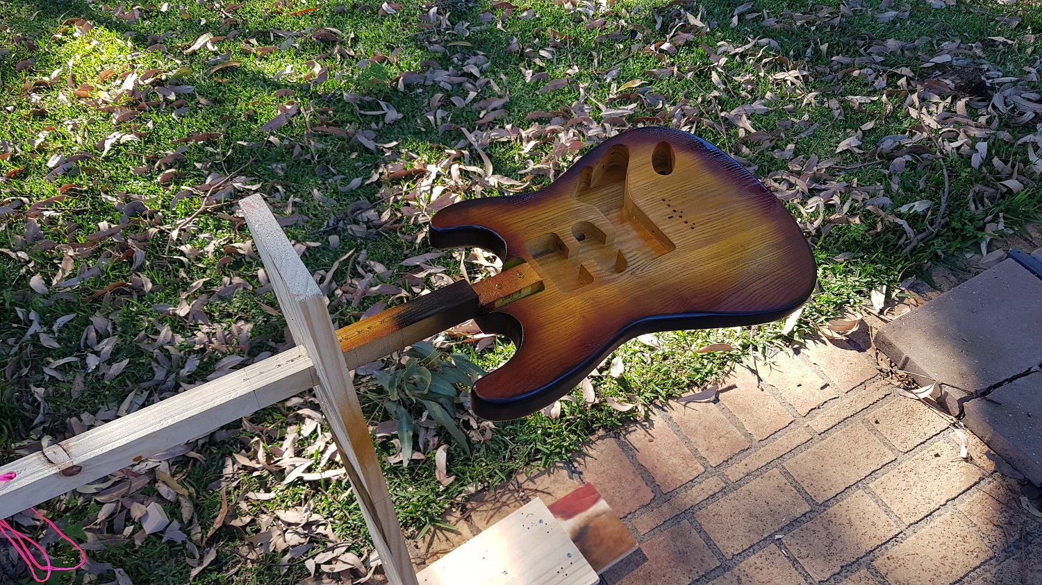

    Next was the centre colour
    One coat
Name:	1xlight brown1.jpg
Name:	1xlight brown2.jpg

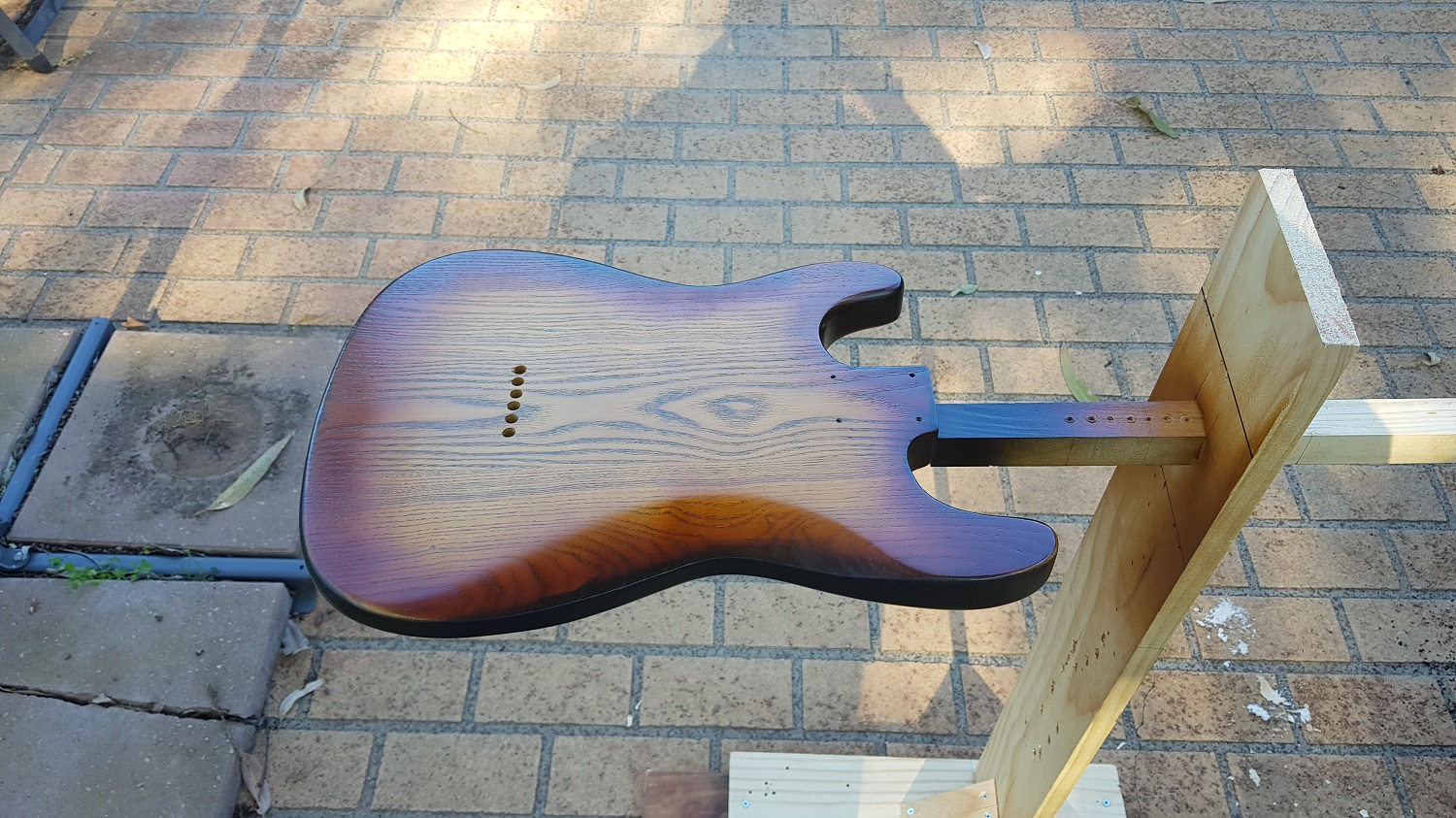

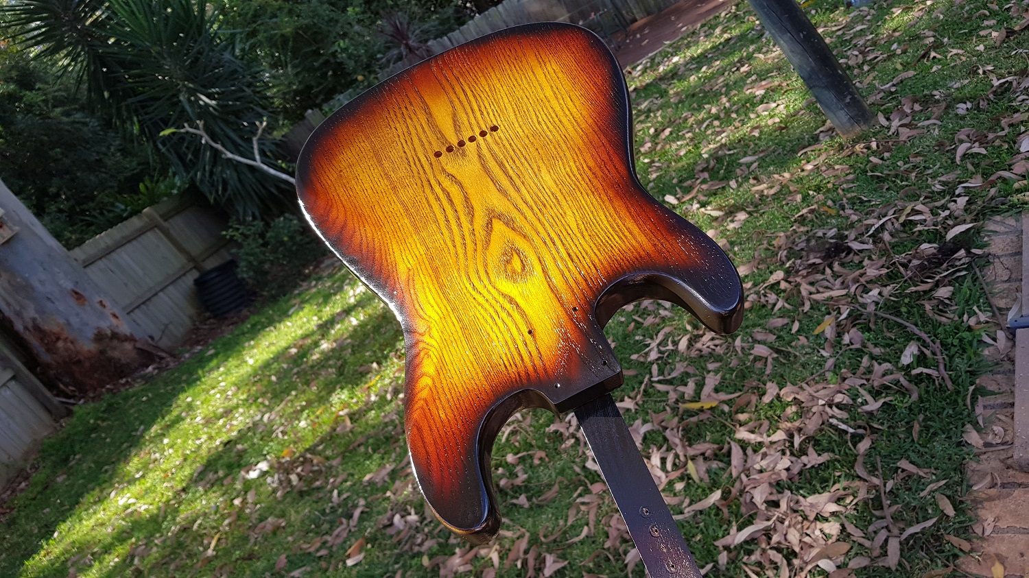

    4 coats
Name:	4xlight brown1.jpg
Name:	4xlight brown2.jpg

  4. #34

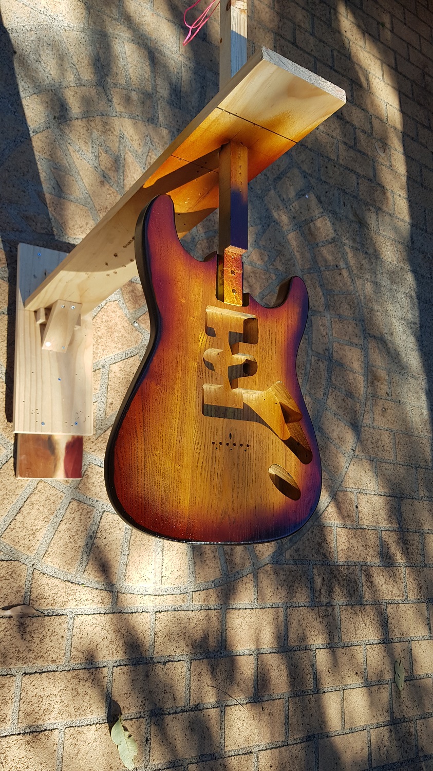

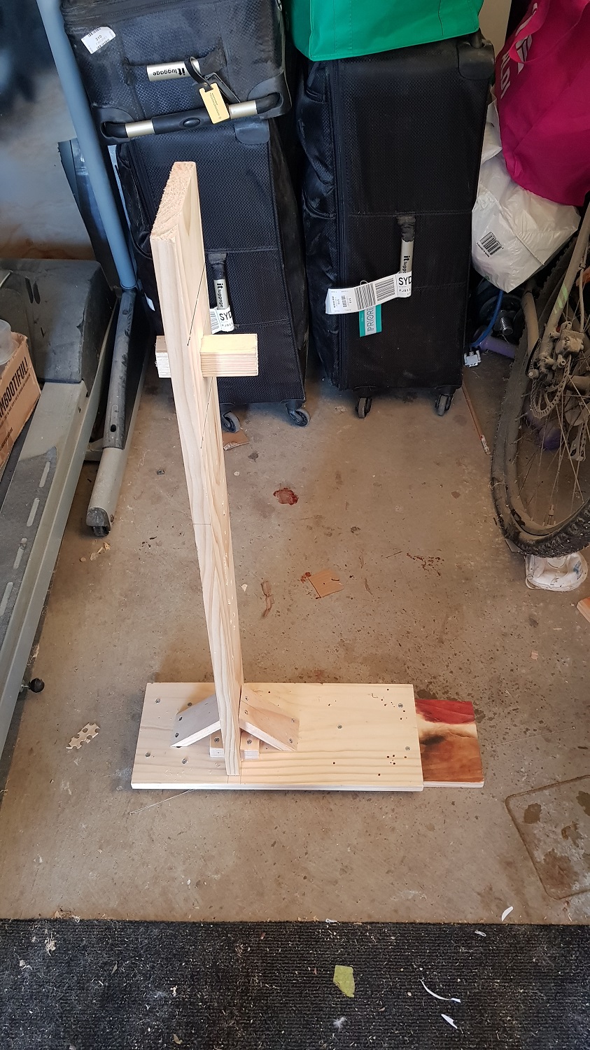

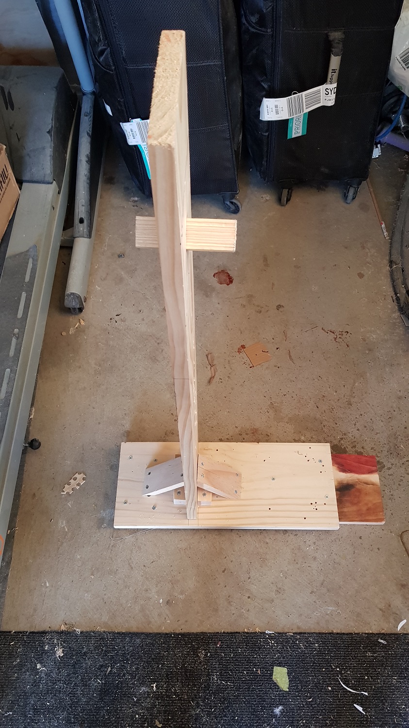

    At his point realised that holding body and spaying was too hard, so knocked up a hands free support
Name:	hands free1.jpg
Name:	hands free2.jpg
    made it so could have body flat or at 45 Degrees
Name:	hands free3.jpg

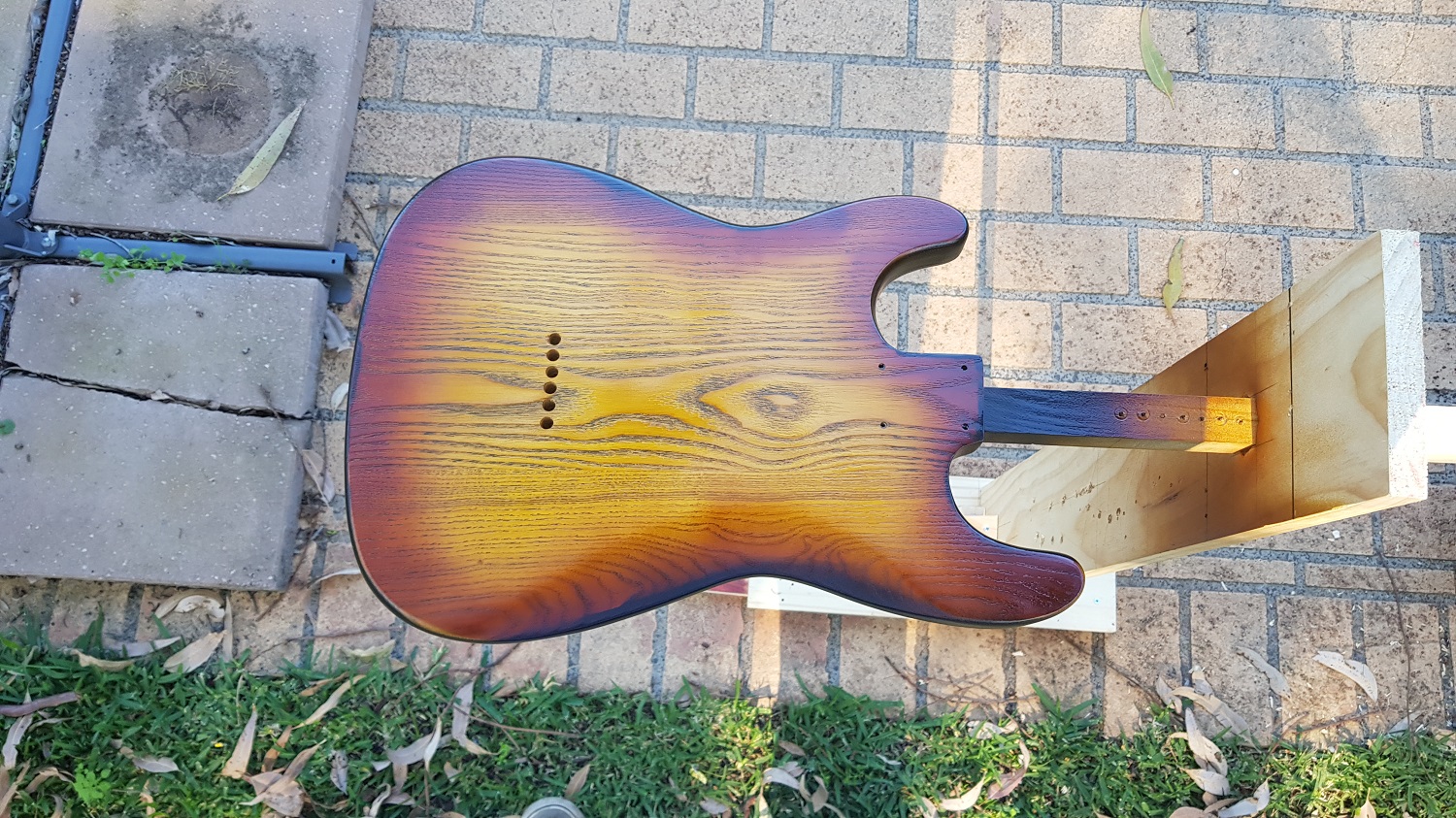

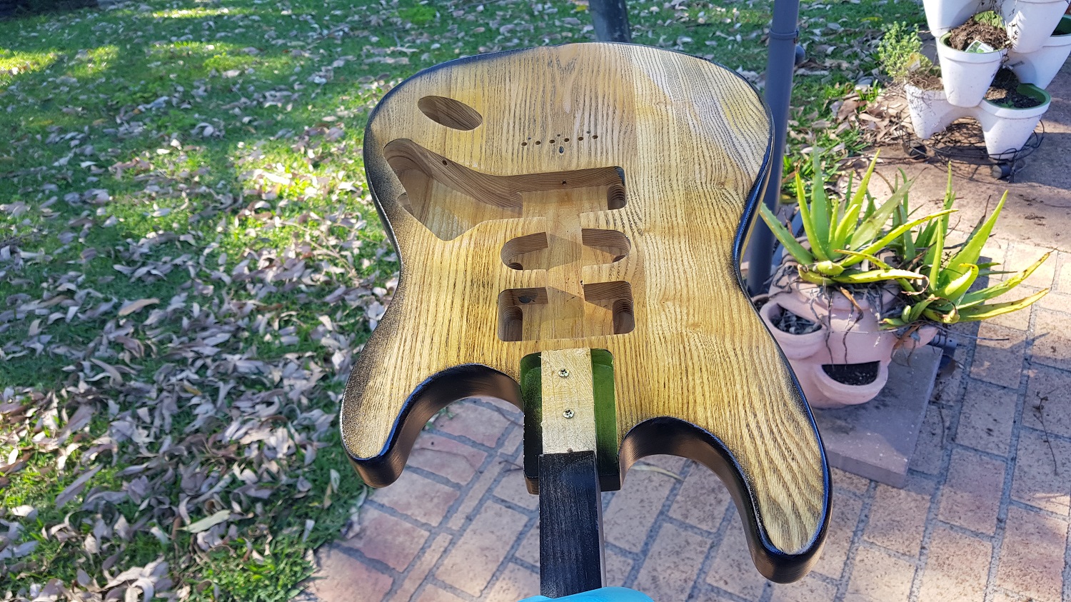

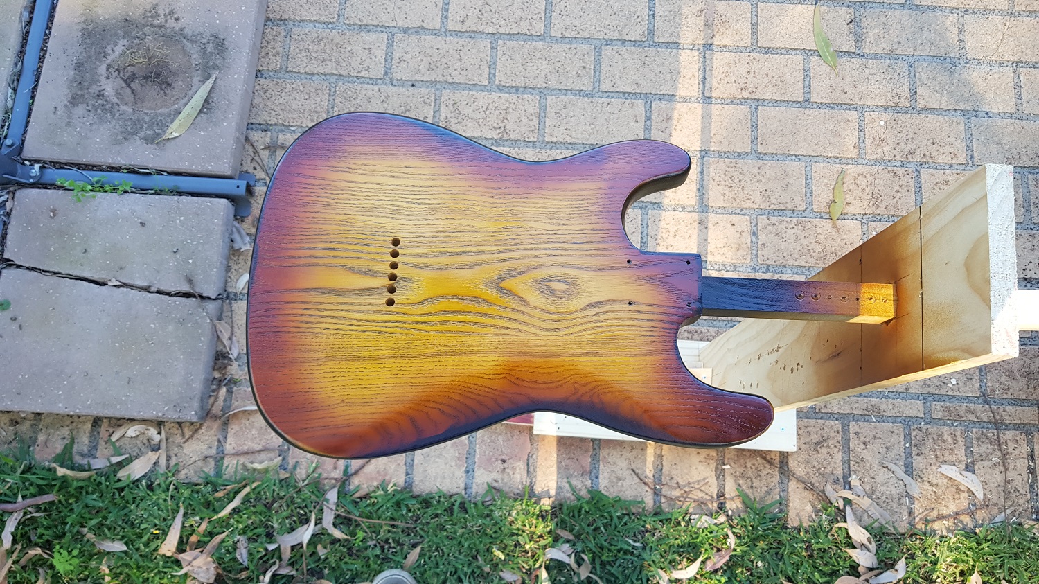

  5. #35

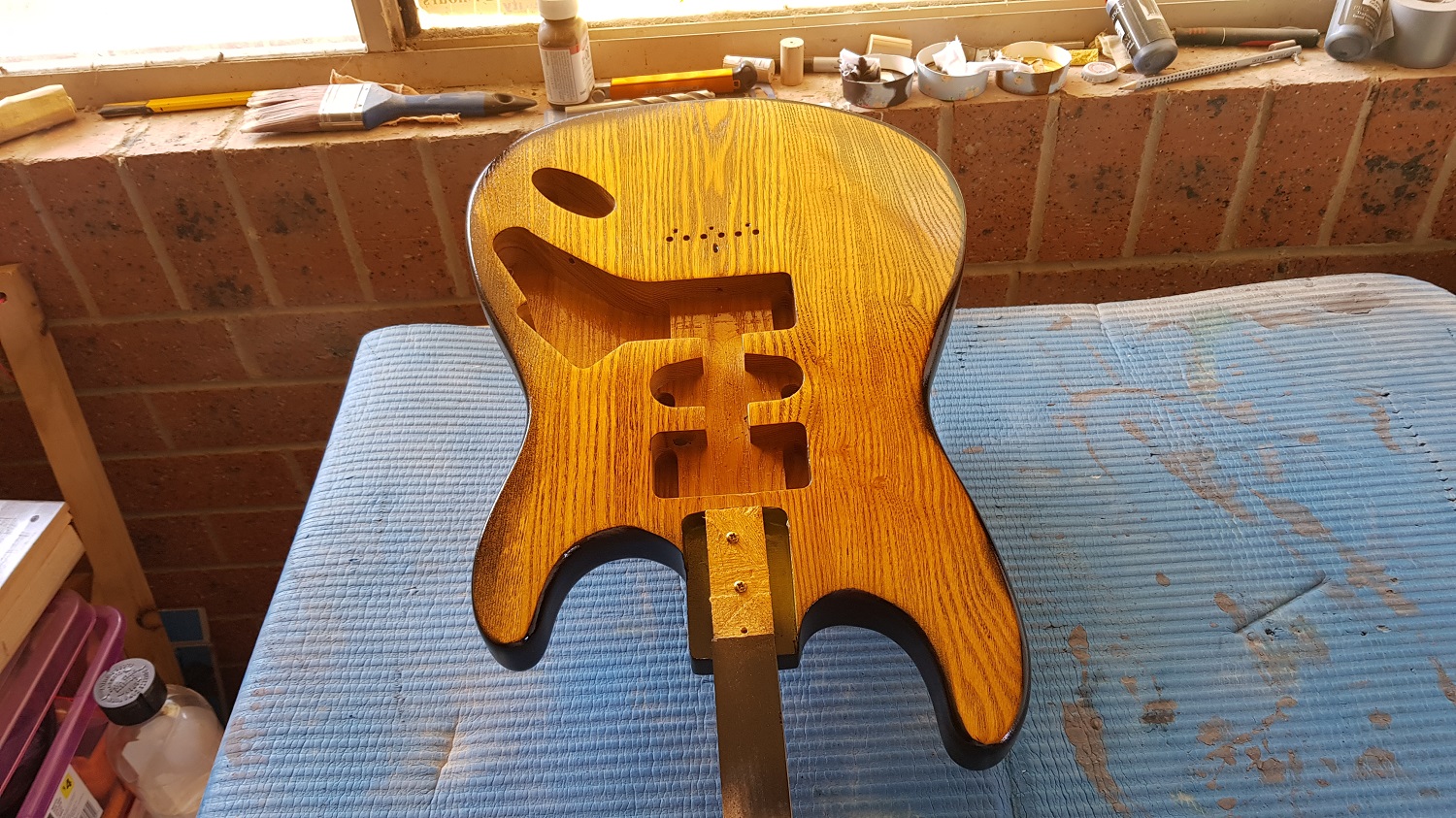

    Next was the dark brown edging

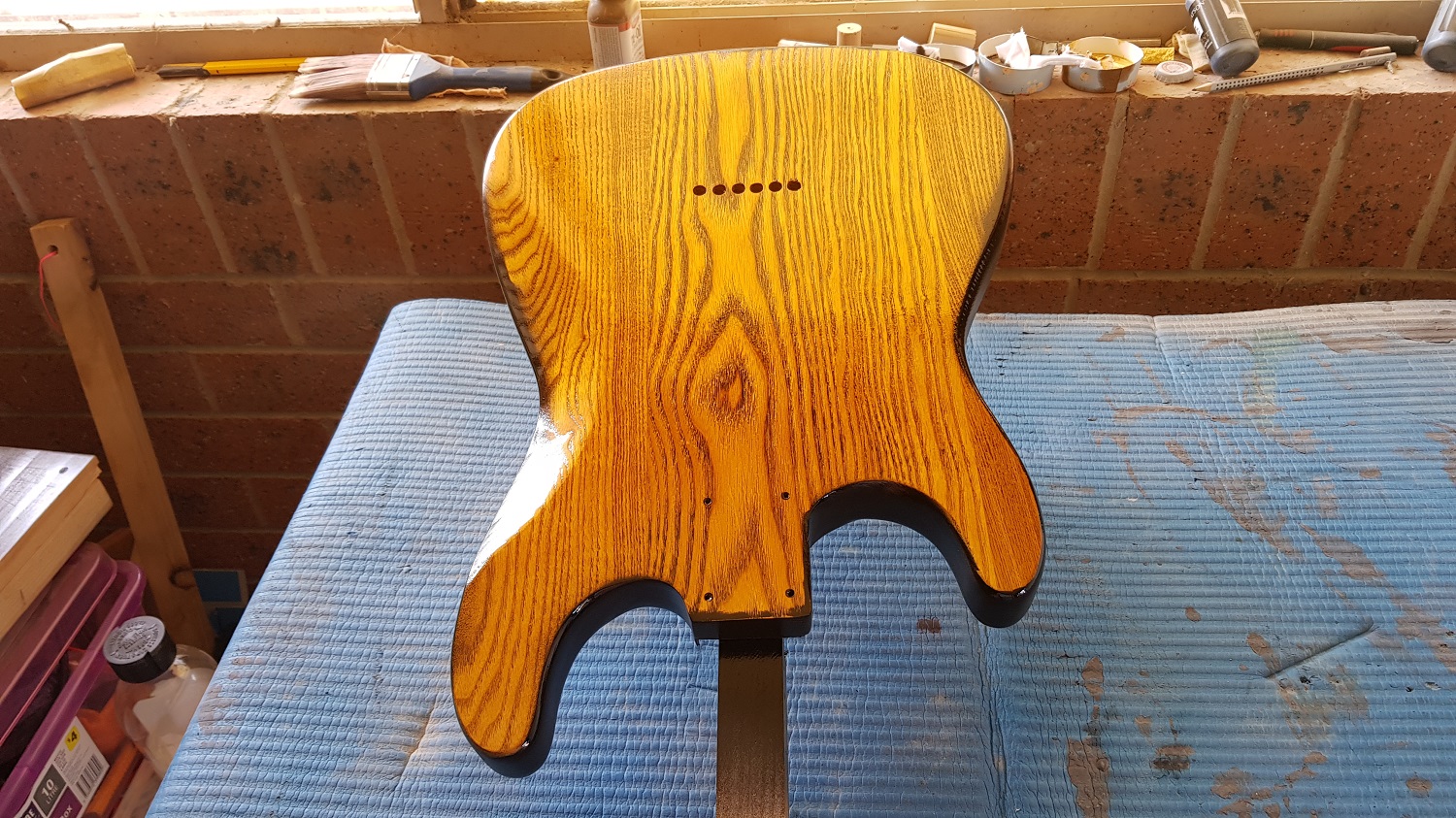

  6. #36
    #6 - sta-1ht - A sunburst Story
    Then a bit of black on the very edge, most nerve wracking bit. Forgot to take a pic of this bit.
    But it was done here :-)

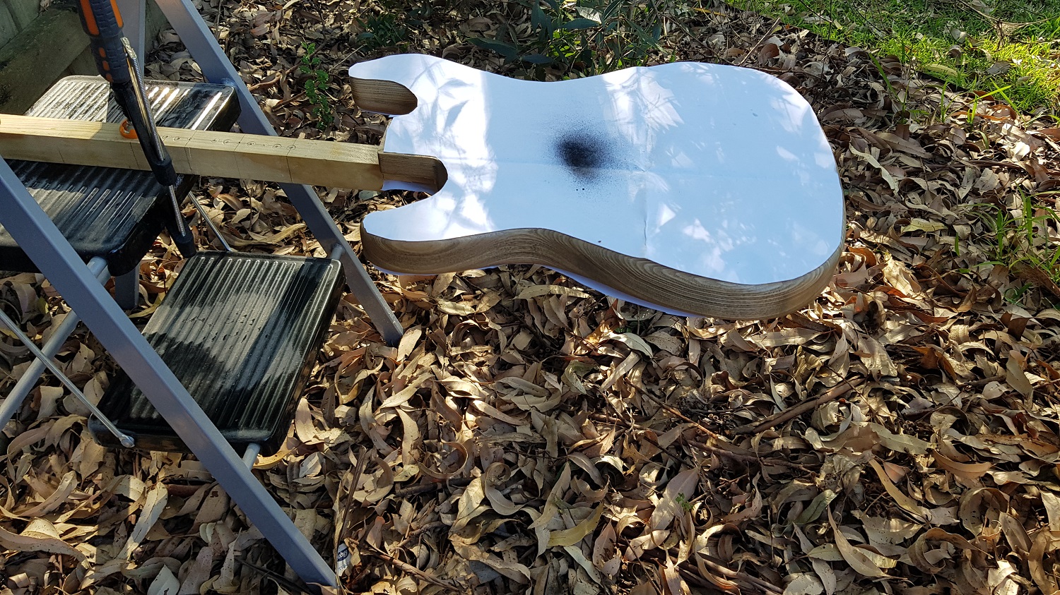

    On to the clear, this is 3 coats on both sides, will let dry and do 3 more, it will then hang for a couple of weeks and I'll start polishing.

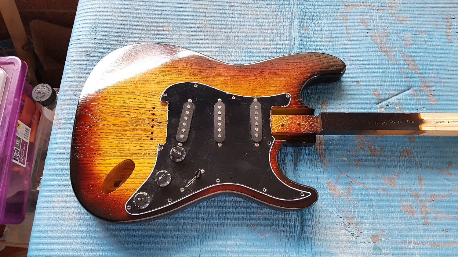

  9. #38
    Assuming I get the setup right, think I'm going to be a happy camper.

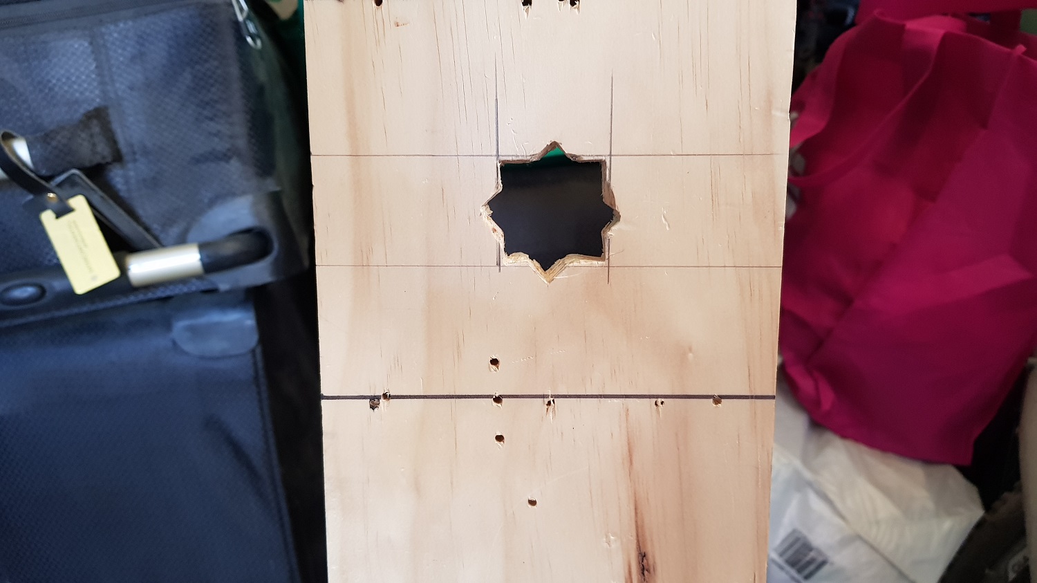

  10. #39
    3,100
    You should be happy. It's a beaut!
    I am curious how you made the hole in your hands free stand. I may want to try to replicate that!
  11. #40
    Thanks, the post attached to the guitar is 30mm, so I used a 32 mm spade bit to drill out a circle then drew round a spare piece of the 30mm post at the angles I wanted and knocked out the corners with a sharp chisel.
