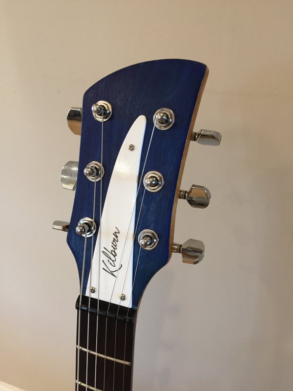

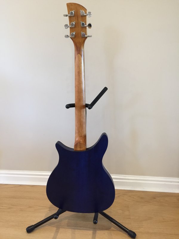

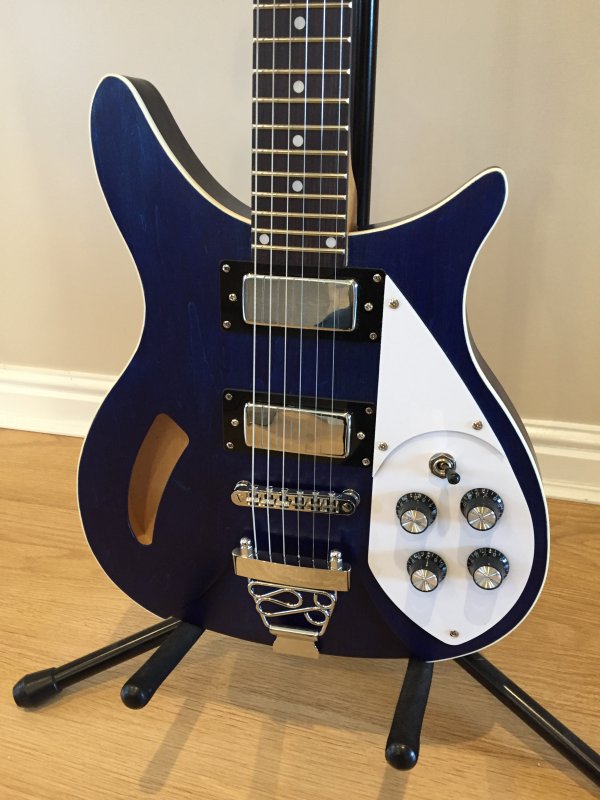

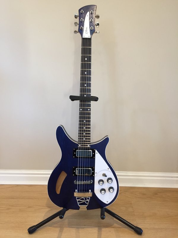

    Here's my first build, hope you like it. All stock apart from the saddle trapeze which I replaced and also the truss rod cover which I made myself by cutting out and shaping a sheet of 2mm perspex. The finish is 3 coats of royal blue stain, 6 coats of finishing oil then a couple of coats of Renaissance wax. Took several attempts to get the finish right and both the front and back were fully sanded back at least twice to start again from scratch but I'm over the moon with how it turned out.

    AndyKilburn’s RC-1
    Nicely done – simple and classic logo, nice consistent colour and gloss – overall a great guitar!
    the royal blue goes well with the white guard, are the tuners upside down on purpose ? Cool looking axe
    A nice, clean and elegant RC. The blue works well for the kit and with the white plastics, although perhaps a touch patchy on the headstock (the wax maybe?). Unfortunately, the tuners are flipped and installed on the wrong sides, so there may be some tuning instability in the long term. The custom TRC looks good with a nice logo. Great neck colour and classy overall look. Nice job.
    Good first build that looks pretty close to Riccy Midnight Blue. Hard colour to get right, particularly on what looks like basswood with just a hint of grain poking through. Would have liked to see back of neck in same colour as I always reckon set neck guitars look best done that way. Bonus points for making your own truss rod cover and personal logo.
    Really impressive. Great colour. The back-to-front tuners distract me though.
