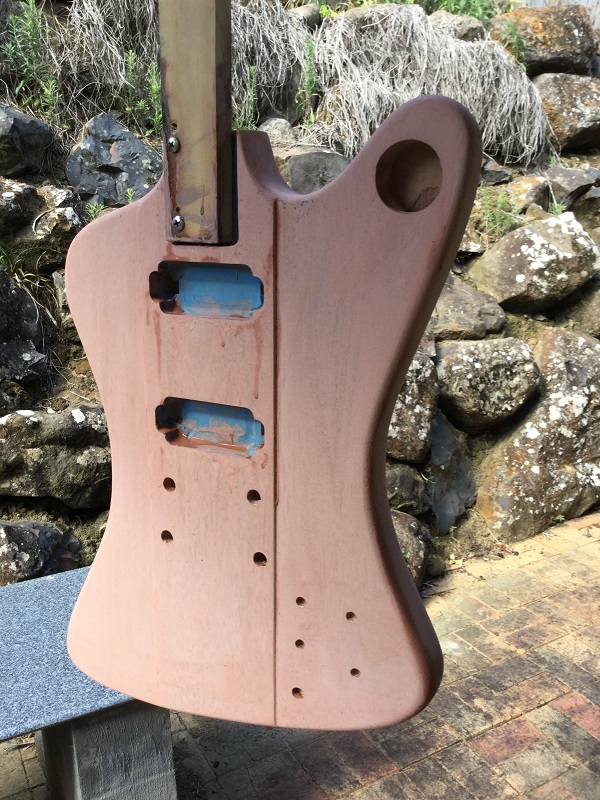

    She has been sanded bare with 60 grit...cleaned up with 80 grit....smoothed with 120 grit....dusted with 180 grit. Now Mahogany timbermate and then 240 grit to follow.

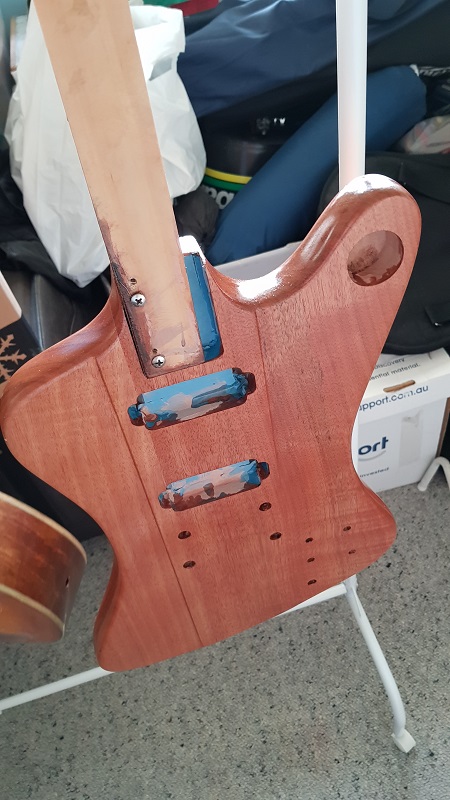

    Sanded and Tru Oil began again.
    Sanded the timber mate off....used the 30 degree day to dry it all out.
    One big soak coat of Tru Oil last night.....one more this morning early....looking great.....may sneak another in tonight.
    The body appears to be two piece....not centred. The bottom bouts are all one piece and there is a section of lovely tiger flame that goes from just under the raised section on the front of the body....down and around the edge and up to the opposite spot.
    Looks so cool. I love how oils pull hidden grain....figure....out of wood.
    Photos after a day driving the Uber car.
    Quiet today.....all worried about the incoming cyclone....no sign on the Sunshine Coast as of 0935am.

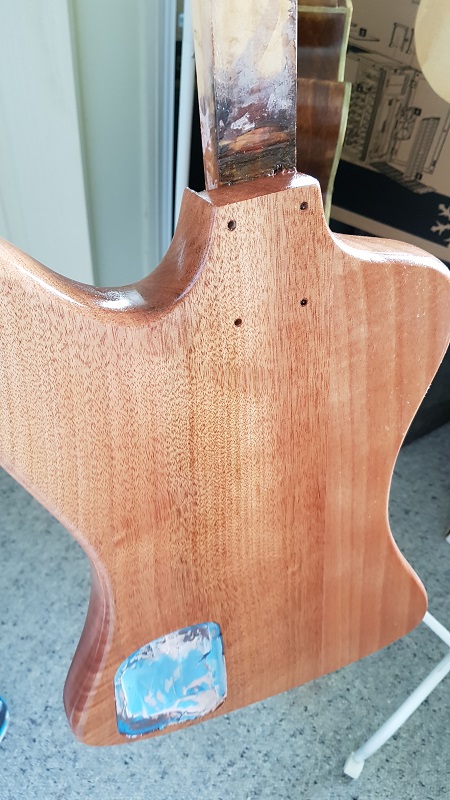

    Uber driving in windy and stormy weather is not good.
    Home now. Another coat on the body...that is 3 coats of Tru Oil again now.
ID:	29401   Click image for larger version.
ID:	29402   Click image for larger version.
ID:	29403   Click image for larger version.
ID:	29404   Click image for larger version.
