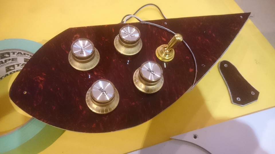

    new tortoise shell scratch plate and truss rod cover for the RC-1 !
    Also discovered that , (if I don't tell the missus, while she's away... ) I can use the bathroom with overhead heating and extractor fans, as a paint drying/curing room. !!!
    Out of the wind and rain, stable temperature, dry, fumes extracted and heaps of good lighting !

    What colour are your tiles now?!
