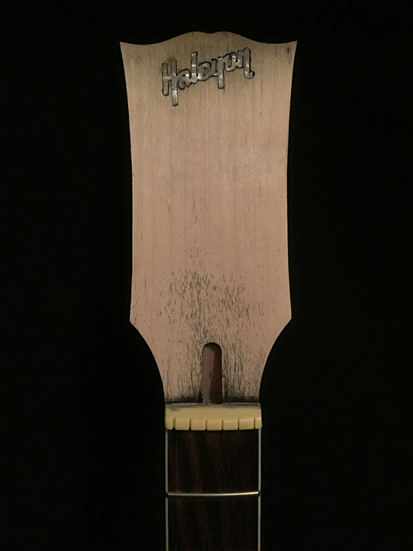

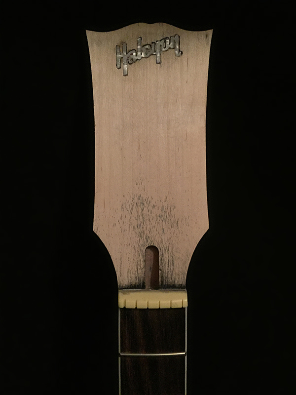

    The overlay was glued onto the headstock and routed flush along the sides. Again, pay no mind to the stain... more experiments
    I used CA glue and ebony filler dust to fit the inlay. Some of the gaps weren't as tight as I would have liked, but this being my first attempt I was ok with it. I don't really understand why, but somehow the combination of the CA glue and the ebony filler dust caused the inlay to turn really grey

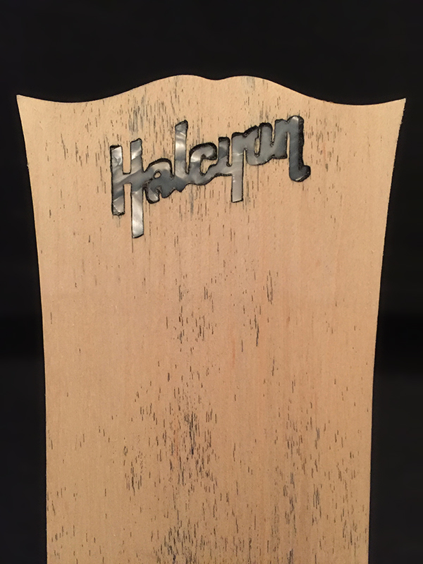

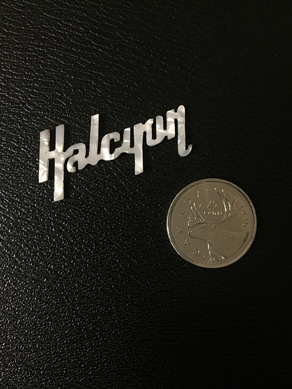

    Unfortunately I couldn't live with it. During this build I tried not to let myself settle if I thought I could do something better, even if it meant doing things over again... which is probably why it took 11 months to complete. So I started over and several hours later I had this (again)
    Speaking of doing things multiple times, I tweaked the shape of the headstock yet again making it a little slimmer at the bottom. Anyway, here's a comparison of the old and new inlay. They both came from the same sheet of celluloid, so you can see something definitely went wrong with the first one

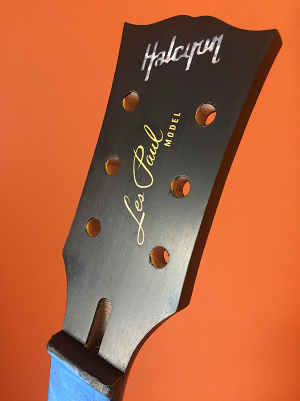

    SEPTEMBER 2017
    And now it was time for everyone's favourite job... sanding!
    I sanded the overlay using 400 grit, then masked off the fretboard, the end of the neck and the top of the body. Next I grain filled the back of the body and neck with watered down wood filler... this probably wasn't necessary. I sanded the back and sides of the body and neck with 220 grit, dampened it to raise the grain and repeated this process a few times. Lastly, I refined of the shape of the transition where the headstock meets the neck.
    Using a 25/64" bit I redrilled the tuner holes
