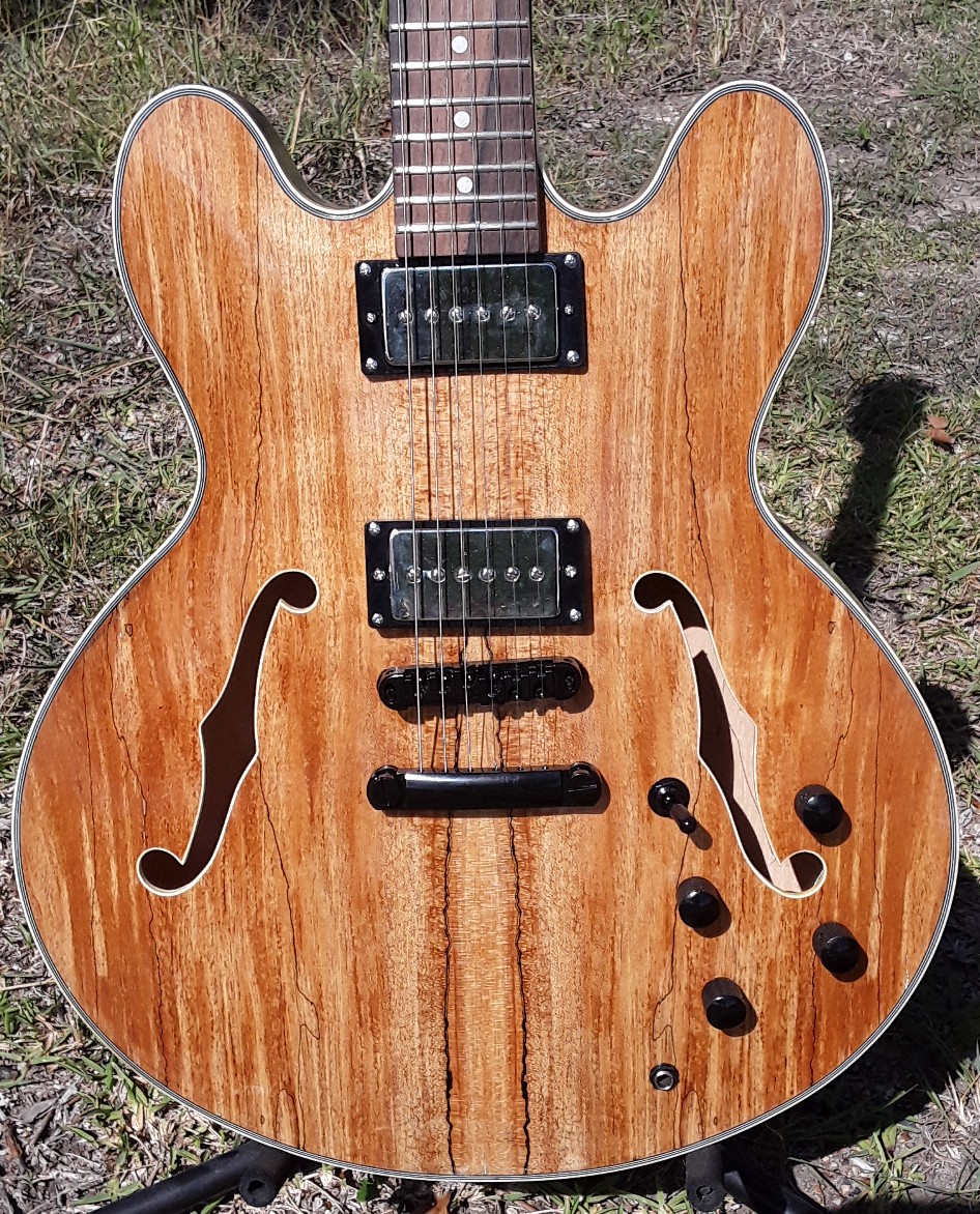

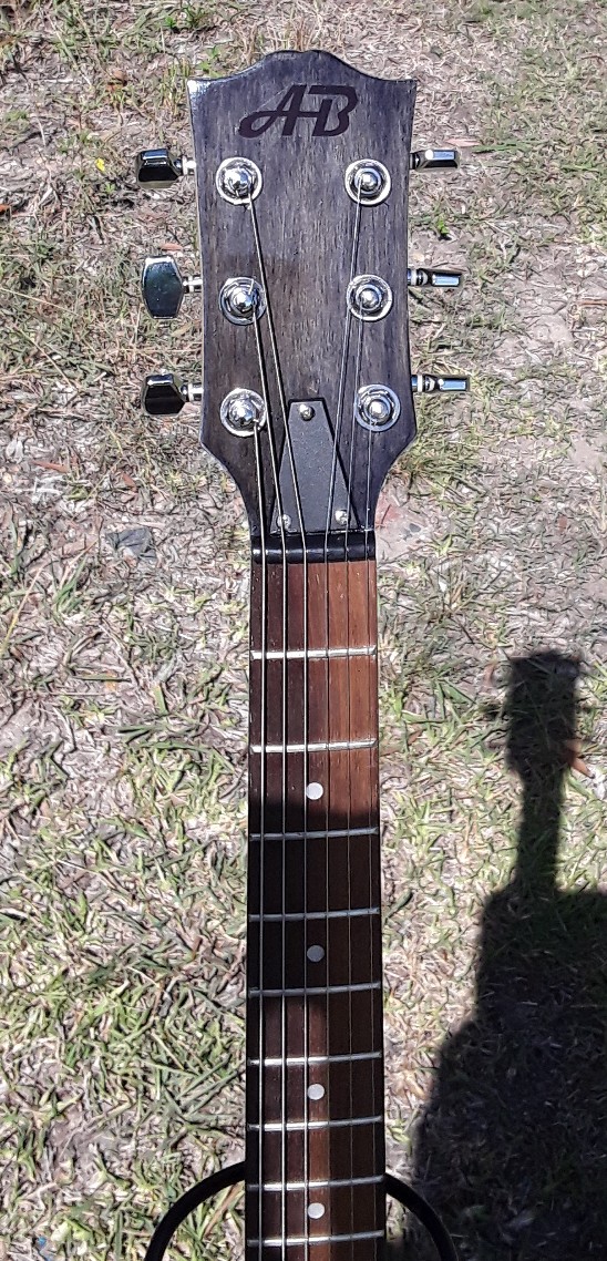

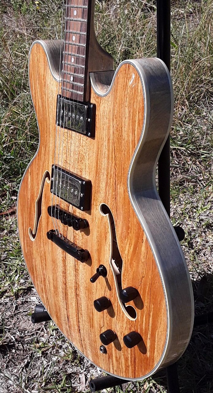

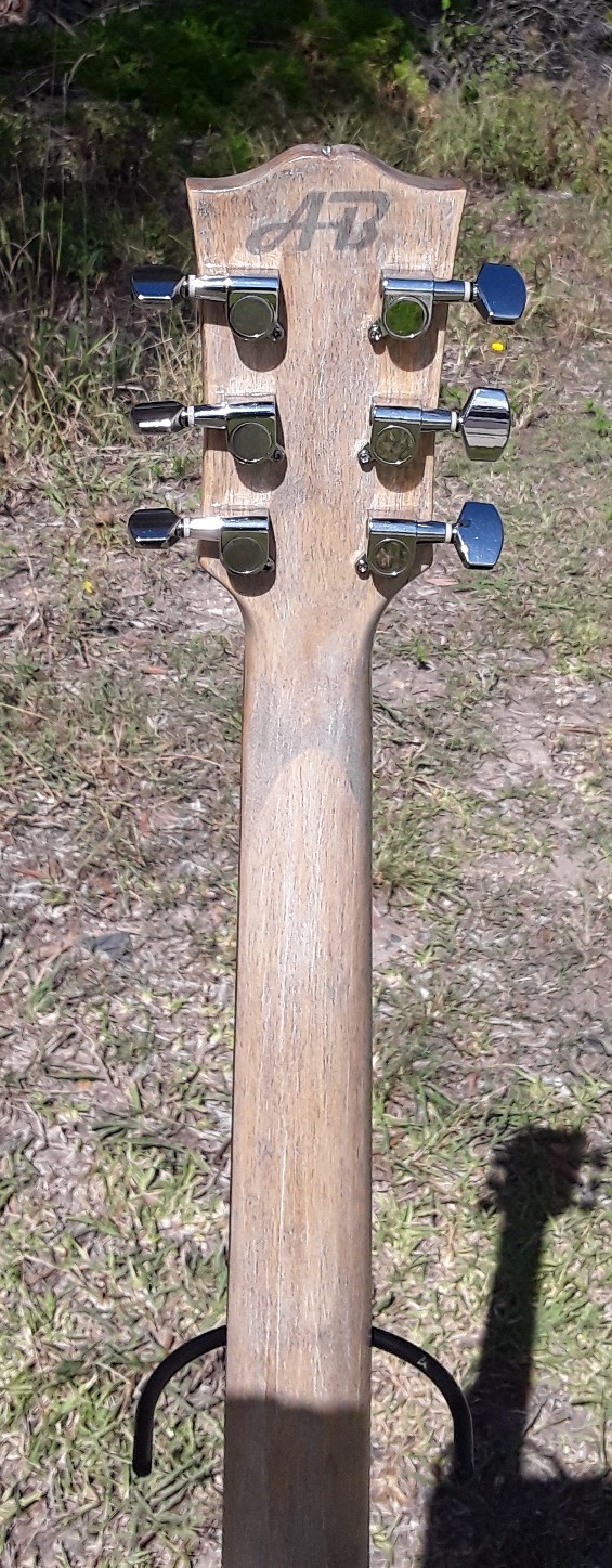

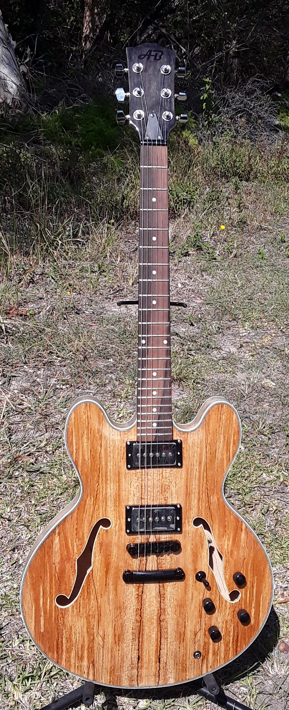

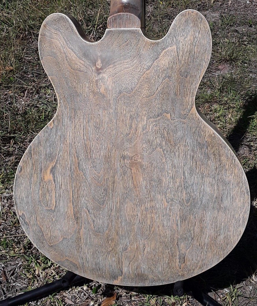

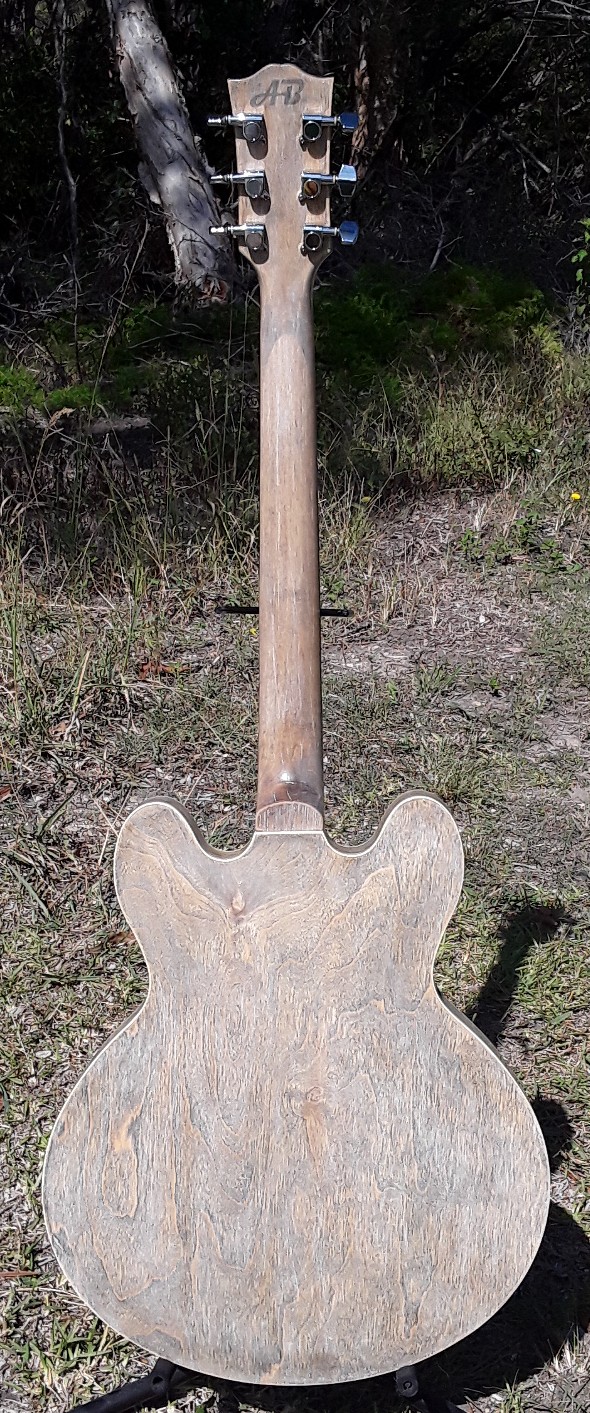

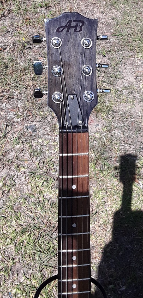

    All done and adding to the list this month. ive never really liked single coil pickups but this might change me, sounds as good as it looks.
    Finish back sides and neck ebony timbermate sanded back and liming white sanded back, true oil over top
    Headstock some black stump
    Electronics tonerider reble P90s, bournes minis for vol, kit pots on the tone orange drop on the neck kit cap on the bridge
    Black roller bridge and knods and switch
    Starndard kit tuners and nut which ill replace later when i change the strings
    All up I'm really happy with how it's turned out and a nice change from all the humbuckers Click image for larger version.

    Nice Adam, a very different finish you have achieved on the back and sides
  6. #35
    awesome build Barnesy love the spalt really suits this model. How's it sound and play ?

    Thanks wokka, just had it running through a Marshall and sounds as good as the others I've built so far. Its very crisp soundingClick image for larger version.
