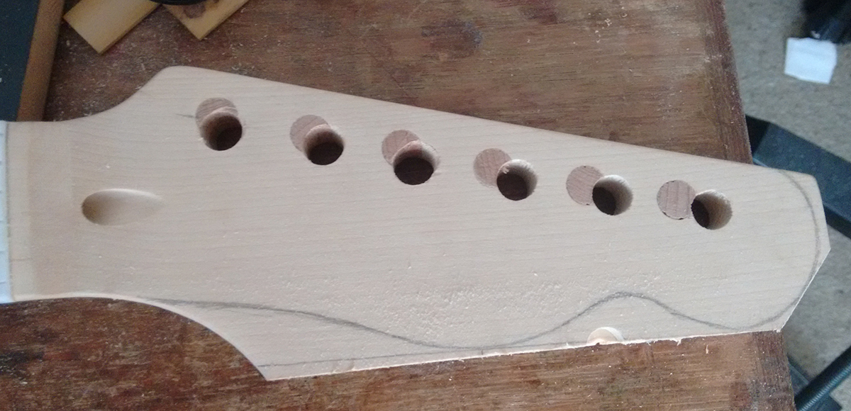

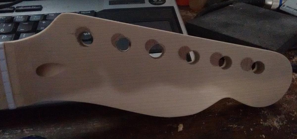

    I've just fitted a replacement neck to a friends Tele for him. I don't know where he got it from, eBay probably, but the headstock was longer than normal and the post holes too far apart to fit vintage tuners as I'd have liked.
  3. #33
    The holes on this neck were mostly 24mm apart (a couple were 23mm).
    A couple of templates that had the measurement spelled out were 25mm (1 inch).
    I lined up the 'vintage' tuners (there is one screw between each of them) and 25mm looked about right.
    cheers, Mark.

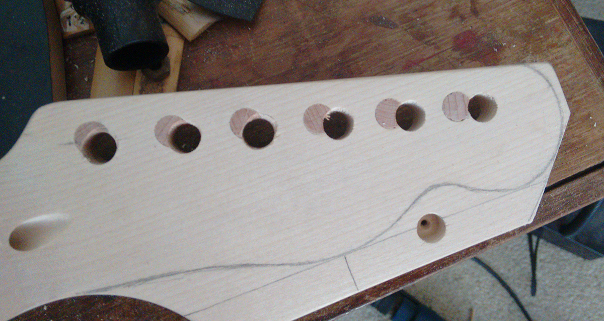

  6. #36
  7. #37
    Cheers Simon.

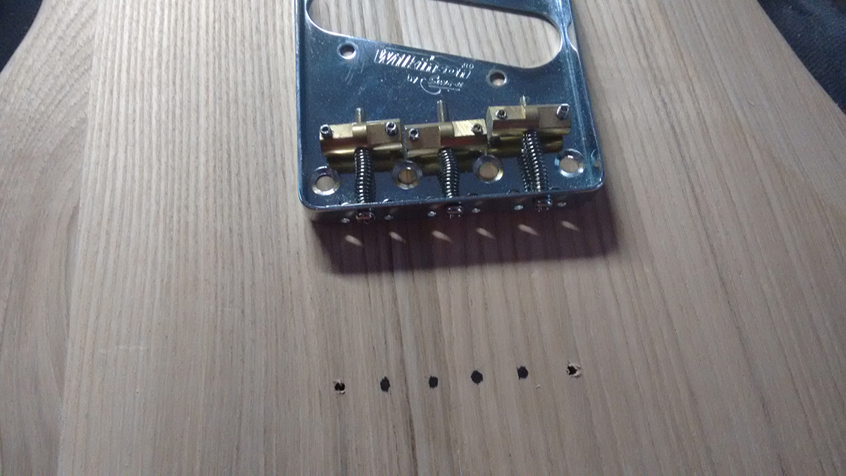

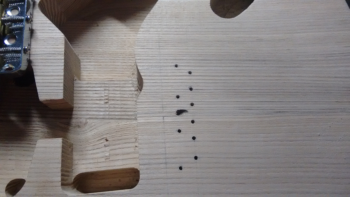

    Well continuing on.Click image for larger version.
Name:	08 pilot holes.jpg
ID:	25108bridge and string through holesClick image for larger version.
Name:	09 Bridge holes.jpg
ID:	25109string through holes (back)Click image for larger version.
Name:	10 string holes.jpg

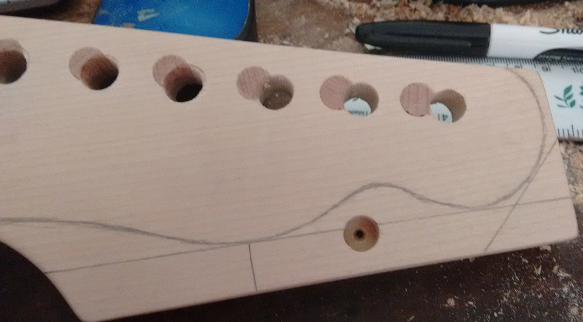

ID:	25110Tuner is too close to the edge. Due mainly to this I've decided to ditch the 'vintage' tuners and use the kit ones.
Name:	11 close to the edge.jpg
    cheers, Mark

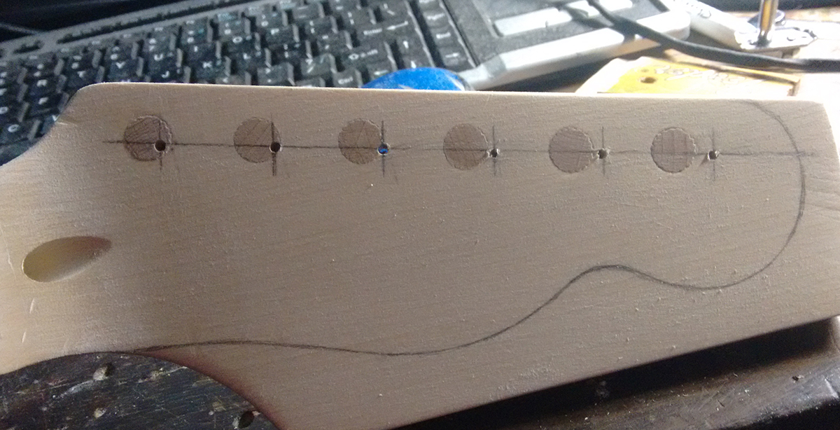

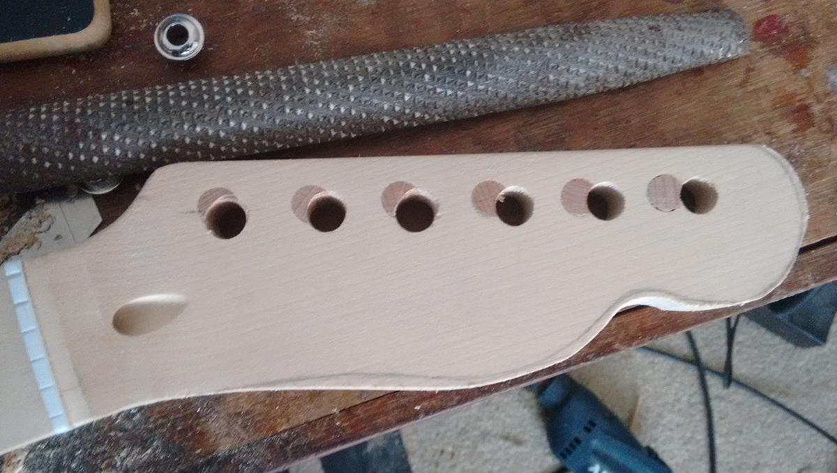

  8. #38
    headstock shapingClick image for larger version.
Name:	13 marking.jpg
ID:	25118Click image for larger version.
Name:	14 cut one.jpg
ID:	25119Click image for larger version.
Name:	15 cut two.jpg
ID:	25120Click image for larger version.
Name:	17 rasping.jpg
    cheers, Mark

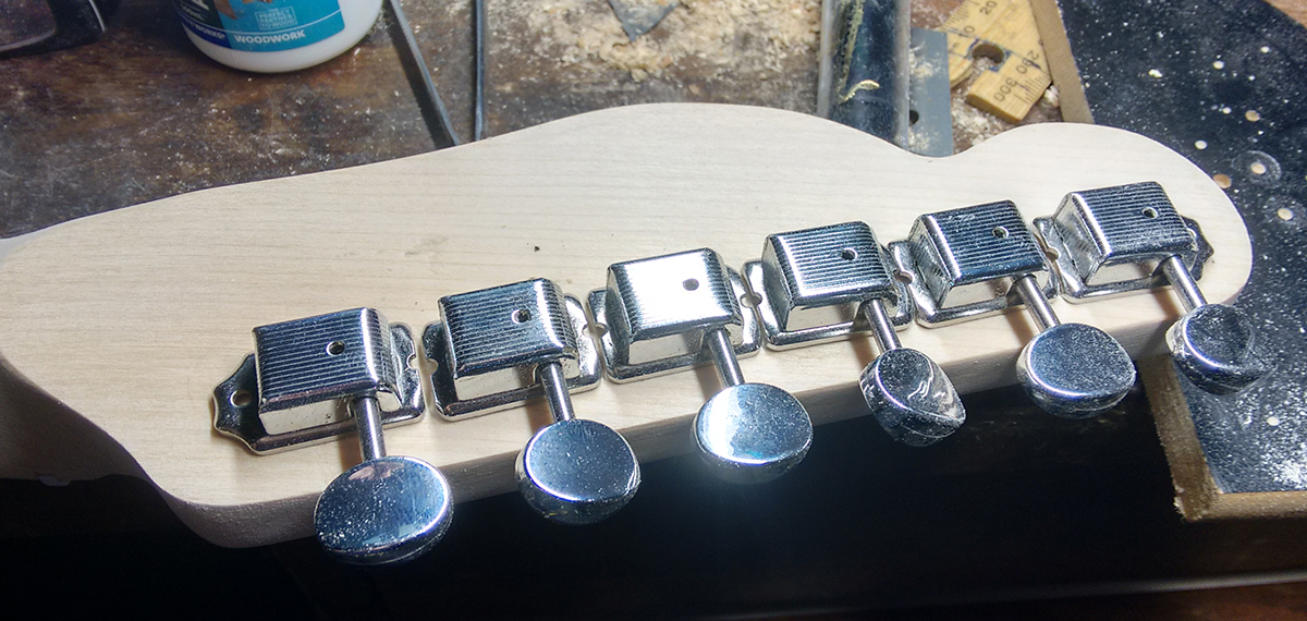

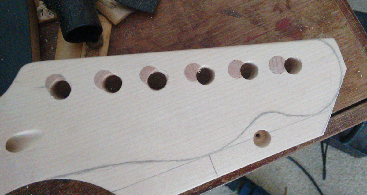

  9. #39
    love the in line tuners, vintage string insert or wind on?
  10. #40

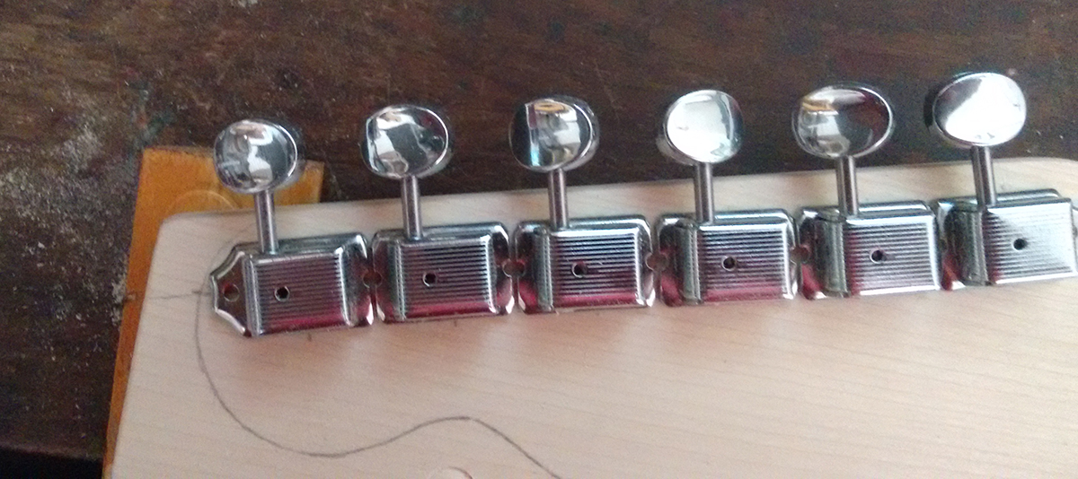

    Doh!!! Just when I was going to drop a feature somebody chimes in
    Andy, I was thinking of just using the 'kit' tuners, however due to your query I gave them another shot.
    Both...you poke the string through and then you wind it on.
Name:	vintage revisit.jpg
    Prior to that I was about to upload today's progressClick image for larger version.
Name:	18 almost.jpg
    cheers, Mark.
    Edit: Well the next step was to fit the tuners, bridge and neck so I could put some strings on to check orientation etc...
    However thanks to Keith's advice about dodgy neck screw holes, I just bunged 'em up with toothpicks, timbermate and aquadhere.
