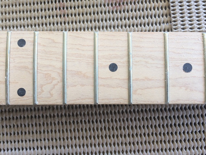

    Next to go were the plastic fret dots. Easy to do, just drill out the old ones.
    I use 6mm MoP dots so the existing holes need to be made ever so slightly larger. The holes are so close to the right size that a sharp 6mm drill bit can be turned in your fingers to just shave of a whisker.

    Before

    I know that some people prefer the black plastic fret dots on a maple fretboard because of the contrast, but it’s become one of my “things” to replace them with Mother of Pearl (or more accurately Abalone or Paua). From a playing standpoint I have either got used to them or they make no difference, not sure.
