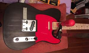

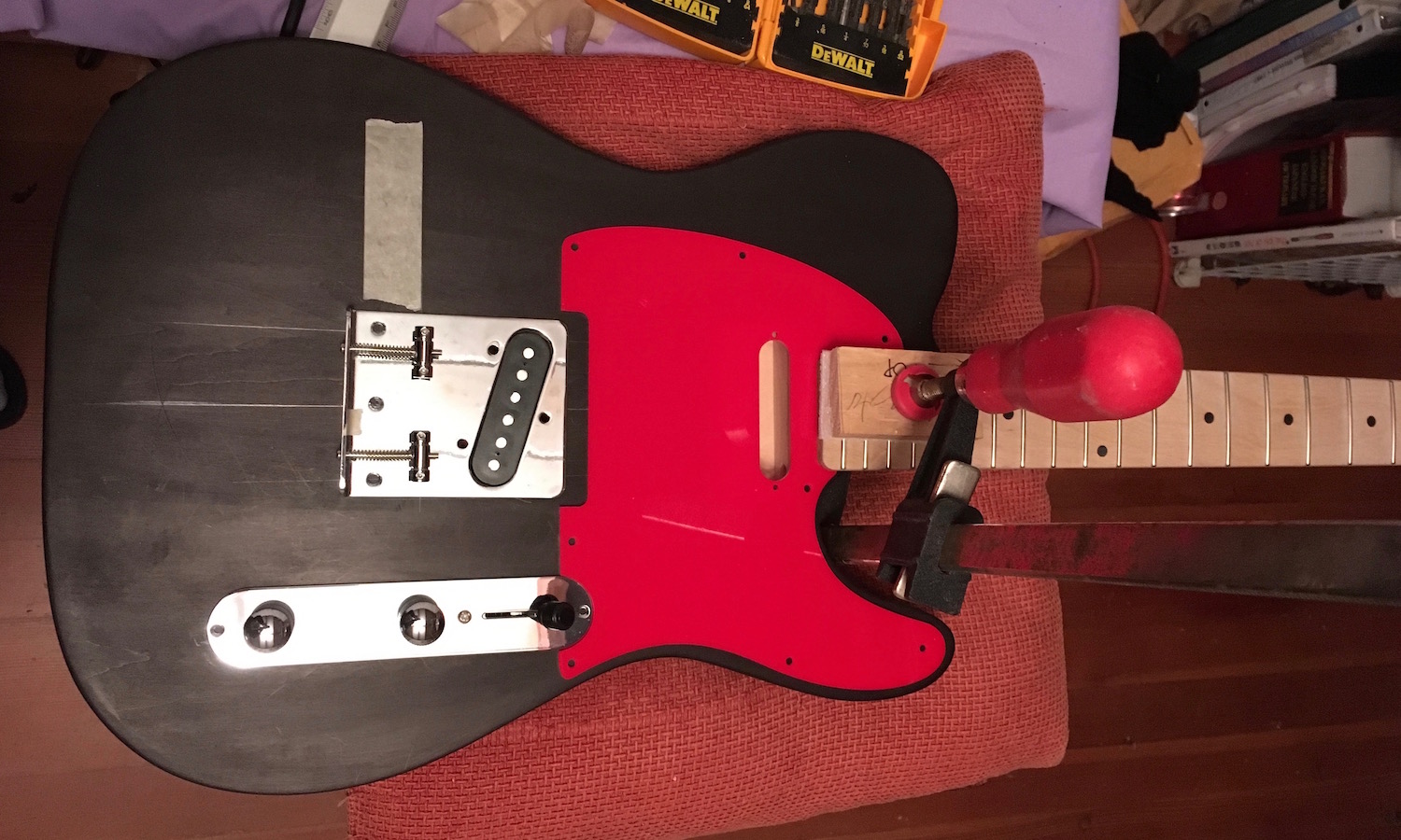

    Ok, so now I think I've got the bridge lined up, but the (after sales) pickguard is now miles away from the bridge (I measure it at 7 millimeters).
    Should I leave that gap, or move the bridge forward and just let the six individual bridge adjuster screws stick out more (If I move the front of the bridge to 2/3mm from the pickguard, then the adjuster screws will stick out from the bridge 9 mm (about a fourth of the screw shaft) even before I begin the intonation process)..?
    Or should I just try to find shorter bridge adjuster screws..?

    All good. I had a similar gap to the Pitbull pick guard.
    This is how mine ended up. I had to enlarge the bridge pick up cavity about an extra 5mm towards the neck to get it here. I had no problems with intonation adjustment. In this pic the top adjustment for the B & E strings is way back so I could see when the spring started to bind. There was no issue with the bridge adjuster screws sitting out too far.
    Once it was together this is where they ended up after adjustment - perfectly normal.
    The scale length is 648mm - so long as that falls roughly halfway up the adjuster screws you are fine.
    If you look here 648mm falls just on the neck side of the adjuster screw halfway point. This leaves loads of adjustment each way for intonation.
