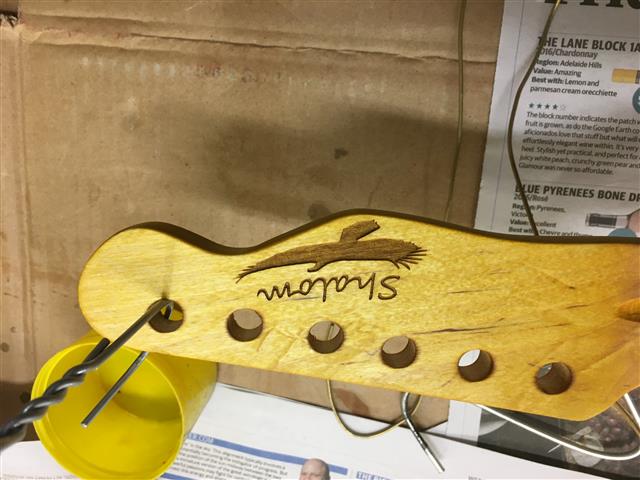

    Experienced builders: Is this what Acacia should look like?
    Dropping by the workshop today to see if the colours faded a little. It is very yellow the first stain...Click image for larger version.

    Nice build! I actually love that neck colour !
    I can't speak for the acacia, but when I applied dingotone Bloodwood on my tele neck, it came out as an orange red at first, and I hated it, and then lightened significantly after a few weeks to the colour i liked. Not sure why, maybe the top coat had an effect? I'd wait a bit and see how it looks.

    Quote Originally Posted by michaelS31 View Post

    Quote Originally Posted by Old Tooth Hopkins View Post
    Could you link me to your build diary for the blood wood neck so I can have a look at how it fades?
    Sure Old tooth! Here you go - let me know if there are any issues

  7. #37
    Checked the first coat today, and stained a second coat to get more evenness.
    But i realised a problem which I need to consult an experienced builder.

  8. #38
    That gap looks pretty normal for an unmatched neck and the fretboard sits up like that on my tele as well. It all seems to work fine though
    Looking at the bridge and pickup adjustment on mine, you could probably get away with taking a few mm off the heel to get it to sit down further. I'd just be very careful as you don't want to introduce any unwanted neck angles. Also looking at the PU surround, you want to make sure the strings clear that. I have a much flatter metal one on mine.
    If the gap between the heel and the body is really bothering you I would probably fill the neck pocket to take up the gap rather than modify the neck. It might work to use some putty of some kind and then put glad wrap over the neck heel and push it in to form the shape properly.
    I also haven't used dingo tone either, but it might help to hang it up in the sun and get some UV on it to help it fade a bit.
  9. #39
    Thanks Sonic - much appreciated.
    I'll use a mock build photo to play around with different designs. May do a custom pickguard.
    I'm reasonably happy with the dingotone so far, just wasn't sure if it's my unevenness in applying or the grain of the wood.
    I do realise the end grain near the top of the headstock absorbs the stain like no tomorrow and thus a lot darker. Hence the second coat to try to even it up.
    and nooooooo I will not dare try to shave the neck thinner! I'd be a can of worms.
