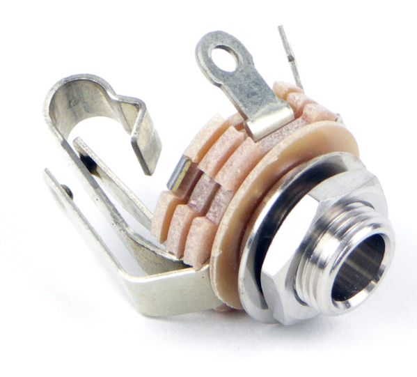

    Your diagram has the correct idea but unfortunately won't work. As you have both outputs from the switch joined at the mono jack then they'll also be permanently linked for both channels of the stereo jack. What you need is to either separate the two signals/outputs whenever a stereo plug is inserted, whcih requires a 'switched' stereo jack. Or, connect the two signals when a mono plug is inserted (which is how Rics do it), which requires a 'switched' mono jack.
    Stereo switching requires a standard mono jack and something like the normally closed Switchcraft 14B stereo jack (there are other types):
    Essentially one output from the switch goes to both the switching lug & ring lug on the stereo jack and then to the tip of the mono jack. The other output from the switch goes to the tip lug on the stereo jack. When there's no plug in the stereo jack the tip shorts with the switching lug and thus connects your two outputs for the mono jack, but when a stereo plug is inserted the two outputs are separated as two channels.
    Mono switching requires a standard stereo jack and something like the normally open Switchcraft 13A (I think) mono jack:
    The switch outputs would go to the tip and ring lugs on the stereo jack and then to the tip and switching lug on the switched mono jack. Whenever a plug is inserted in the mono jack the switching lug gets connected and the two outputs are linked for mono output.
  2. #32
    Dec 2017
    New Mills, High Peak, UK
    99
    Scott, Thank you very much.
    I had to read that a few times but now I understand!
    As I have a standard stereo jack I will get the switching mono type.
    I would never have worked this out without your help so thanks again :-)

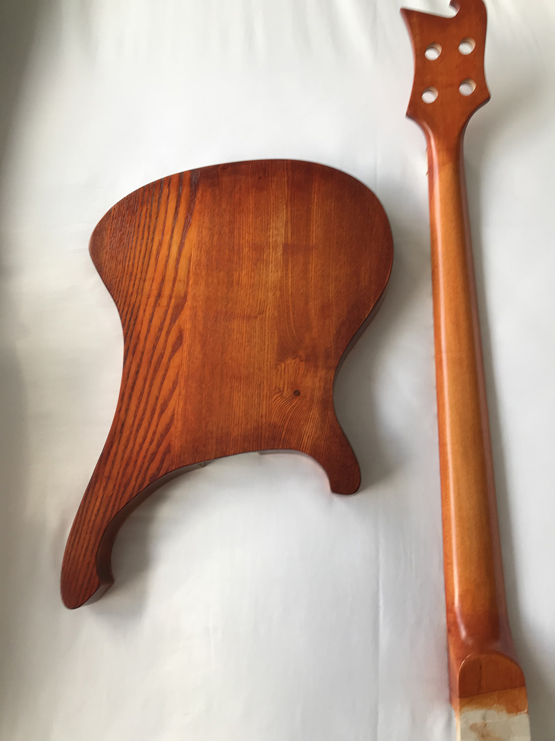

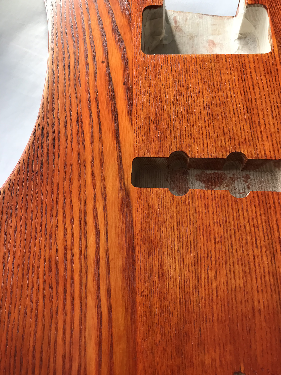

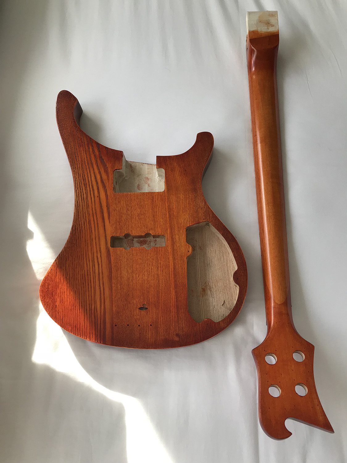

    Progress update -
    I have done 3 deep colour coats and 3 base coats.
    It is fair to say the burst idea didn't work. I think I chose two colours too close to each other so when trying to blend I just mixed the two into one halfway shade.
    There are a few uneven patches where I think I have sanded too much or more likely not enough but I'll live with that as I think it keeps some of the natural vibe of the wood.
    I am really pleased with the neck as I know the maple doesn't take the stain too well but it has come up really silky with almost a glow to it in the right light.
    So a couple of days to cure then clear coat on the body but I'm going to leave the neck as it is

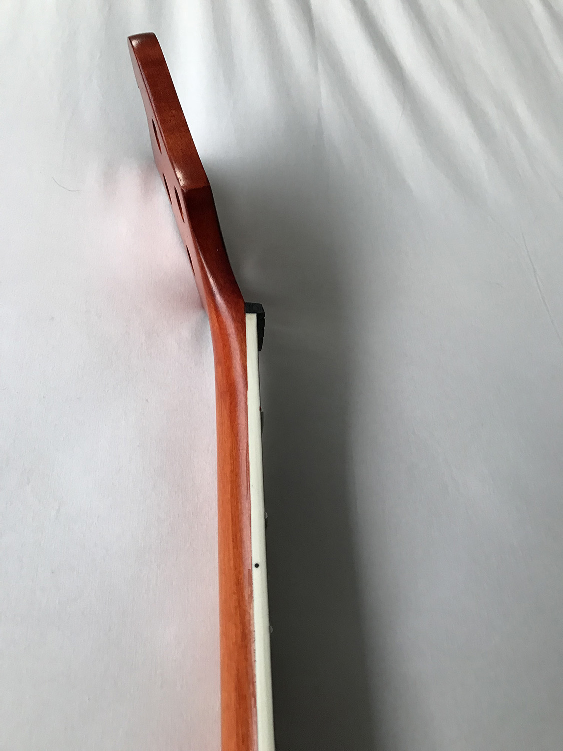

  10. #40
    Dec 2017
    99
    Thanks for the positive comments guys.
    I 'unmasked' the fretboard and found that the binding was mostly clean with just a bit of scraping to do in a couple of area.
