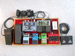

    Update:
    Thought that it was time to post an update, so here we go.....
    Okay, I've recently been doing some revising of my pedal-board setup, mainly to downsize it a bit so that it's simple enough even for me to get up and running....haha.
    Here's a pic of what my current pedal board setup looks like:
Name:	Current Pedal Board Setup_resized.jpg
    I'm actually using a pedal board case that Recently bought from my local Pro Music shop, it has a kind of 50's Fender Tweed covering on it that I think looks cool.
    So, here's a brief synopsis of my pedal board and how I've got my signal-chain set up:
    Going into my Marshall MA100C's input:
    Guitar into my Pitchblack + Tuner, then into the Ibanez TS-9 Tube Screamer, then into my Boss BD-2 Blues Driver, then into my Jim Dunlop Jimi Hendrix Wah, and then finally into my Marshall amp.
    Marshall Amp FX Loop:
    From the FX Loop Send it goes into the input of my Boss RE 20 Space Echo pedal, then into my DIY Univibe, then into my Boss CH-1 Super Chorus, and then finally to the FX Loop Return on the Marshall amp.

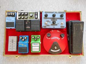

    Since I'm using a clip-on Snark tuner, I decided to eliminate the pitchblack tuner from the pedalboard, the Fuzz Face doesn't really like being driven by a buffer, which the pitchblack has in it's output, it's also supposed to be very picky on what comes after it too, I'm still making the Jimi Hendrix Wah the last pedal in the chain before going into the Marshall amp though.
    I might change-up the order of the pedals going in the Marshall's FX loop too, but I first need to sort-out a hum issue in my Univibe pedal.
