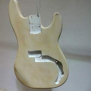

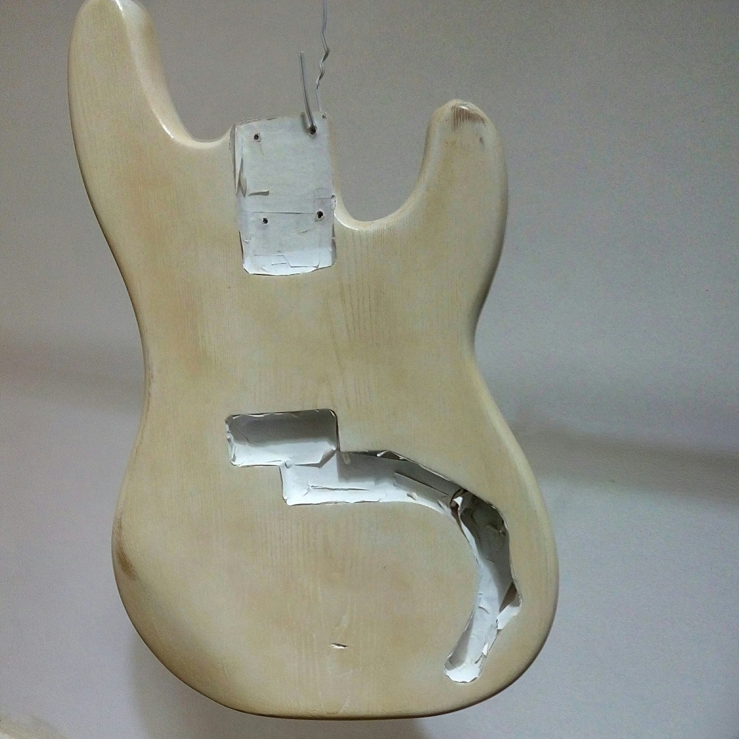

  9. #39
    After applying the shellac , the color received is kinda old, relic like (because I sanded some of the primer below off and you can see the wood ), Now I'm not sure if I want to paint it with the ultra marine blue or just apply the clear coat on top of the shellac to keep this color.
    Tough decision
  10. #40
    It kinda reminds me of old farmhouse furniture. I like it, it will be interesting to see as a mock build, check out what the jewellery does to it.
