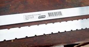

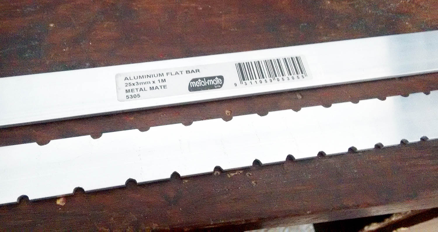

  6. #36
    I got a 1 metre bar of aluminium from the BGS. Cut it in half and notched one side for ST,TL fretboard and the other for an Epiphone.
Name:	Fret Level.jpg
    I've got the other half spare for another guitar perhaps.
    cheers, Mark.
