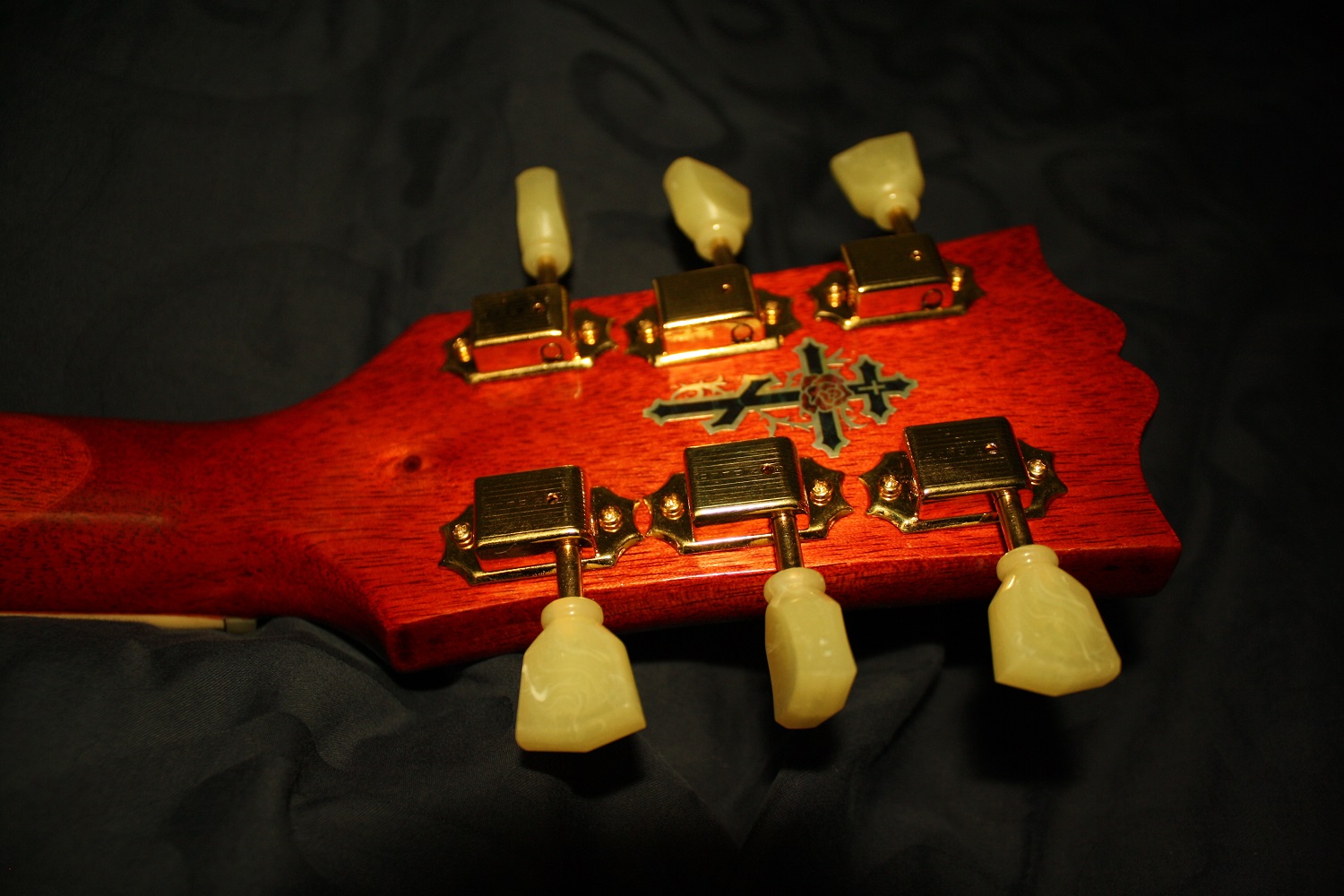

  10. #40
    Quote Originally Posted by churchie View Post
    Yeah I think I might go the Klusons with the adapter bushings
    I was considering the 3-on-a-plate style, but I didn't want to deal with the holes not quite lining up etc
    Hey Churchie, yeah the wonky tuner holes are on all LP style kits. if you are going to paint the headstock black, just stick a bit of doweling in there and re-drill. If you aren't going to pain the head stock just put a veneer on the head stock to cover the doweling.
    Or if you are lazy like me, I just used thee a side Klusons not on a plate.
