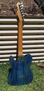

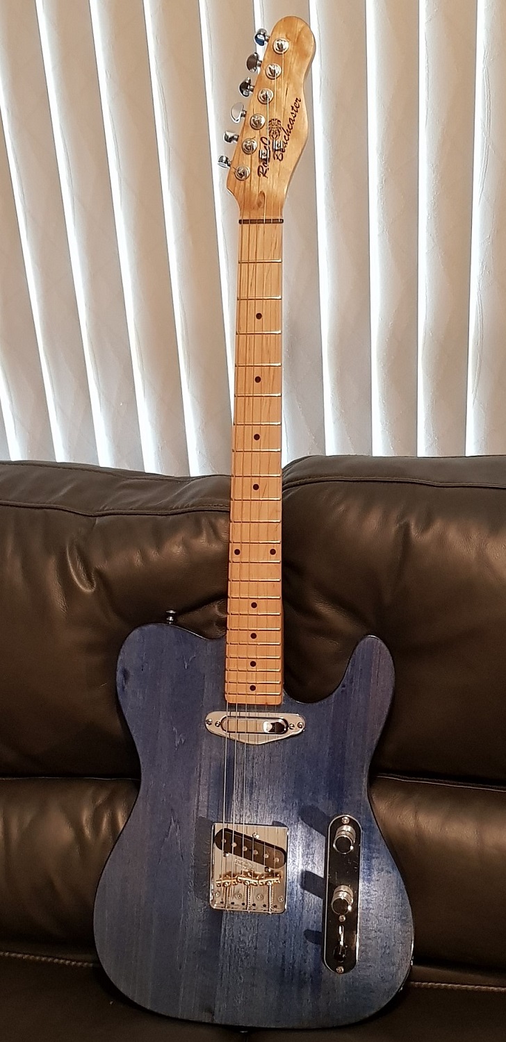

    All buttoned up and working. A bit of a hum that disappears as soon as I touch anything metallic, a dodgy earth somewhere probably. So, sometime, not now, I'm a little bit over this one right at present and I've got the ES12G calling me, I'll rip it down and track down the cause.

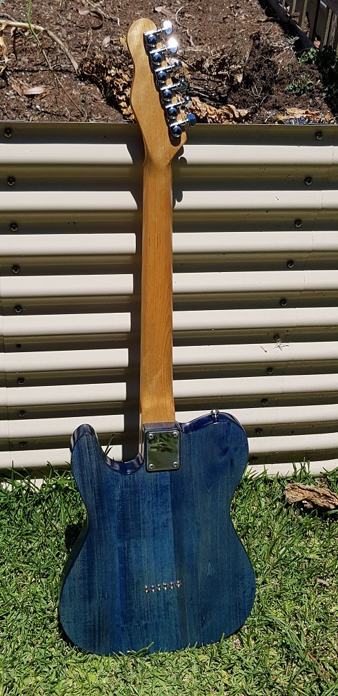

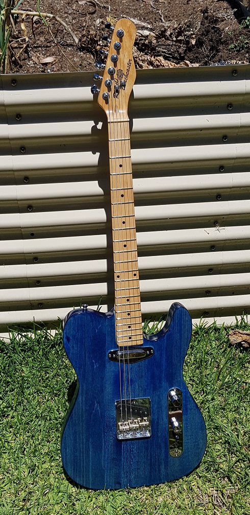

    Finished Finished this time, solved the dead B string issue. I took the bone nut out and replaced it with an allparts graphite one I had in my ever growing box of bits, all good. So as Simon mentioned there was something wrong with the nut slot. Thanks Simon.
    Intonation is also done, as close as I can get it. With the wilkinson bridge, to get it to line up with the "through body" holes and be able to get the scale length right I had to find some longer saddle screws to allow them to move forward far enough.
    I'll wait till the sun shines get some outside pics show of the shine for the GOTM thread.

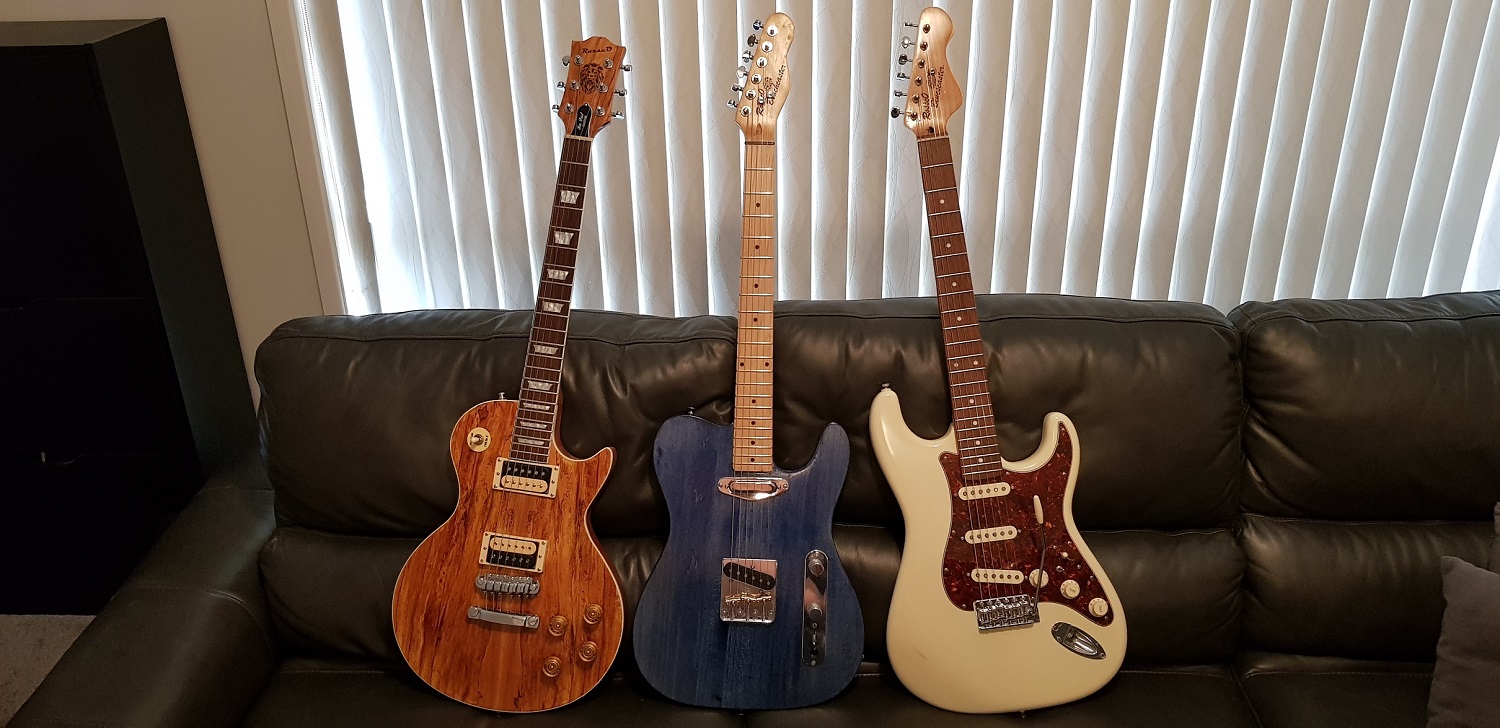

    Introducing it to the rest of the PB family.
