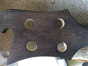

    Trying first extra gloss top coat on back. Logic is that if I put a coat or 2 of finish on then when I glue the neck on it is hopefully easier to clean up. Once the neck is on then a couple more coats, leave it for a month and then buff up.
    So the pics are with the newly applied extra gloss top coat on the back of the body (weird affect of light on the rhs) and the neck after its first coat of Dark Onyx.

  10. #40
    Mentor Kick's Avatar
    Feb 2017
    Amsterdam, The Netherlands
    823
    I love that headstock shape! Really cool man!
