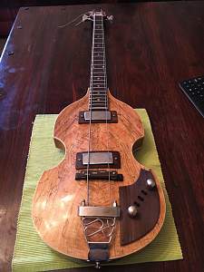

So I first spent days staring at the thing eventually getting a plan.

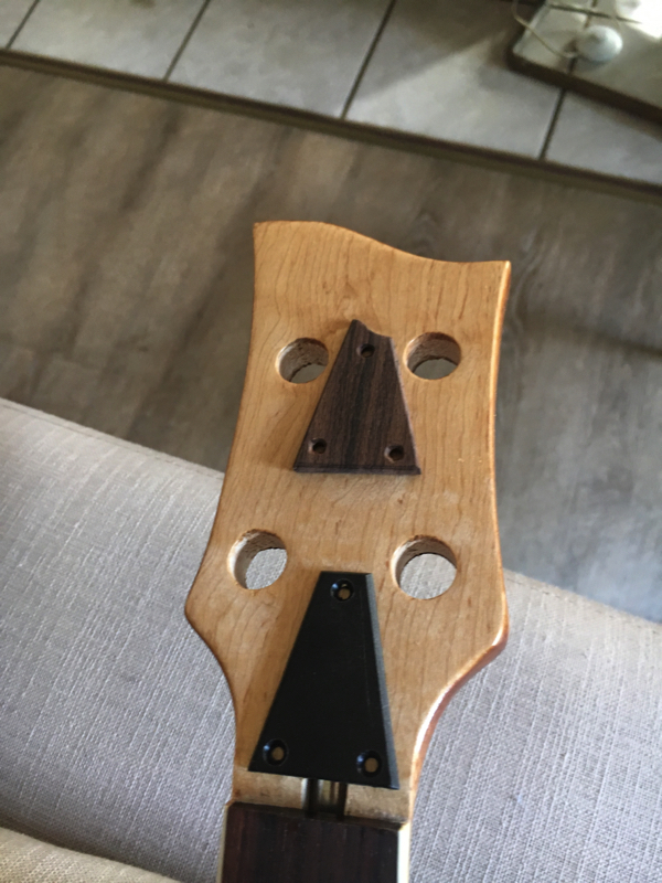

I am thinking the following:
Replace all the plastic bits with wood and metal ones (PU surrounds, control strip, truss rod cover), and replace the nut. I may upgrade the hardware later but not too keen to go over the top here as it is the first build after all.
I plan to finish with Tru oil, but also would like to apply a hint of darker wood stain.

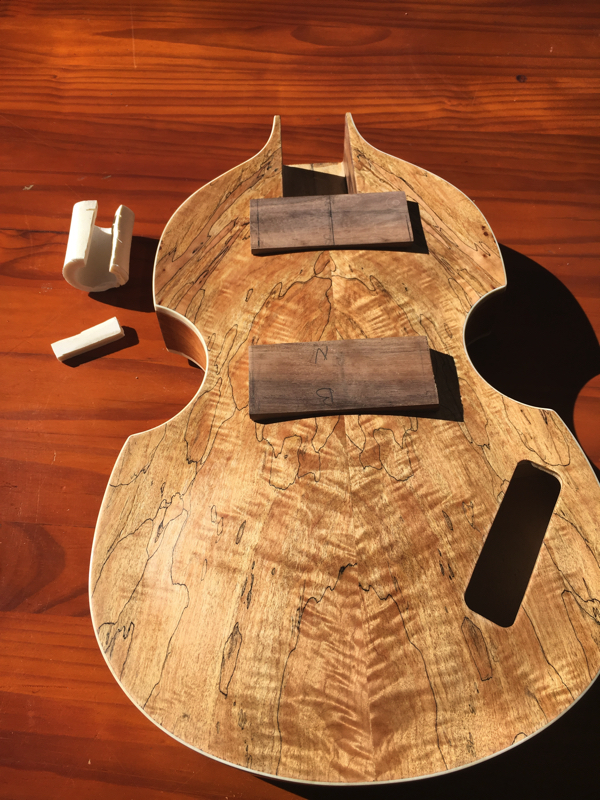

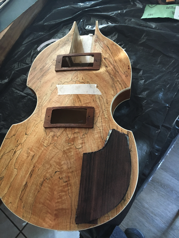

1. Getting to the mock build was challenging. I had difficulty in getting the centre line established as the veneer is off centre (to the body measurement) and the neck pocket appeared off centre to the body as the thickness of the wood either side to the neck pocket is not even. Then I got serious and used a ruler. It got easier from there.
2. The neck pocket was too small as apposed to the neck heel too large
Examined the neck heel and sanded it level on both sides to line up with the binding making sure I kept the line with the widening as it goes down the neck. Tackled the neck pocket and then over sanded. – ha! (Didn’t check the depth of the neck into the body). Saw this when I finally did the mock build. Now glued veneer to one side of the neck pocket and will re sand refit, and recheck.
I am happy with the neck angle though, enough movement in the saddle to adjust to optimum string height. Will have to recheck the alignment will pup cavities.
