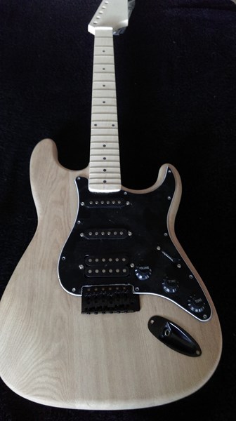

    356
    Love it...
Name:	IMAG1095 [Guitar].jpg

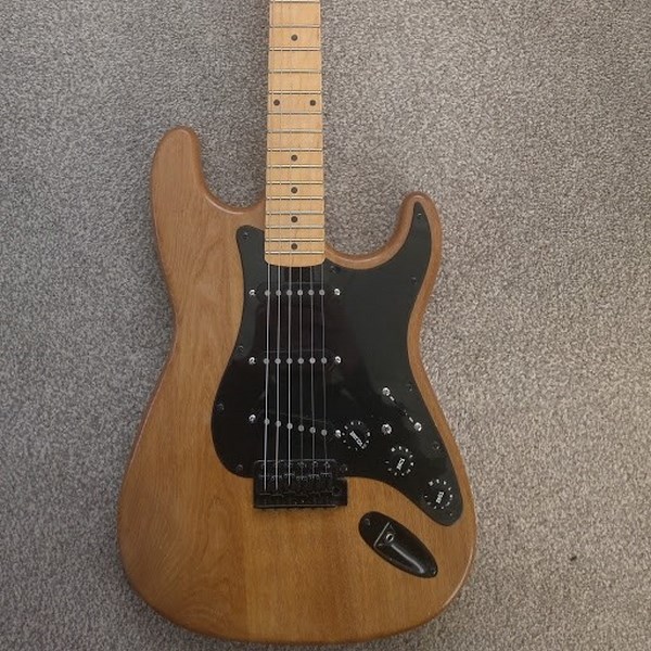

    oh that looks light.... I'll upload a better pic

    A better one...

  8. #38
    Mentor Kick's Avatar
    Feb 2017
    Amsterdam, The Netherlands
    823
    Simply stunning!
