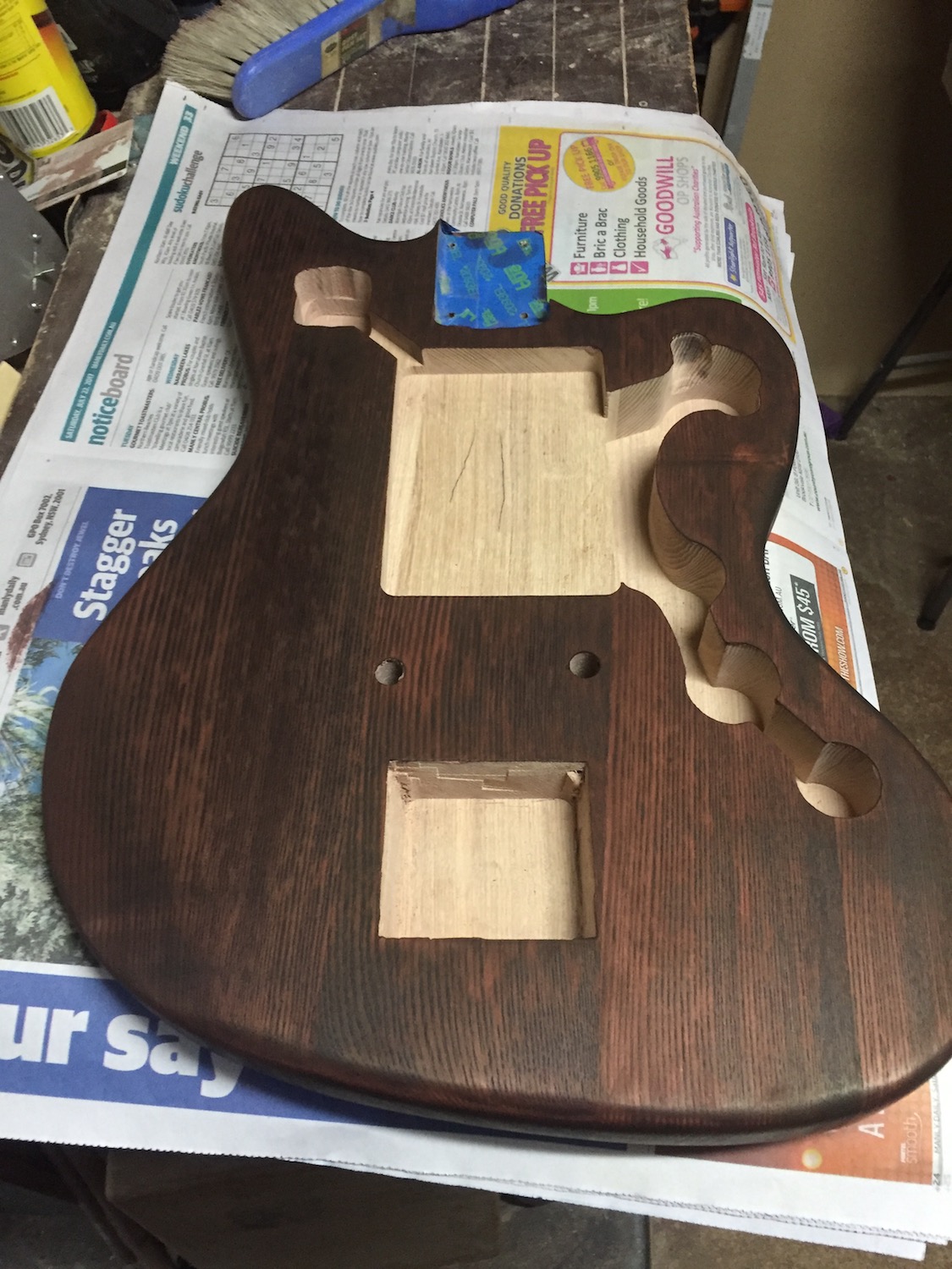

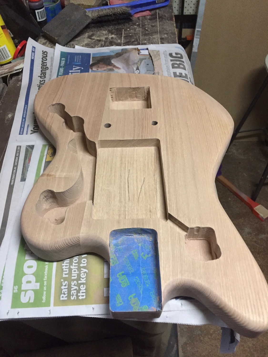

    Okay, we’re back on track. The replacement kit arrived, and there were still some issues with the neck pocket. Adam is now working with the factory on this front, but rather than wait for it to be resolved I’m forging ahead. I figure I should be able to get a result with some very careful reshaping of the neck heel (thanks to some valuable advice from Wok, Dedman and Ponch). In the meantime here’s the latest.
    First step was to complete a new top rout for the toggle switch; elongating the existing toggle switch rout so I can put a 5-way switch in there; and expanding the trem rout – it needed about 2-3mm taken off each side and the same on the back edge. While the two routs are just about acceptable, the trem cavity is a bit rough after I went at it with a chisel (thankfully all will be hidden under the pickguard). A good couple of sanding sessions, starting at 80 and working my way up to 240 grit had this result.
Name:	240117 Final sand.JPG

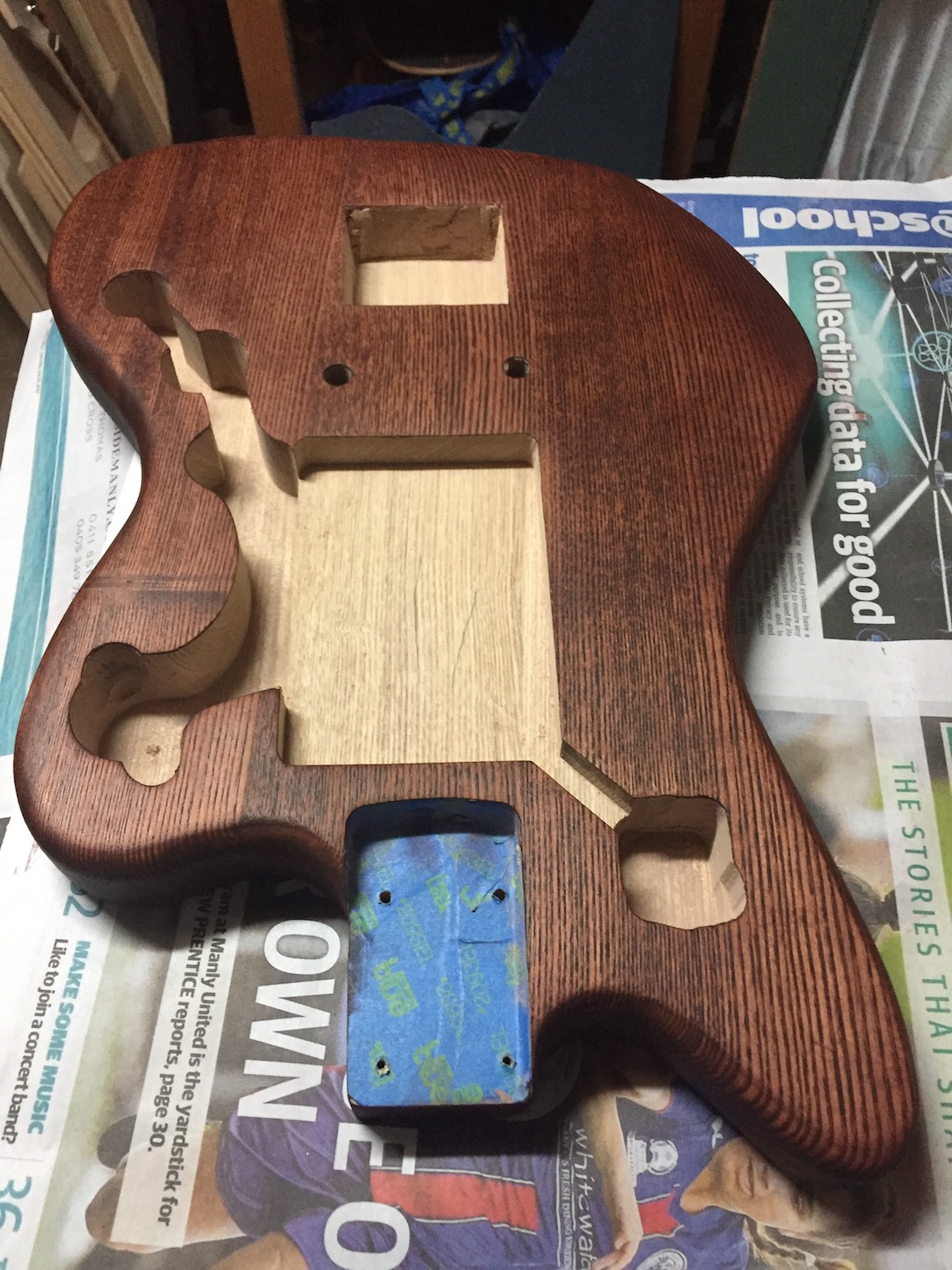

    Next I went with walnut timbermate. I did try the ebony version on a scrap but felt the walnut would look better for what I had in mind. After that was dry I went at it again with 240 and did the first coat of stain.
Name:	240717 First stain.JPG
    After 24 hours I actually sanded back with 240 as there were a couple of areas I didn’t go hard enough at the first time. Then I went to 320 grit and then stained again.
Name:	250717 Second stain.JPG
    I’m pretty happy with this, although I may do a third light stain. It’s almost the colour I’m after so I’ll let this one dry for a couple of days and reassess.

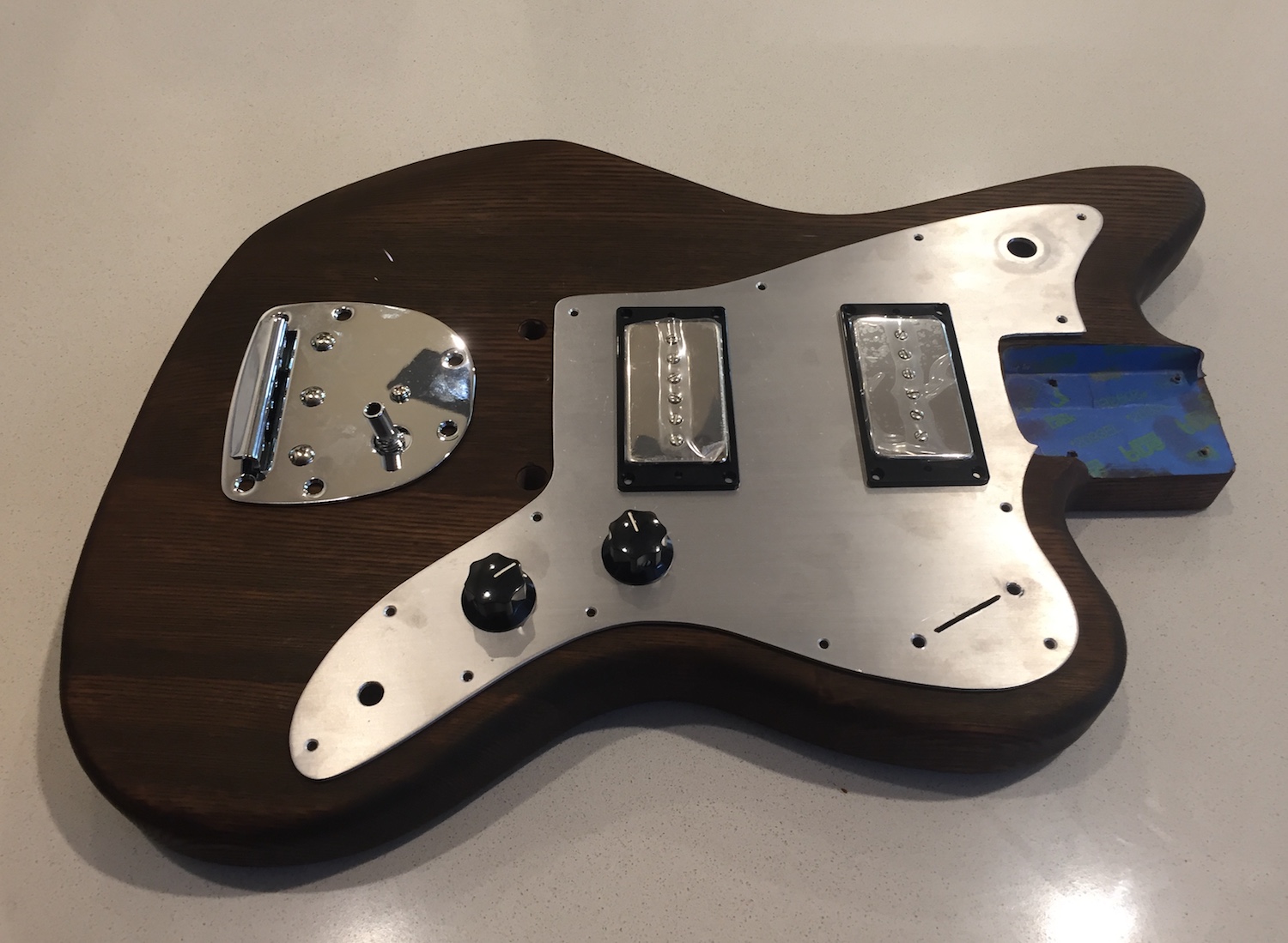

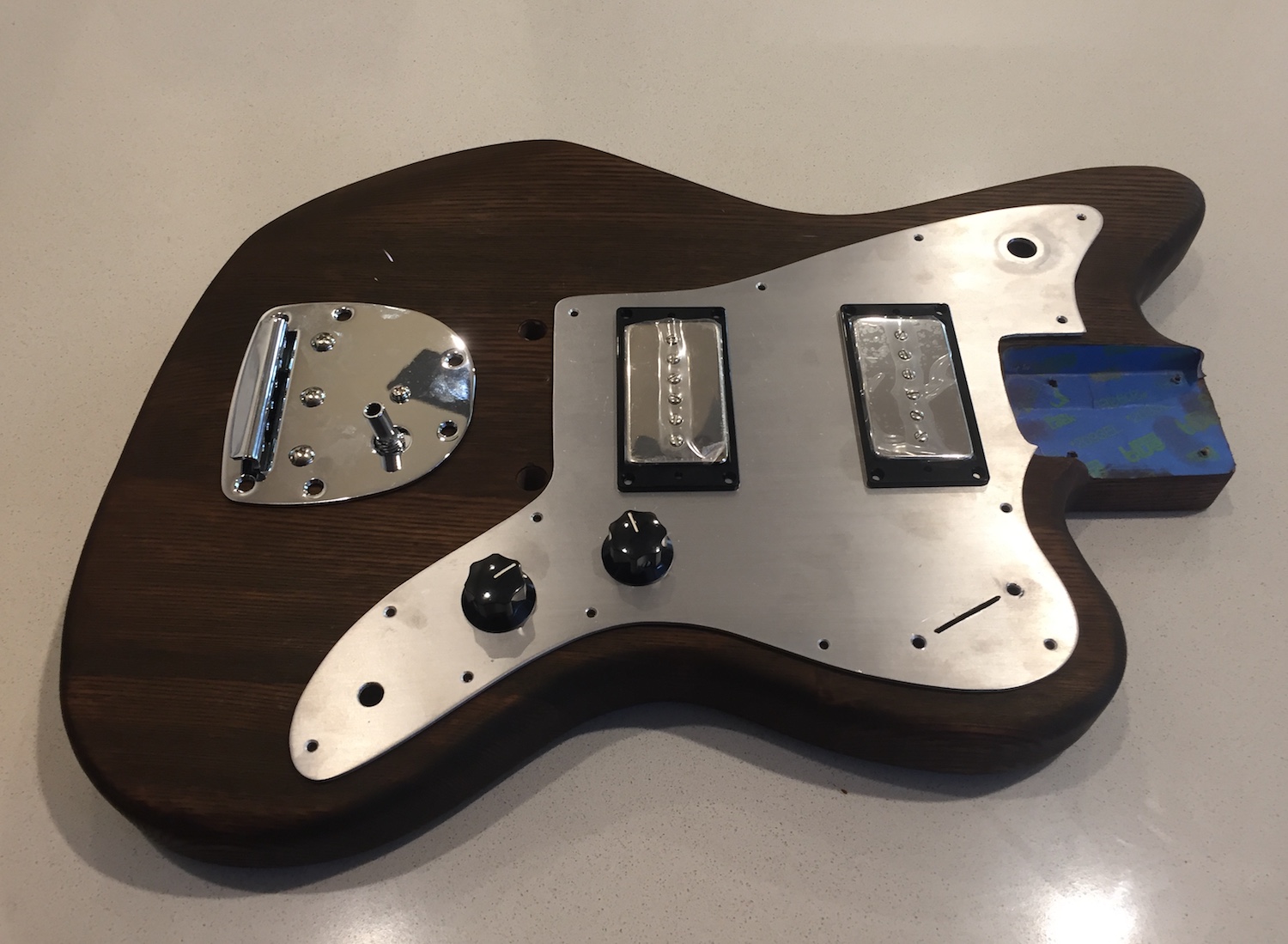

    And I couldn't resist a quick mockup...
Name:	250717 mockup.JPG
    It'll have black tips on the toggle, 5-way and trem arm too. The knobs are potentially a little large as they are from a bass rather than the Mustang style (which might mean another order from Realparts!). Lots of fine tuning to come...
