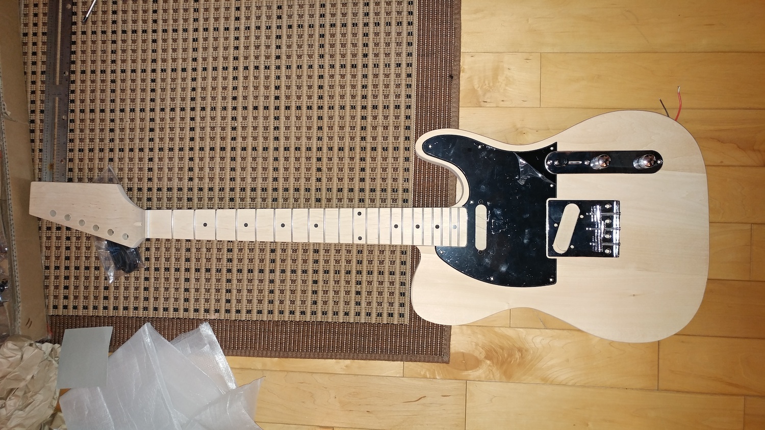

    Ajax, ontario
    28
    thanks for the input Simon - much appreciated! This is the mock up - I'm kind digging this colour too. More sanding, then I'll start the route.Click image for larger version.
  6. #36
    As Weirdy said the scale length is most important bit to get right. Once that has been established you will know if the Bridge PUP rout needs work.
  7. #37
    Ajax, ontario
    28
    so here's the route doneClick image for larger version.
Name:	with route.jpg
ID:	20799 - not as difficult as I imagined. P/U's are fitting nicely now. As far as scale length.....I've measured from the nut to 12th fret = 12 11/16 inches, so measured the same from the 12th to the saddle - lots of play in the saddles, so just wanted to make sure I'm on the right track. I know the scale length of a tele is 25.5, and 2 x 12 11/16 is a bit longer, but this should be fine, right?
  8. #38
    2,817
    Should be good Ian.
    FWIW I normally set the bridge position with the high E saddle about 80% fully extended and on a F type guitar the saddles move further back from there so the E6 is around 6mm closer to the back than the E1 so you have plenty to work with
  9. #39
    A Dave, said the top E saddle will be the one furthest forward, so if you set the top E saddle to around 80% (or say with 5mm of thread still showing), and measure from the top E nut slot (board side) to the top E saddle with double the nut to 12th fret distance, you should be fine for position and saddle adjustment. It's then just a question of getting the middle of the bridge on the neck centre line.
  10. #40

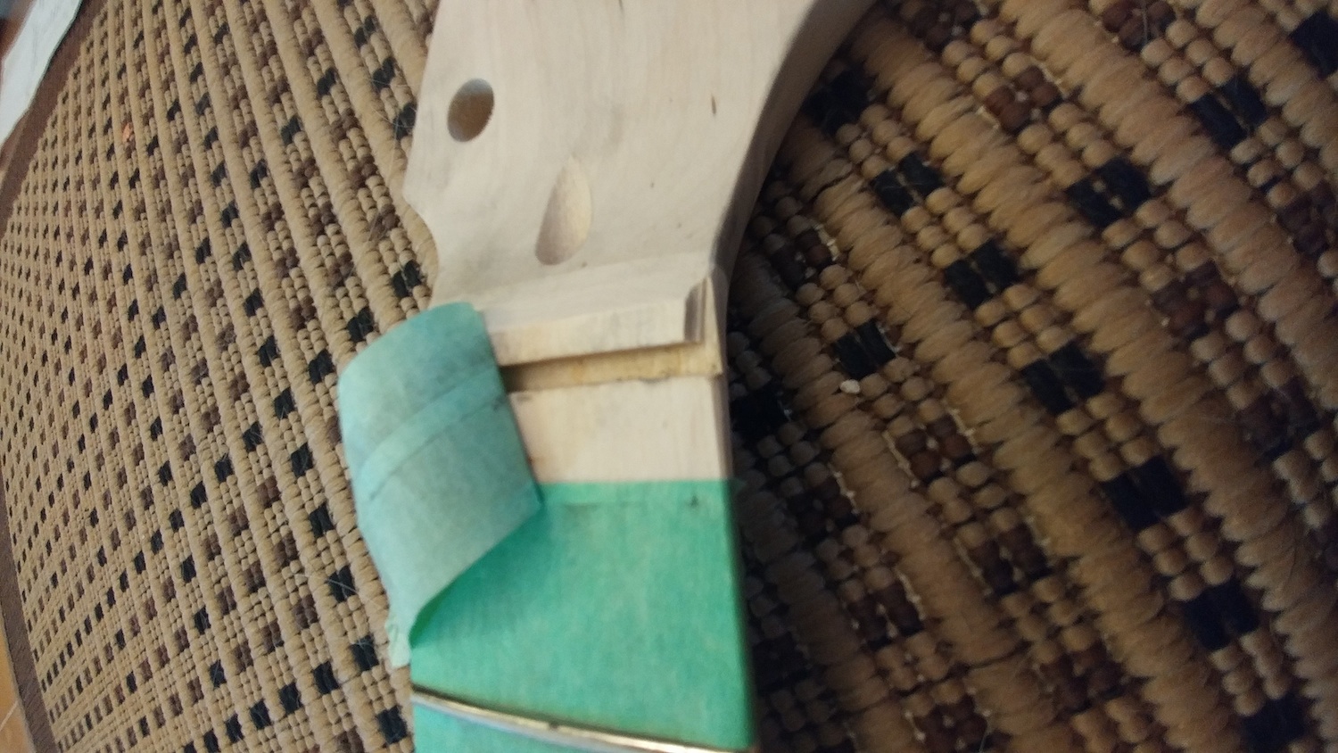

    Ajax, ontario
    28
    so I did this last night.Click image for larger version.
    Should I worry about it?
