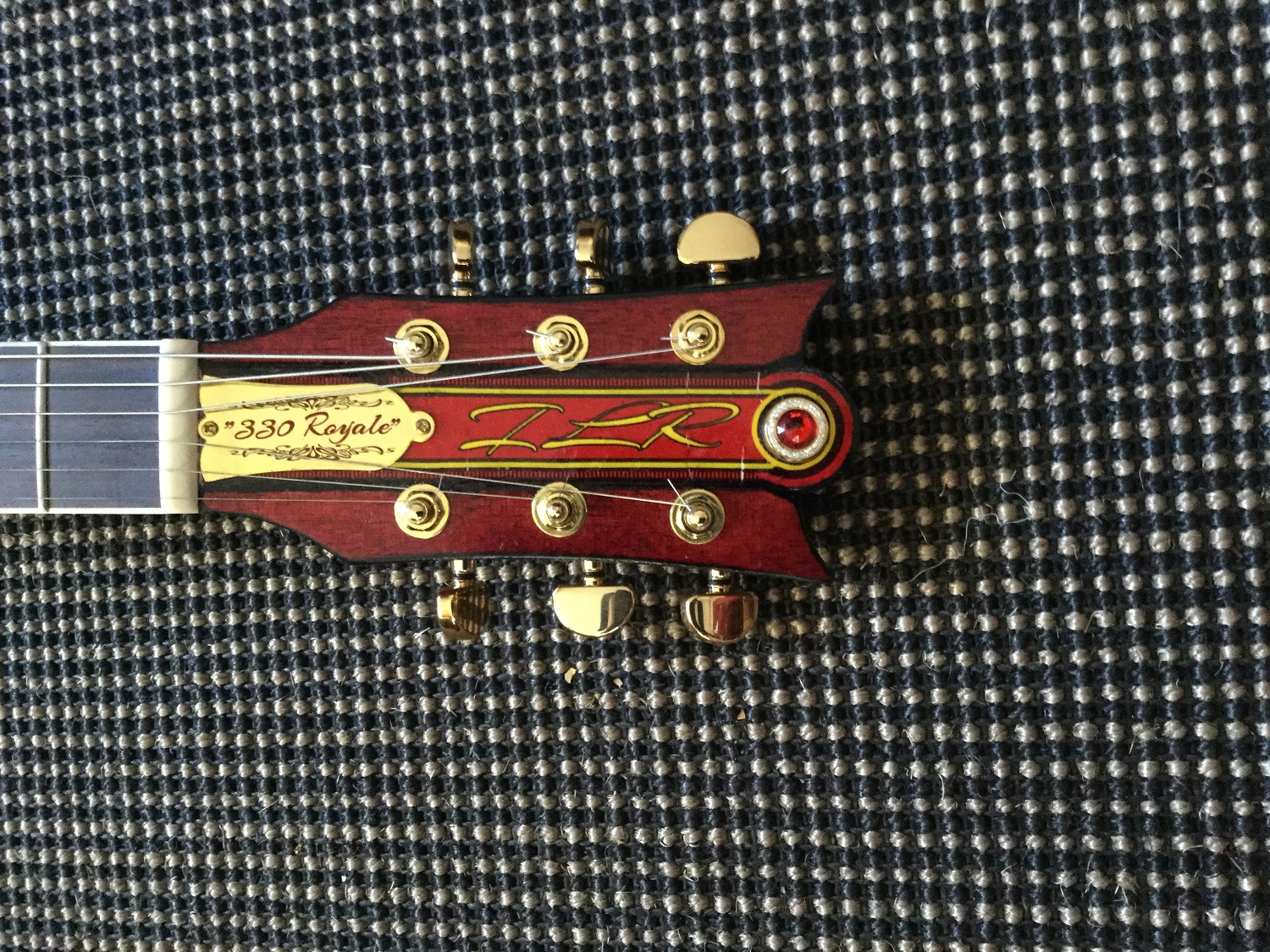

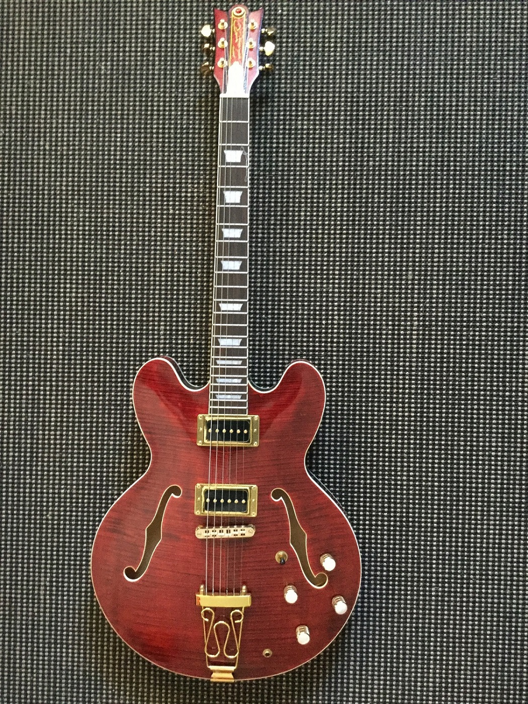

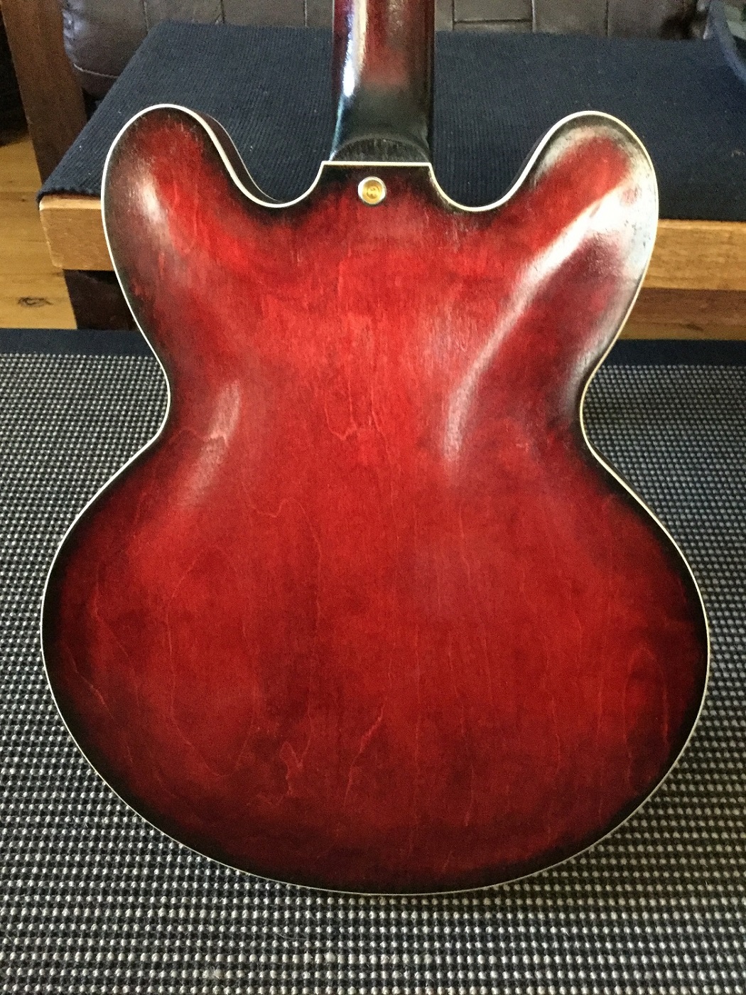

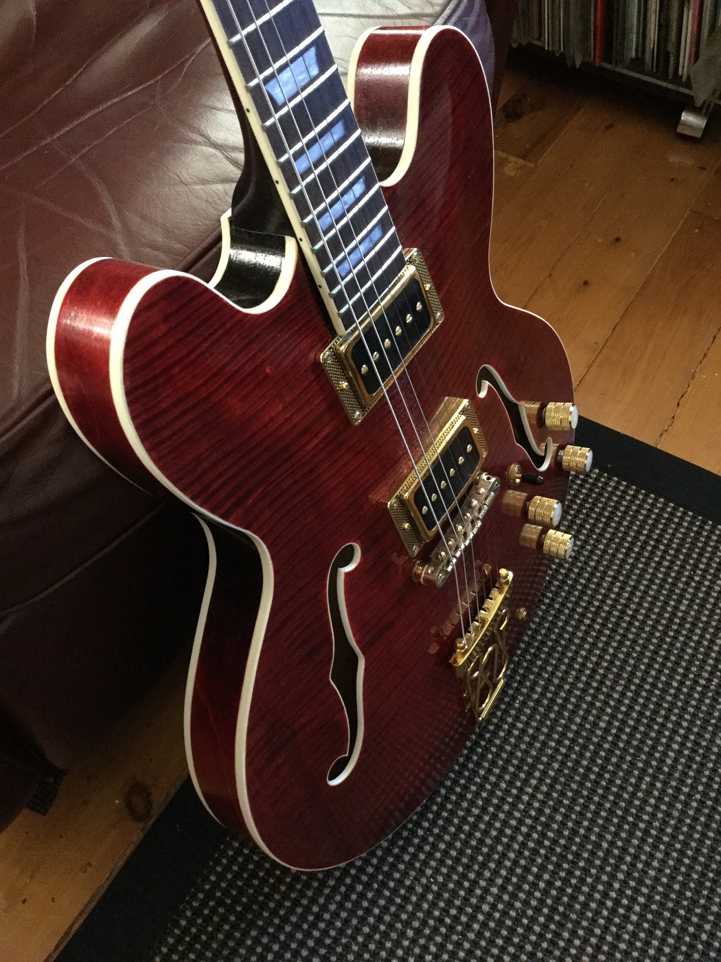

    Apologies first:
    1. Sorry for being so lazy with this build diary,
    2. Sorry for the lack of pictures (had some camera problems)
    3. Sorry for the quality of the following pics...but I hope you enjoy.
    4. Sorry for the headstock errors but it's not so noticeable in real life.

    Details:
    Colour: Mix of Red,Blue and Yellow Ink and water.
    Finish: Tru-Oil, sanded back and finished with Micro Mesh pads, Brasso and Furniture Polish
    Pickups: Humbucker sized P90's ( Chinese but sound quite good )
    Wiring: Individual Volume and Tone Controls. Will need to replace the pots late as I'm not happy with the stock ones.
    Bridge: Tone-Pro Tune-O-Matic replacement.
    Tuners: Locking KD Rising Star.
    String: Ernie Ball 10-42
    All in all, I'm pretty happy with the finish and the tone. Not a lot of adjustment needed thankfully. I just have to get used to playing her now. I'm calling her "Rosie".
  10. Liked by: Guvna19
    So cool!
    Shame about the small goof in the headstock - otherwise that looks freakin awesome. Great overall character.
