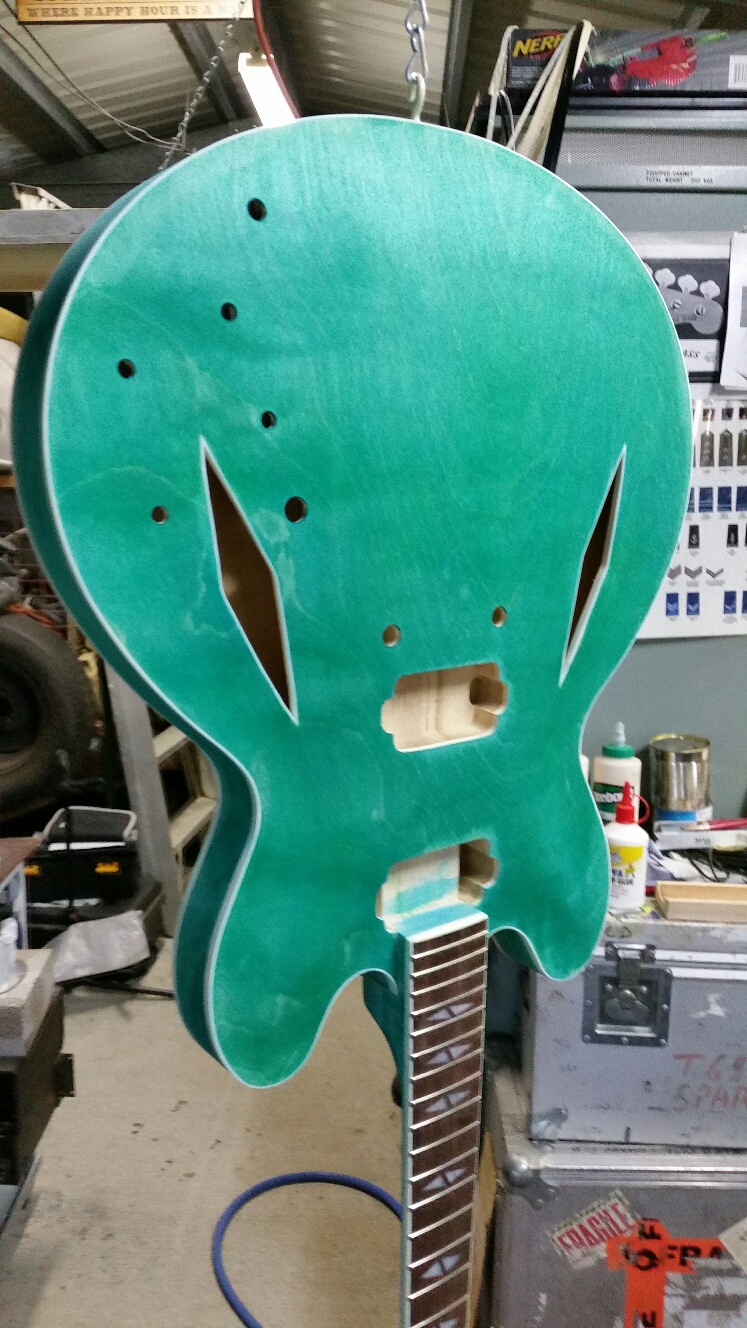

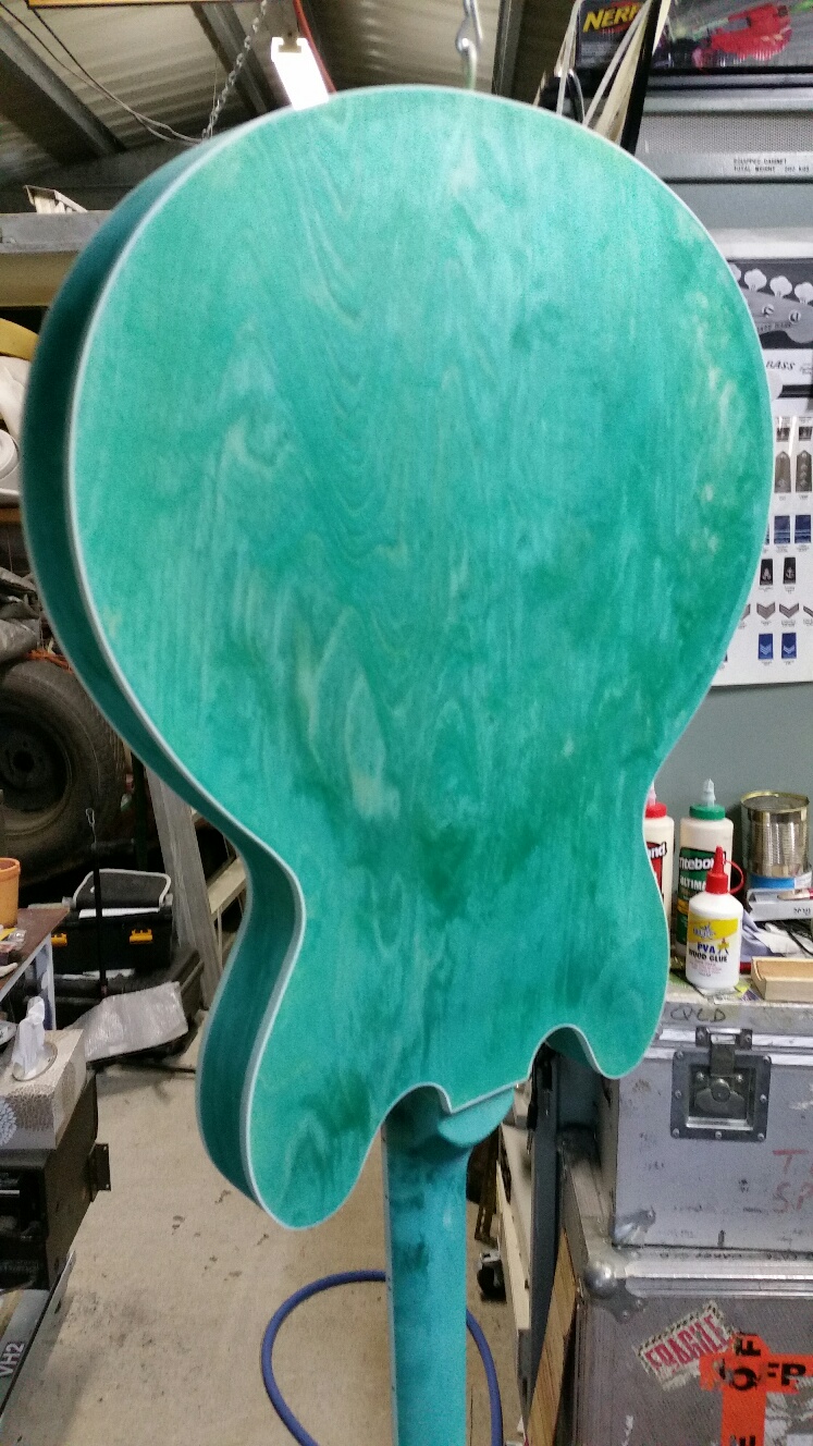

    Not quite the colour I wanted, but it's getting close... another few layers of Blue should see it closer to where I want ...
    As I was finishing applying the colour I had the thought that maybe I should have started with the medium Blue under the Green instead of light Green under the Blue... You live and learn...

    Marcel the colour looks good. It's common to not get the colour you wanted but sure it will grow on you. It should darken a bit with clear coats

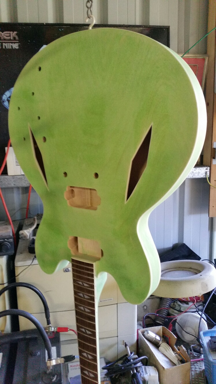

    I'm still of two minds on that Wokka.... Do I change and go the TruOil path, or stick with my original Shellac idea. I know that TruOil will keep the colour as is, and the Shellac could add a slight Yellow tint which may bring out the Green more and give better depth.
    The two darker photos were taken while it was still wet so they're fairly representative on how it will turn out... Either way I'd still prefer it to be a bit more Blue. Used a water based Analine dye from U-Beaut that is designed to go under Shellac... The pale Green undercoat colour was photographed earlier and once it had dried.

    Sorry to hear about the troubles with the neck Marcel! Colour looks good though
    Luv the colour marcel

    Some wicked Grain patterns showing through on that back. Will interesting to see what the extra blue coats do to the eventual finished shade. Maybe an emerald sort of green?

    I think the grain you're seeing there FW is more the patchy drying of the stain... There is grain to be seen, but sadly there is not much of it...and in some unexpected places it's not taking the stain very well (or too well)... which I'll simply just call 'character'....lol
    The first clear (Shellac) coat will reveal the truth...

    Another coat of a stronger mix of the Blue and the colour hasn't changed much, so with mixed emotions I think it is going to be what it is....
    Funny thing was my applicator rag when I first started was Blue, but by the end was the same colour as the build. Seems I am pulling out some of the light Green as I go but not enough to be of any significance.
